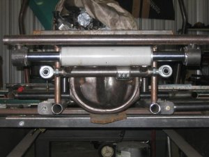

So here's the ram setup...
Why not just attach the ram normally with clevises on the ends?...doing that would transfer wierd things into the steering geometry...the biggest problem being almost 2" of bump steer at full stuff/droop...

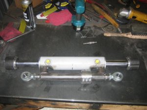

So what's to keep that ram body from spinning on the shaft?...This, that's what.
Got a tube clamp from Polyperformance and a small stick of oily bronze from McMaster...the outer lips keep the bronze where it's supposed to be...
And this is the setup...
The 'draglink' slides on the bushing setup and keeps the ram from trying to rotate.

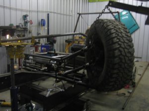

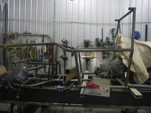

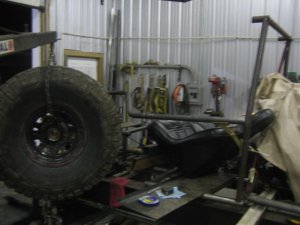

Some mock up shots from tonight...full stuff...turned in about 55 degrees...(no, it won't turn that much)
And how I left tonight...my bender arms are tweaked...and they keep tweaking more and more...sorta makes it difficult to get a straight plane bend...oh well...nothing a little ratchet straping won't fix so far...
