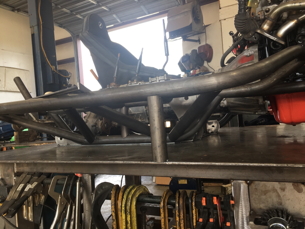

My main table is 5' x 9'. The top is p&o 3/8 plate. I used 4x4x.25 square tube for the legs and 3x3x3/16 for the frame between the legs down low and up against the bottom of the top.
Important things to consider... leave enough of an exposed lip around the perimeter so that your deepest C clamp can clamp something down. But don't go too long so the edge is weak if you sit something heavy on it.
If you put a perimeter frame between the legs down low, make sure it's high enough to sweep under or roll things under etc.

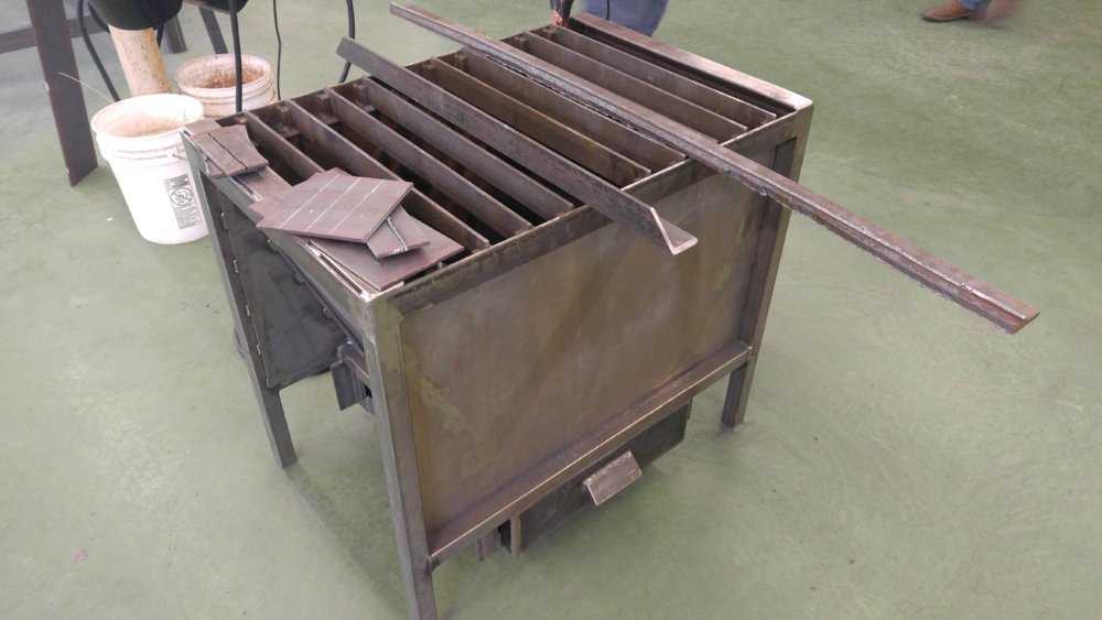

Cool little cutting station. Bottom tray slides out. Sides slope in. Top has removable slats. 16 gauge square tube, 16 gauge sheet, 1.5 angle, 2 by .25 flat bar.

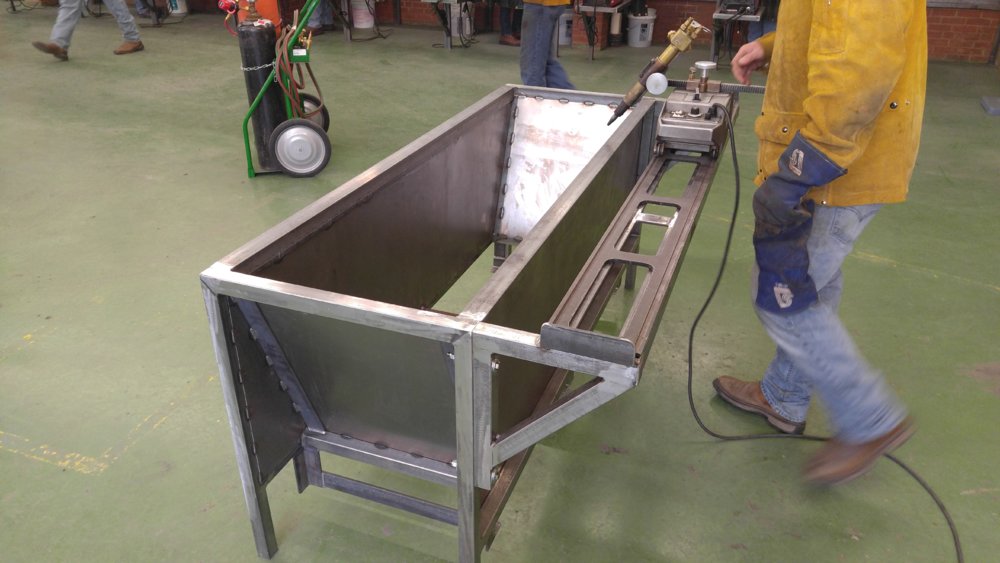

Larger one for track torch. Now has removable slats, dual trays.
Have built three more since these. Could put half solid or a removable piece for a top.

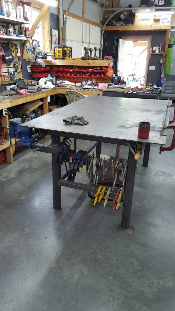

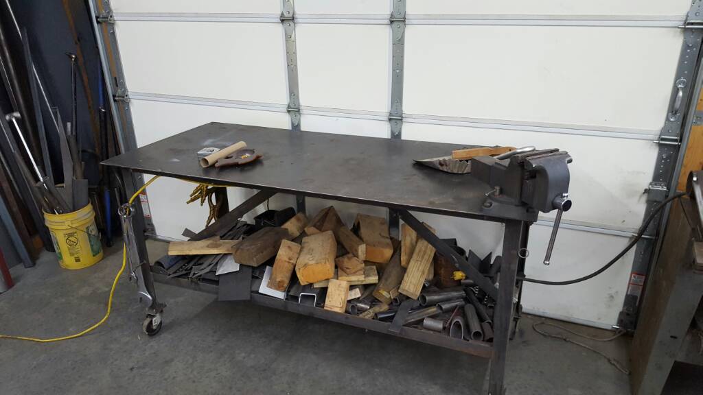

My personal table is 1/4 4 foot by 8 foot. Casters rated for 700lbs each and has a small trailer tongue I can in bolt. Really handy.

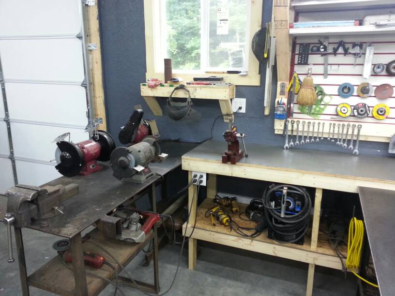

The small steel table is half .250, half .375, 30" x 60" x 38" high, with angle iron legs and spreaders. Built from scrap about 15 years ago. (Same table from the copper crawler build). Now it holds the bench grinders. There's actually a couple more on there now along with my tube notcher.
The perimeter work benches are 3/4 bc plywood 2x4 frames-24" deep and 39" high, with 14 Guage tops, attached via liquid nail. I don't really fabricate anything on these but weld sometimes. If I ever build more, I would brake the 14 gauge over the front, so I could weld tabs or attachments of sorts.

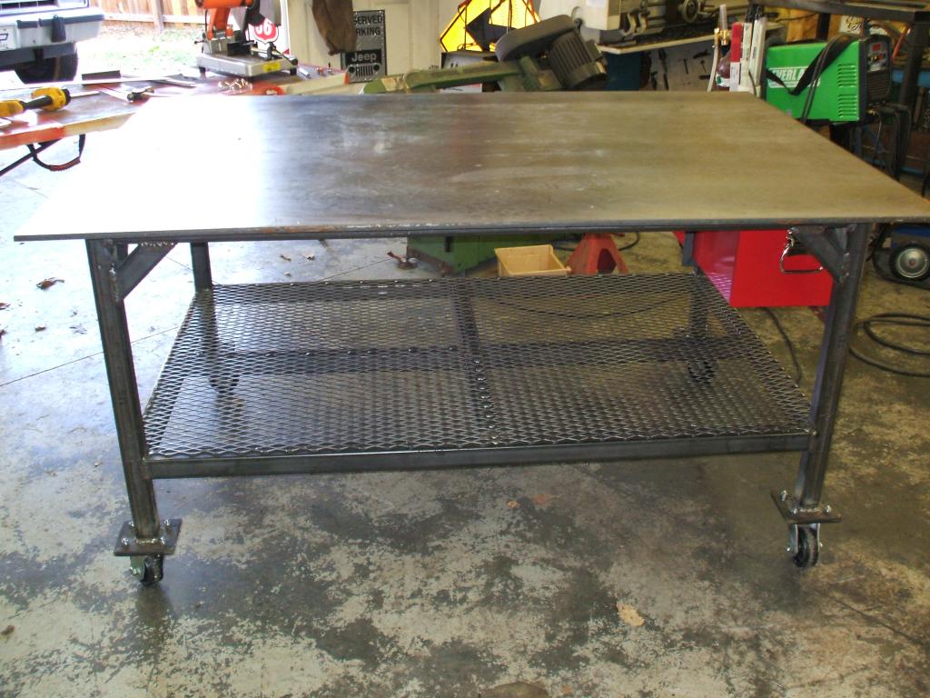

I built mine 4x6. 1/2" thick top and the legs and frame are 2"x2"x 1/4". I have a 4" lip all around it for clamping. The underside is framed for support.

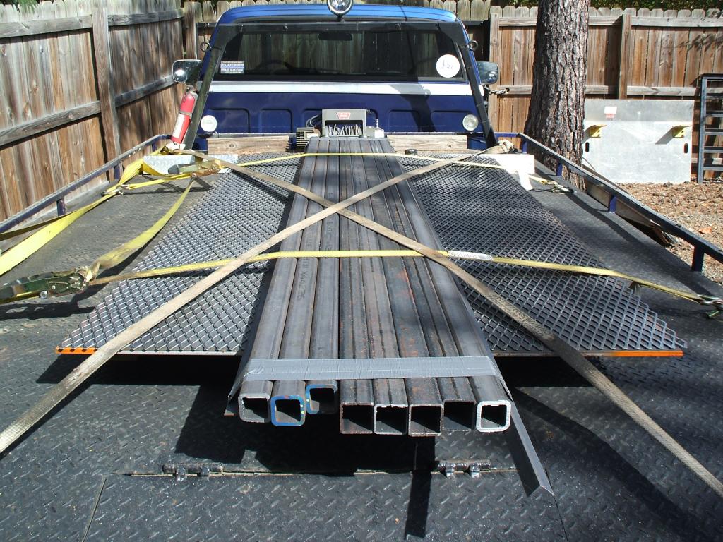

Here is 900 bucks worth of steel I started with. I know you are probably not looking to spend that much. I want this table to out live me.

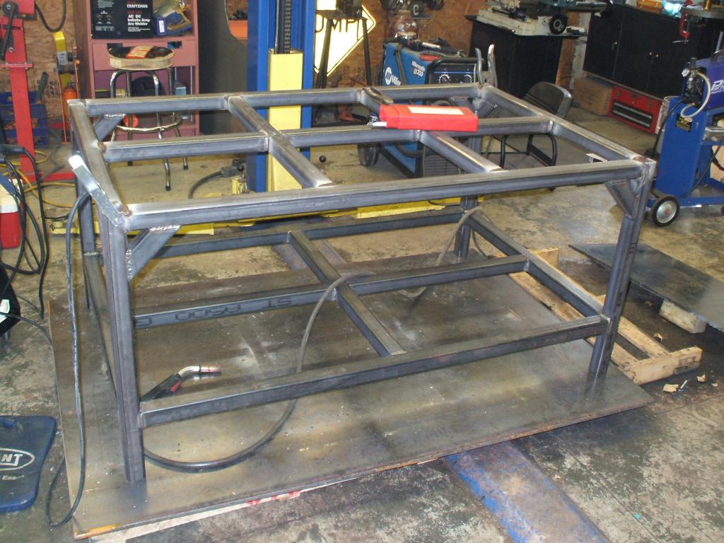

Here is the frame work.
Here it is completed.
