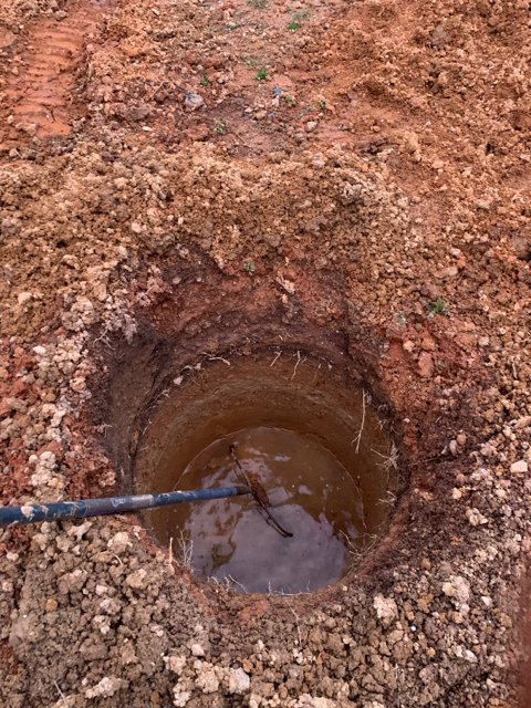

Got the plan for 18 abysses to hold our 6x6 post.
Engineer designed 30” wide holes 36” deep. Rebar at 12” and 24” through the pole perpendicular to each other. 6” pad in the bottom.
Seems beyond over kill to me, but whatever...
It was tough to get an engineer for such a small job and wasn’t cheap, but it is done.
Dug them out with the skid steer and a rental 30” auger. I had no clue they even made and auger that large, but we called around to a few places and that’s what we came up with. All but about 4 dug all the way, we are on some tough red clay that would bind the auger, so I got the joy of hand digging them by hand the rest of the way...
As of right now we are still well under the cost of installing a metal building. I’ll be interested to see what we’re at in the end.
Dang that's a lot of hole for a 6x6. The (engineered) footings for my carport were only 32"x32", 12" deep. I have metal posts sitting on top and a slab over it all.
