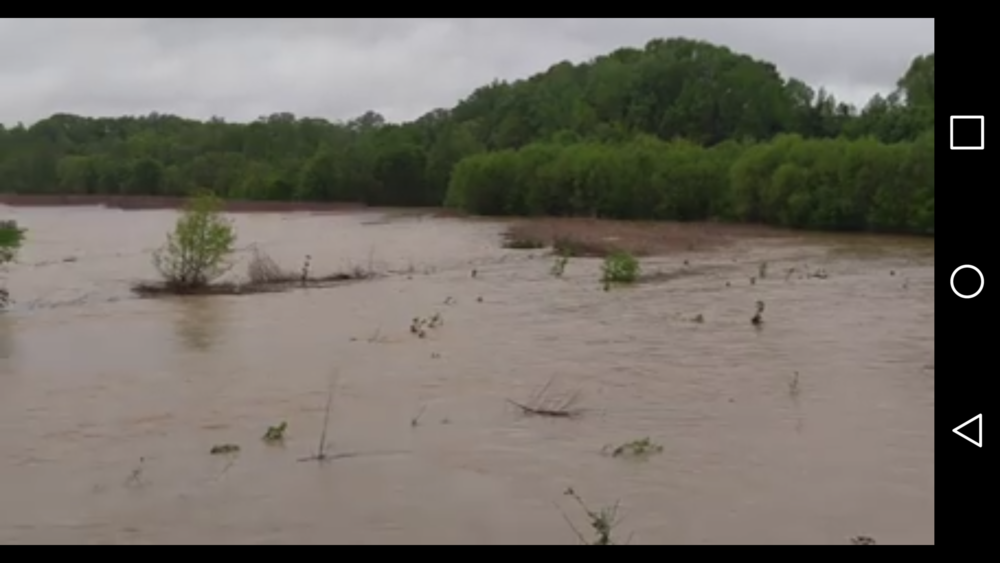

The lower half does this very often. Completely unusable, except crops that get flooded regular. Deer, coyotes, and Turkey. None that I can hunt til somebody pushes daisies. But I damn sure here about everything 100 years old needing kept up.
