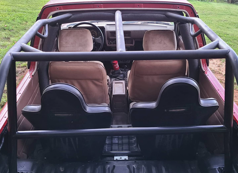

But seriously, very happy w/ how this 4xinnovations cage turned out. We made a few mods since I slightly resemble Lurch as well as got these bucket seats mounted up for my little dudes with that harness bar.

I ave always liked this 4xinnovation design, but wonder if the B pillar posts make it hard to get into the back? There's so little room already to squeeze between the wall and the seat.
To the OP - something to think about is whether you want a custom design, or for somebody to fab up a pre-made thing. There are a lot of good designs out there already that will cost you less to just pay somebody to weld together... .but it comes at the cost of not having the cool factor of custom...

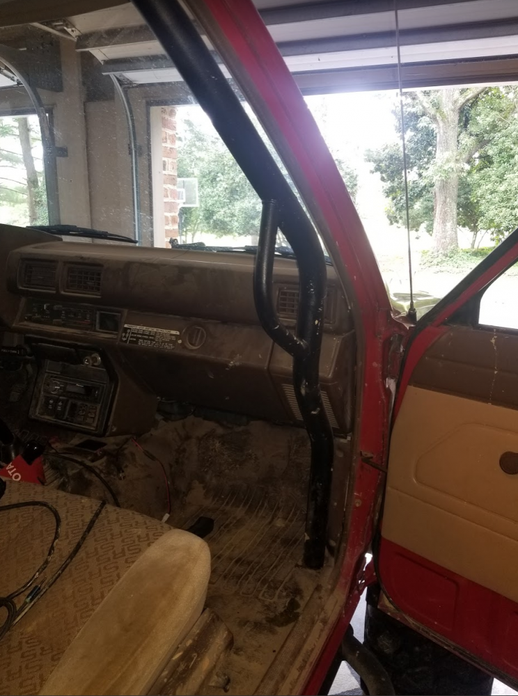

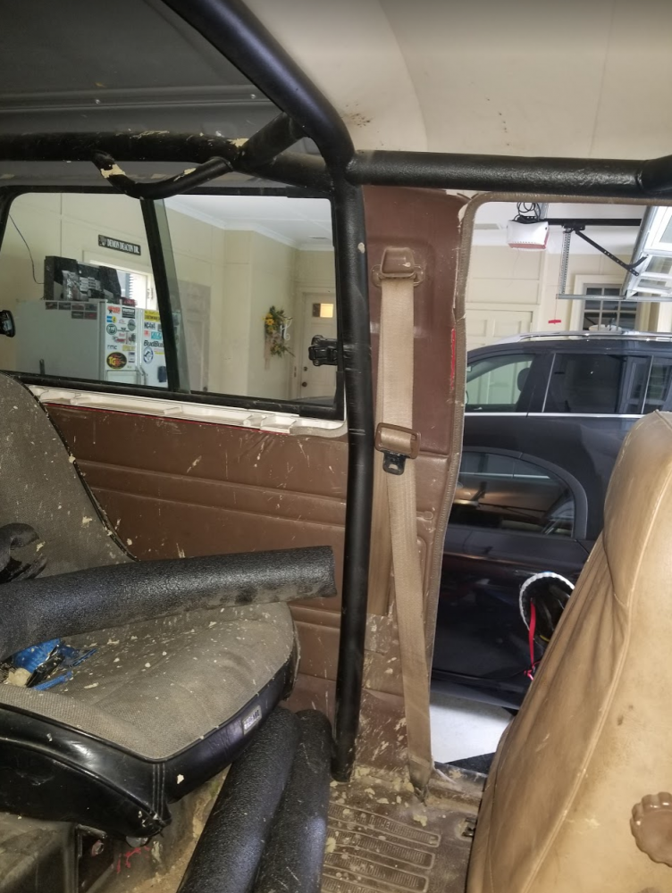

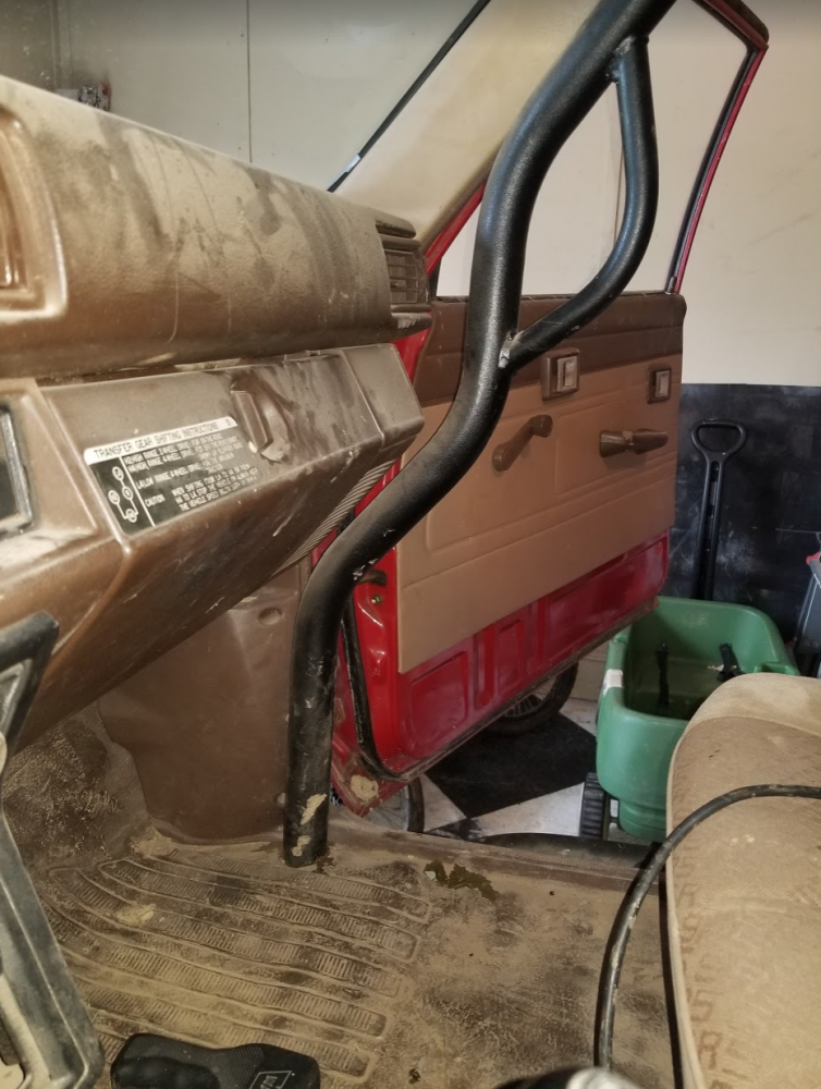

That B pillar comes in two pieces in the 4x cage to help keep shipping down and a sleeve to weld them together. We spread the B pillar as far as we could and slid it further back since I'm tall (6'3"). This required mods to the A pillar to keep it tight up against the dash.
I'll search up some more detailed pics and post up. I think for the price, the 4x cage it's hard to beat.

In the original sense they want them I think it would. On @rcalexander105 rig we pushed the B pillar up and back and extended the top of the A pillar to account for moving it back. I'm not small nor agile and I can crawl through, no worse than a TJ really iirc.

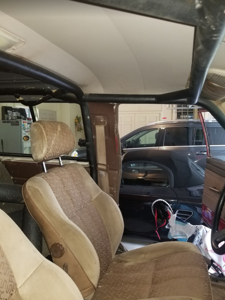

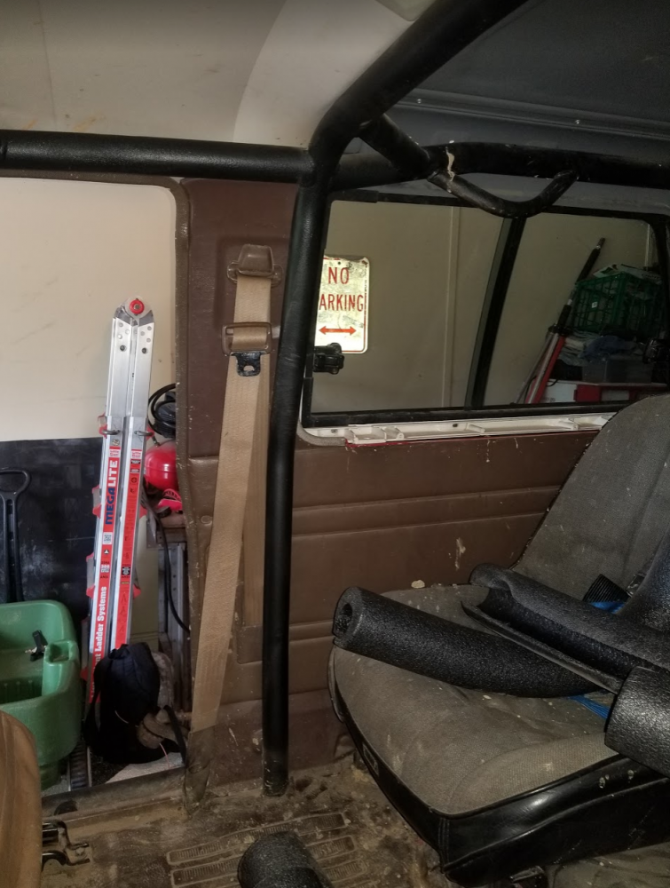

Few more pics of the cage I just took for anybody interested.
