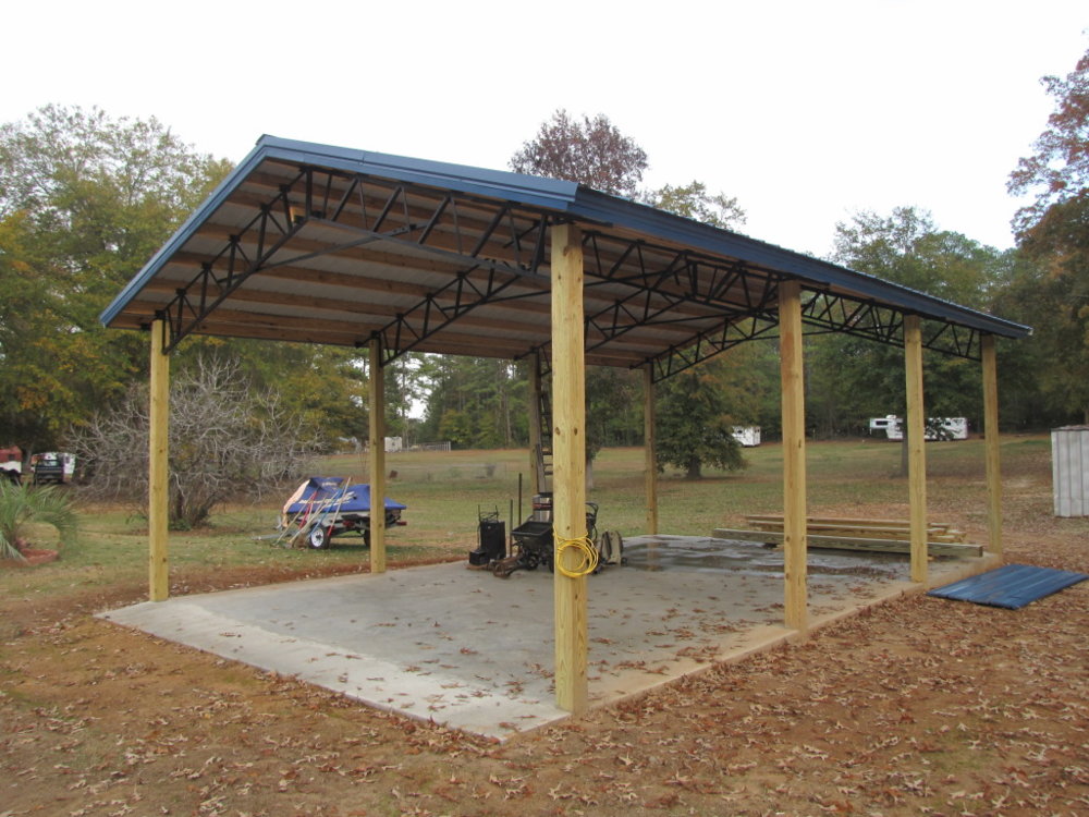

We are building a cover for the travel trailer. It will be 14x30 . I already am using the metal gable trusses.
The question is we have a gravel drive now and do not plan to change that . I am torn between having a slab done VS putting the 6x6's into the ground. I am also thinking of using sonotubes with a post bracket to avoid having to dig down two + feet. So what do you think and why? Concrete would be subbed out ans well as gravel delivery.
Slab with dryset post brackets $$$$
sonotube with wetset brackets and gravel $$$?
Dig dig dig and gravel and broken back $$$
Slab may cost more but that's probably the way I'd lean. Unless it was just going to cost you a ungodly amount of cash.

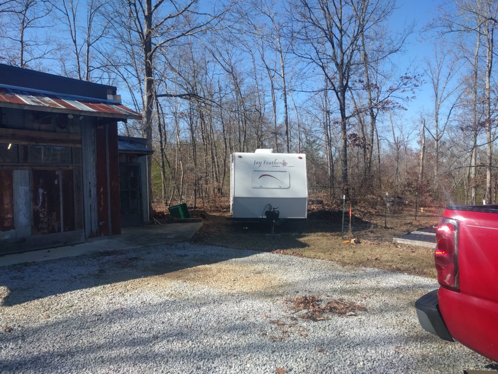

Area in question with camper in spot
