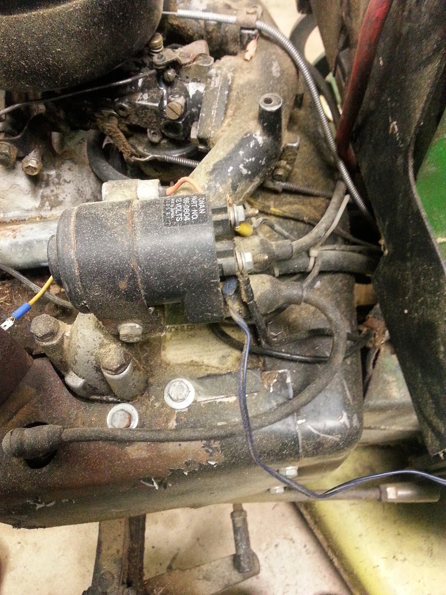

New problem John Deere 317 Kolher KT17QS
I am getting no spark to either plug.
I have 12v to the + side of the coil
I have looked at the points and they appear new.
However, there is this blue wire coming off the positive side of the coil but I don't know where it goes or is supposed to go. Might be my problem.
