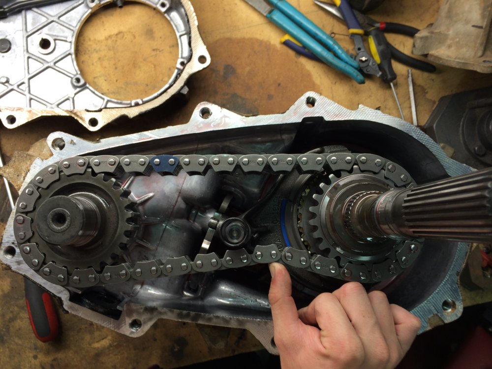

I'm beginning to suspect the chain is the culprit. Front driveshaft has 1/8th-1/4 turn of play when I rotate by hand in 4wd. You win the old parts I replace :flipoff2:

Pull the chain and use the Extreme 4x4 chain check trick. Grab the chain with one hand (two fingers) and hold it horizontally to see if it frowns at you. The straighter it holds a horizontal line, the better the condition is.

That's what I feared. If I'm going to take it apart I might as well do the chain. It will wear out eventually anyways.
I guess I'll order some parts today. Anyone have a brand of preference for the chain? Alloy USA has one for $57, the rest are $120ish. Alloy's price seems too good to be true.

If he's still there I might be able to. Otherwise I can't until next week. Doesn't make sense that anything else would be making the noise. You can hear the chain slapping the inside of the case when you lay under it and rotate the front driveshaft in 4wd. Not sure what else it could be.
I think the chain may be stretched o_O
Chain and shift pads will be here tuesday. Now I have to clean everything and install new seals.
