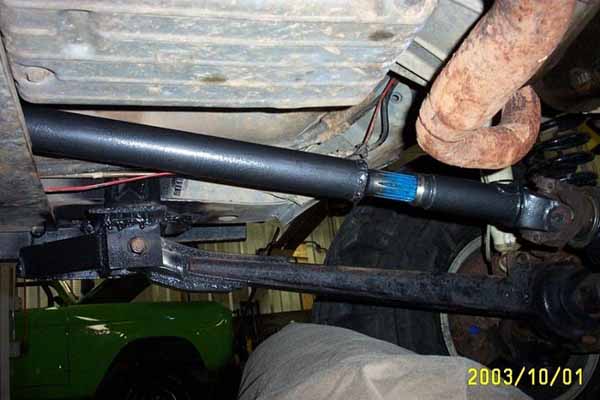

if your Zj still has the D30, without vaccuum disconnect or hubs, id not make your own... It will be spinning all the time, and anything out of round or balance will vibrate... Lots of us make our own, even square, but have locking huns to keep it from spinning all the time...
Hugh
PS, I dont think $80 is to bad of a price if they use all new tube, the local place up here usually charges about $100 or so for the short rear ive been using...
where did those of you with square fronts get your reciver tubing?

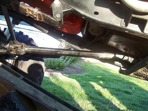

Square front shafts are sooooo last month......PTO shaft is whats going on now! :D
But to keep this thread on topic, in your case i wouldnt make a shaft. I said that before as more of a joke. If your way too cheap like me and have a peice then it doesnt really matter that much. ;)
How thick is that PTO stuff? I had looked around before I built my square shaft, and all the PTO stuff I found was no thicker than .095, maybe .120 if you're lucky, so I went with the square...
Metto.. I got the square stuff from Raleigh Hitch, but it was $$$.. I think tractor supply and/or Nothern will have it far cheaper.
i looked at both TSC and northern and they didnt have anything long enough. also i was looking at their PTO stuff, but it wasnt thick enough. they did have some material with a solid square bar male part and a round female with a square insert, but they dont have yokes that work with truck stuff. apparently PTO stuff is all different yokes
