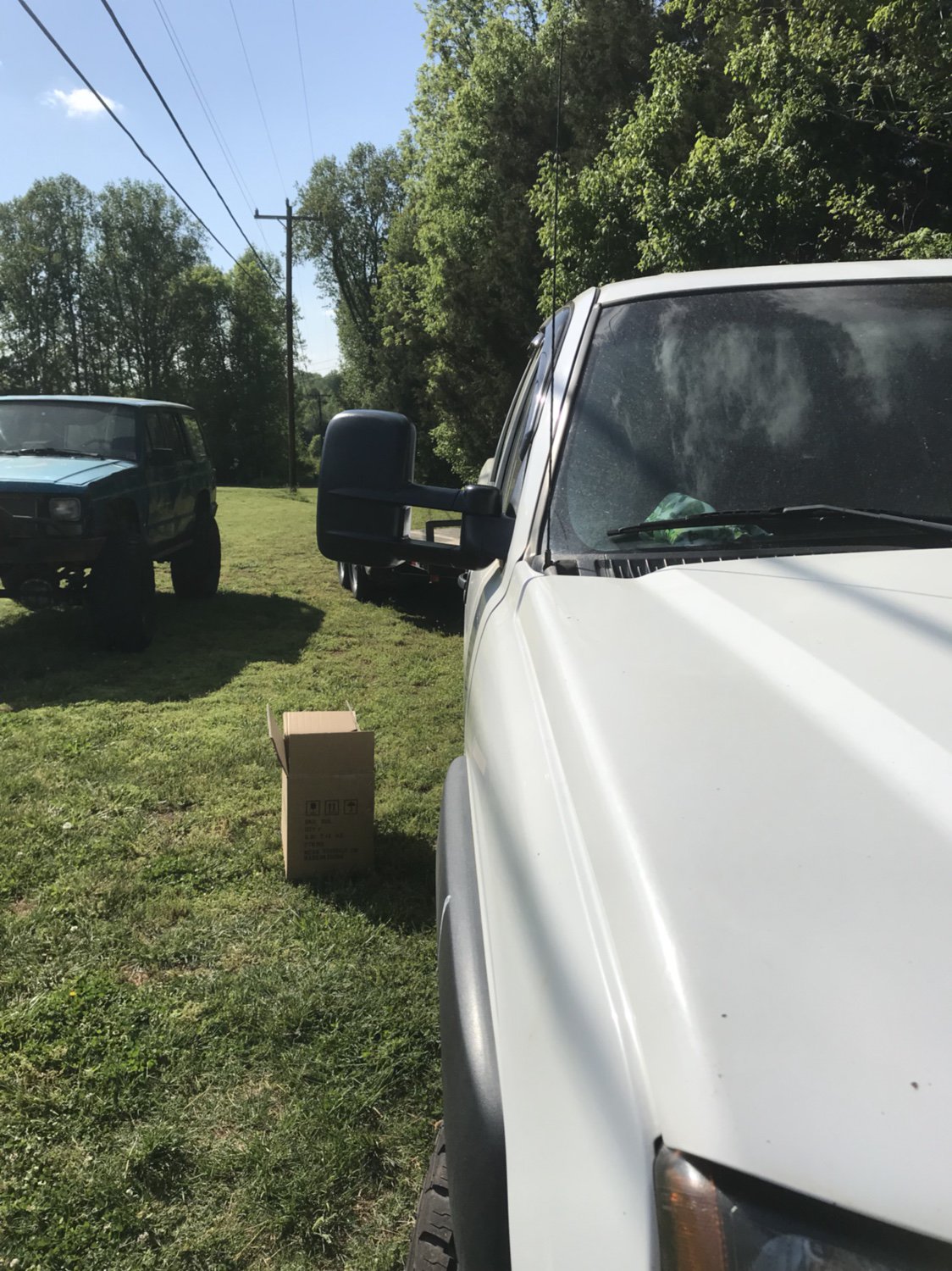

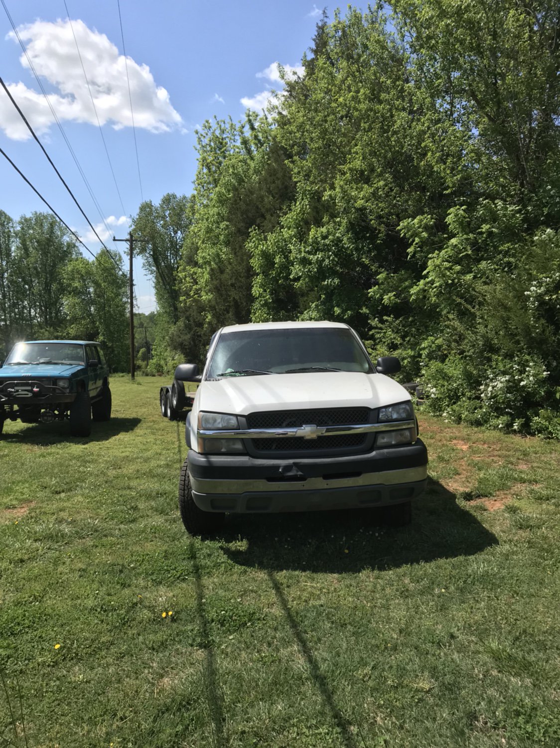

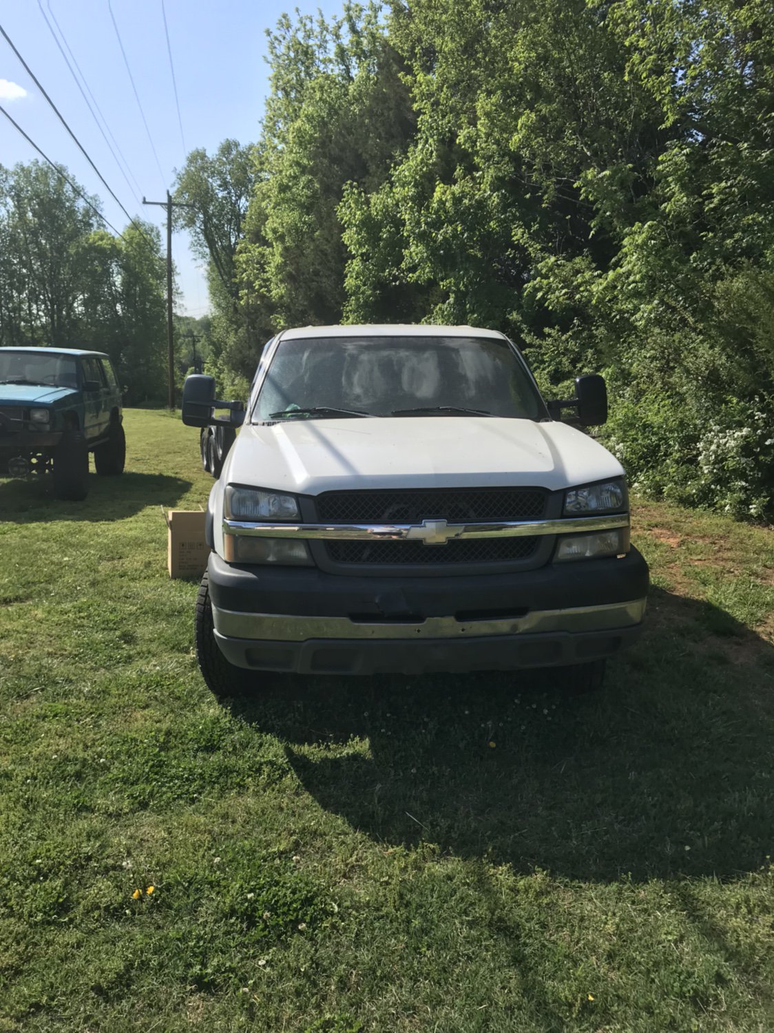

I ordered tow mirrors, they should arrive this week.
Also, my trip to PA was canceled to do the benefit ride for Scott. Still gonna put the truck to the test though cause if everything works out right I should be going to Bearwallow in Logan, WV at the end of the month. Should be interesting going up Fancy Gap.

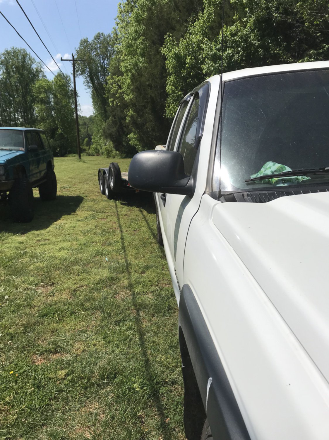

Tow mirrors engaged! Before and after. Looks a lot better, and I can see a whole lot better now. I didn’t put them in ghost trailer mode, just looked goofy. I know that’s optimum HP and MPG gains but my flat bill is at the cleaners so I left them slid in.

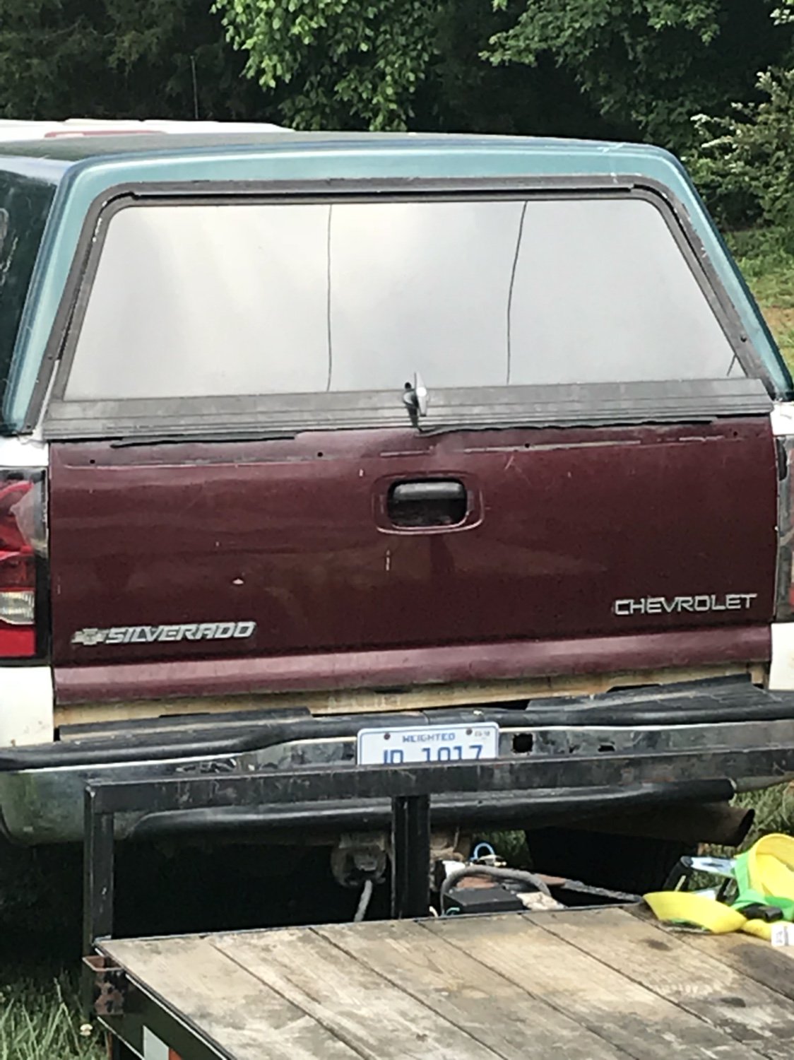

I swapped a tailgate from my buddy’s wrecked parts truck. Tail gate opens and shuts as it should now and has a real handle but I still need a bezel. I also snagged a few interior pieces, one being the flip down console. It needs a good cleaning and a new lid.

I plan to paint the tail gate and the camper shell soon. Probably have it painted by the time I go to Harlan in August. Most likely just going to rattle can it with some good paint.

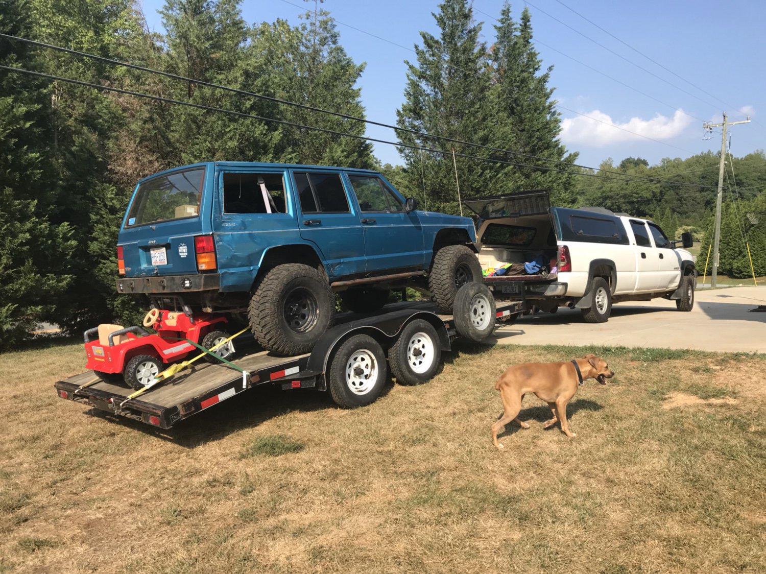

I have it loaded down with a few hundred pounds of gear in the back and my family of 4 for the ride, even got my boys Power Wheels Jeep.

You really need more straps on the rig. 1 across the door sills doesn't seem like enough to me.

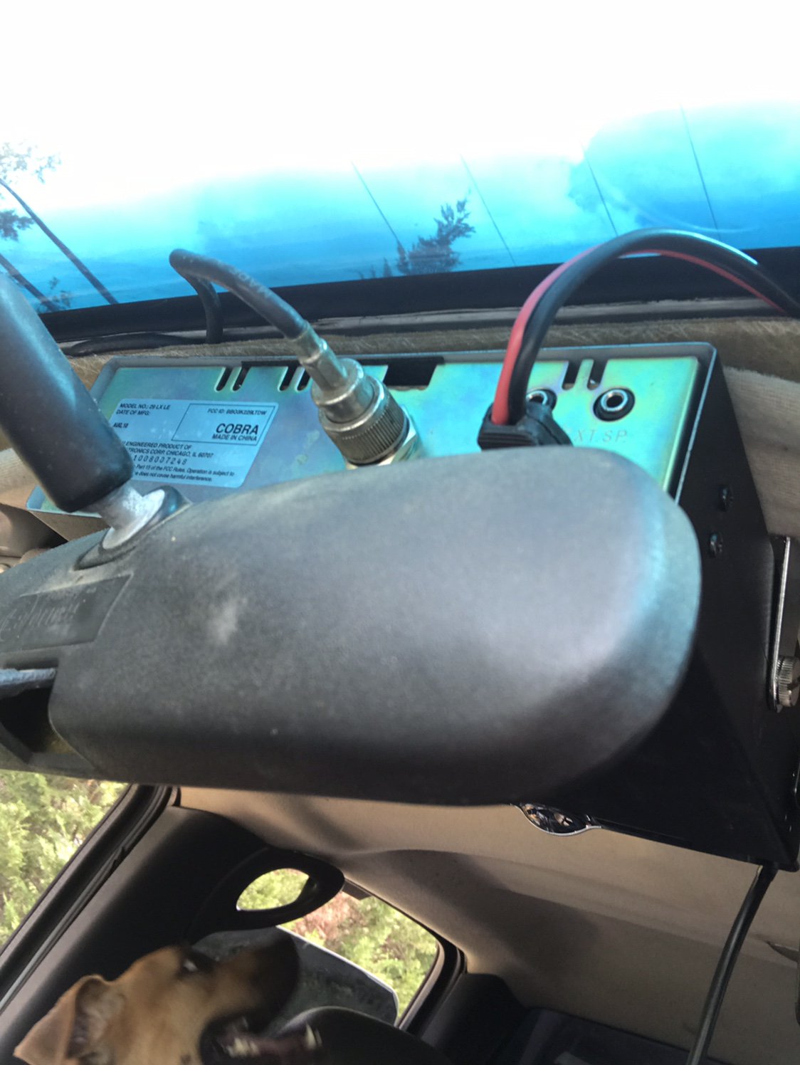

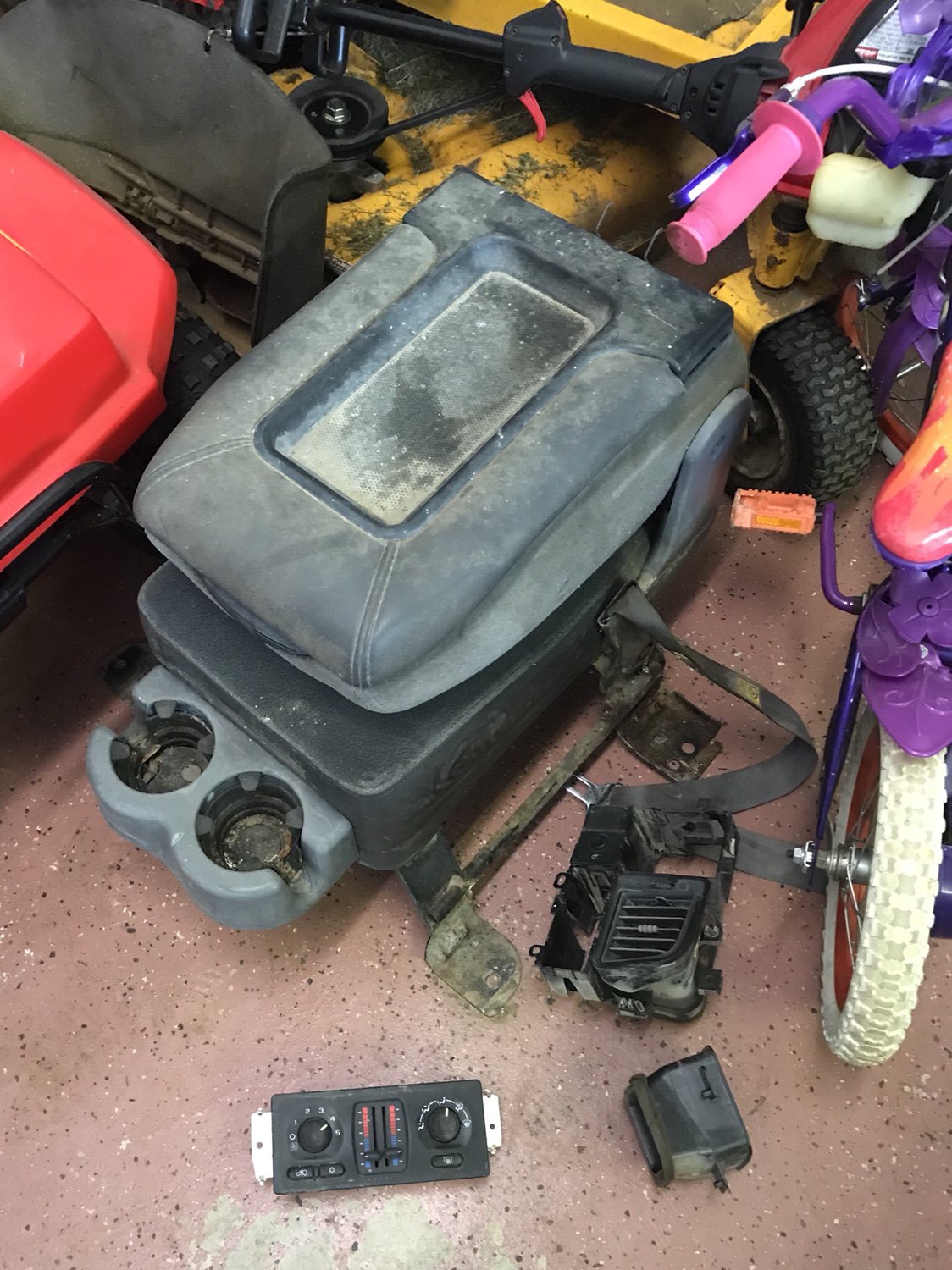

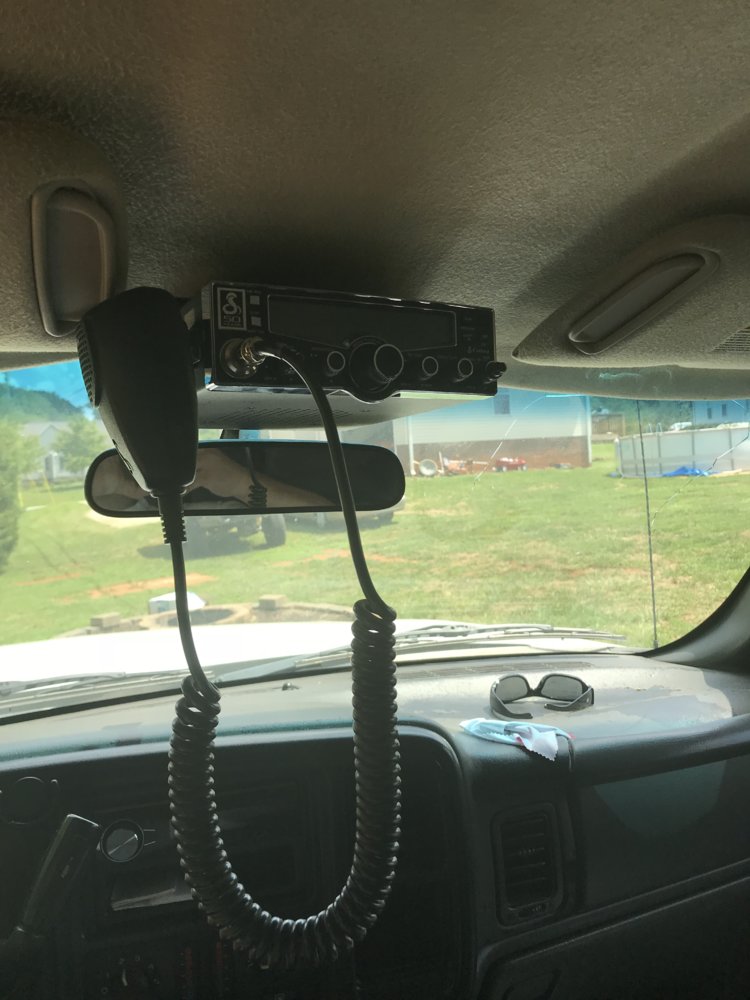

I installed a flip down console and a CB for those long trips. Sleeping in the camper shell is going well too, so long as I don’t forget to close the lid and let in rain all in the back at Harlan :mad:

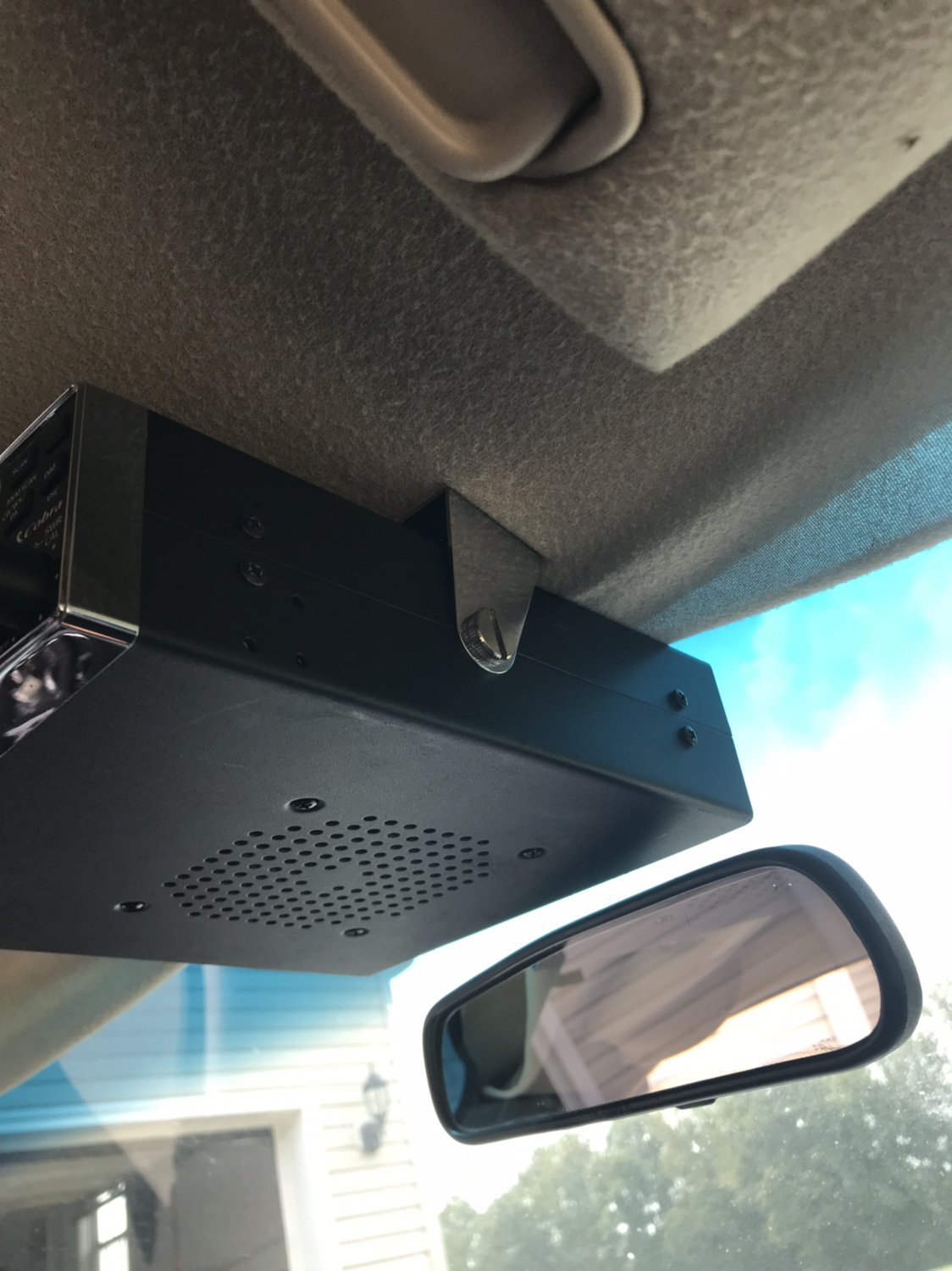

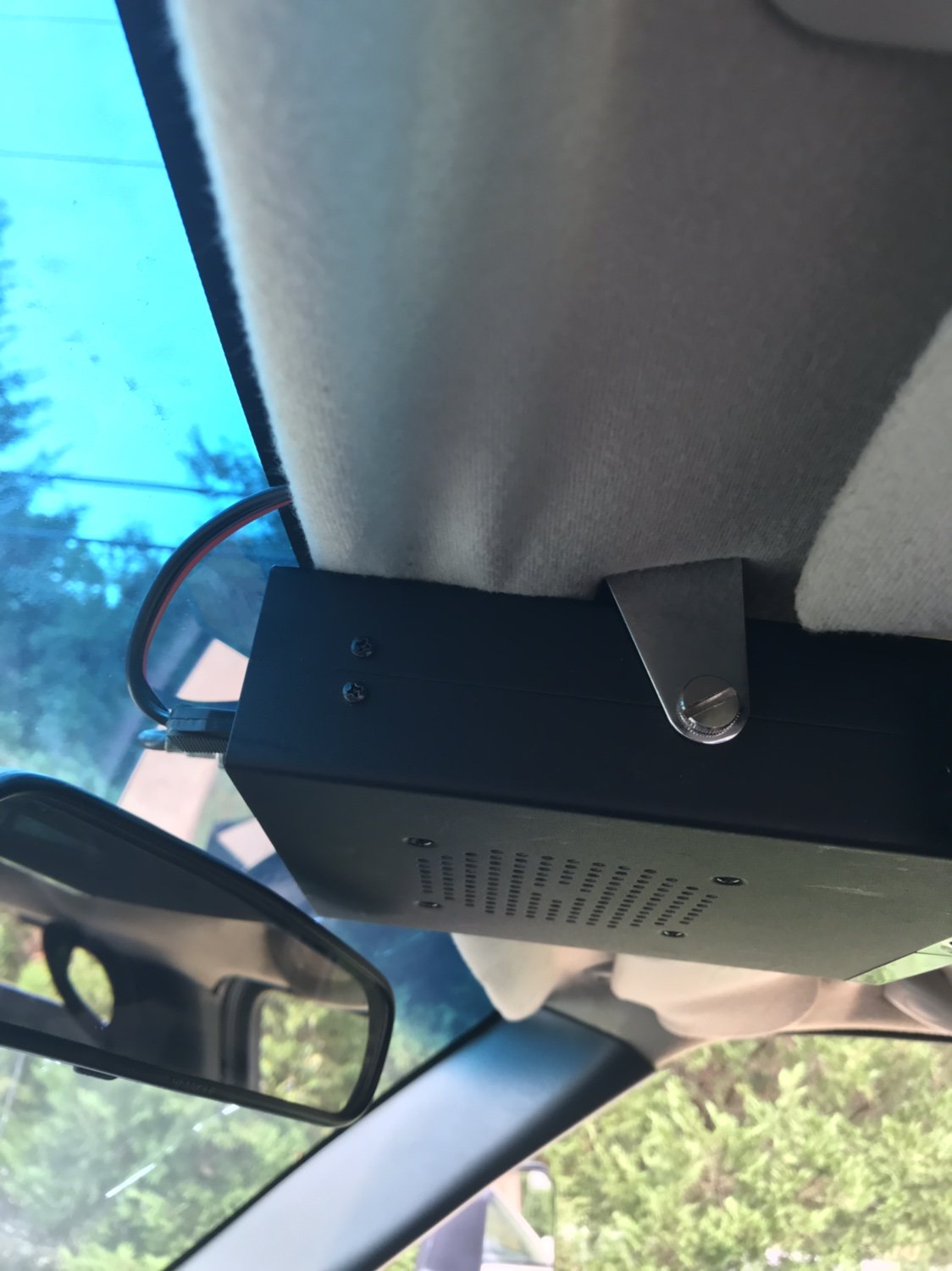

Been following this thread and I think it’s awesome! How did you mount that CB? What did you screw the mount into?
@tlucier I used 1-1/4”self tappers right thru the head liner into the roof. There is a support brace there so it screws into that and not the actual roof. I tucked all the wiring up in the headliner and ran it down the behind pillar molding so you can’t see any wiring.
I had mounted a cb like that in an XJ years ago so I figured there would be a brace above the headliner and I pulled it down a little to confirm before I done it.
I did not like any other of the mourning options I had. It was in the way, inconvinent and just didn’t look good. Mounting it there is perfect. Not only does it sound great since the speaker is on the bottom, it’s up and out of the way and I just take the mic off and put it in the glove box when not in use.
I will take some better pics of that setup for you soon. I originally tried to use 3/4” tappers but they were not long enough to get they the headliner to the brace.

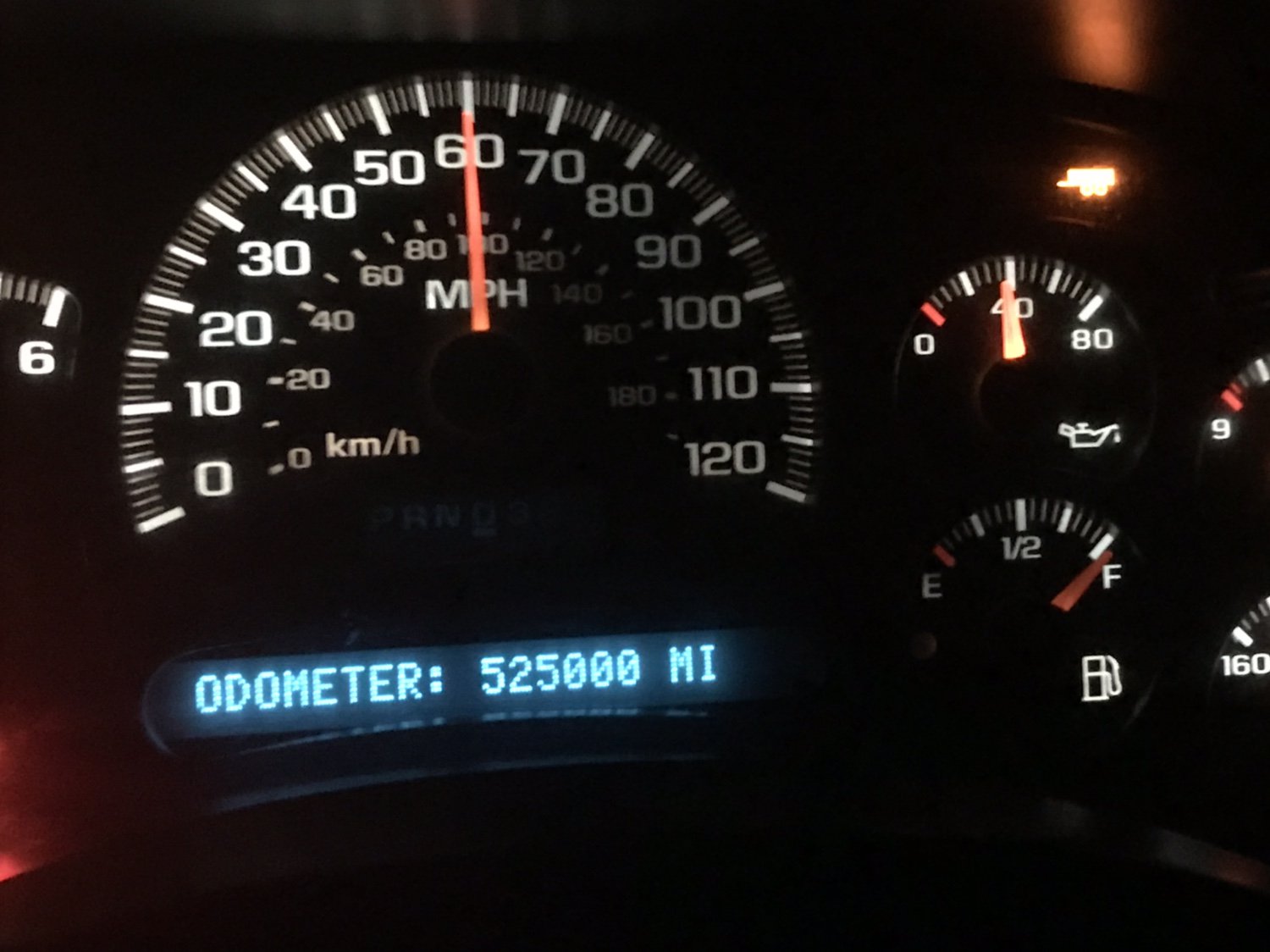

525,000 miles and counting!!
Also, the oil pressure had gotten low again, so I changed it last night. I had put some cheap oil called Peak in it before. This time I went with Penzoil high mileage. Oil pressure is back up. However I’m convinced about all oil is the same, I mean how many people are actually producing oil? I imagine there is only a few manufactures and they just brand it differently.
