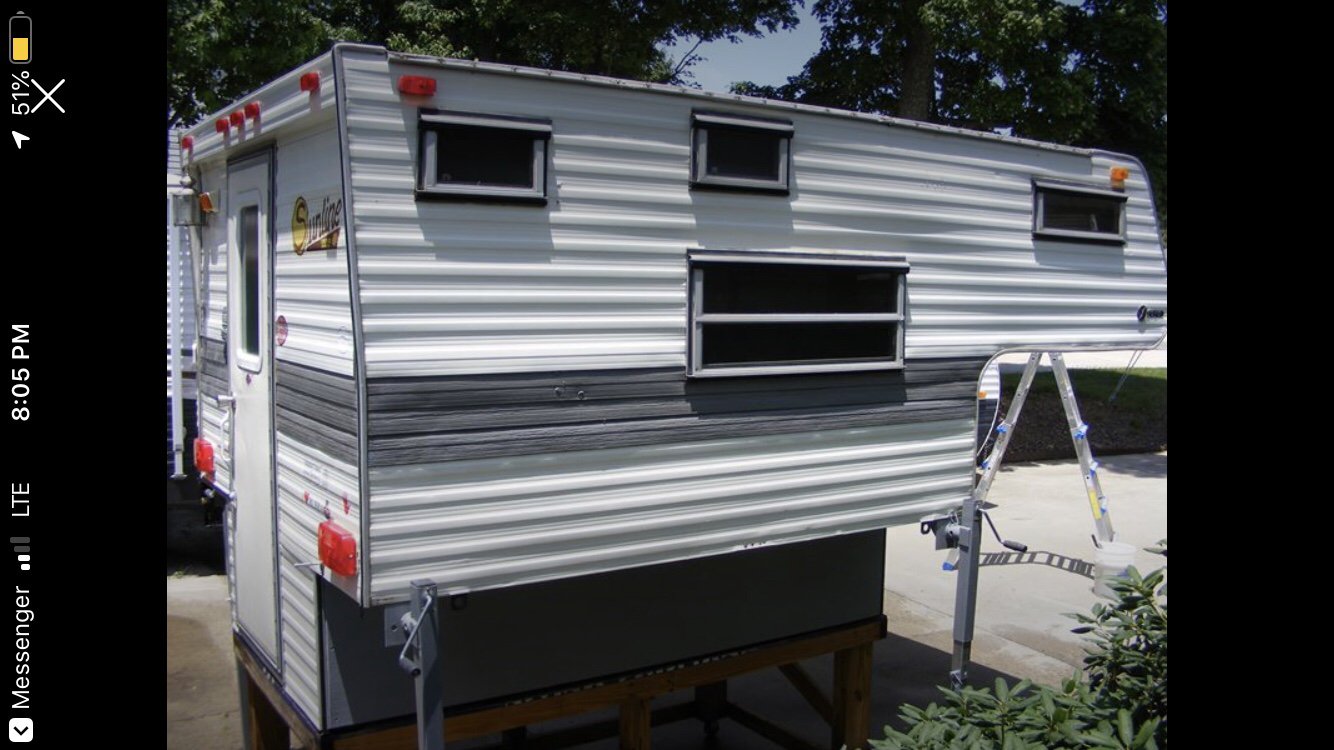

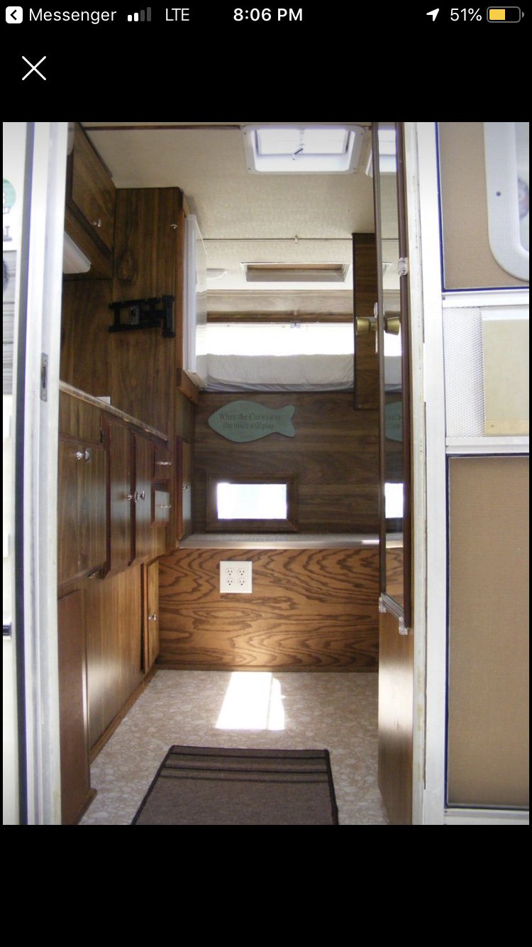

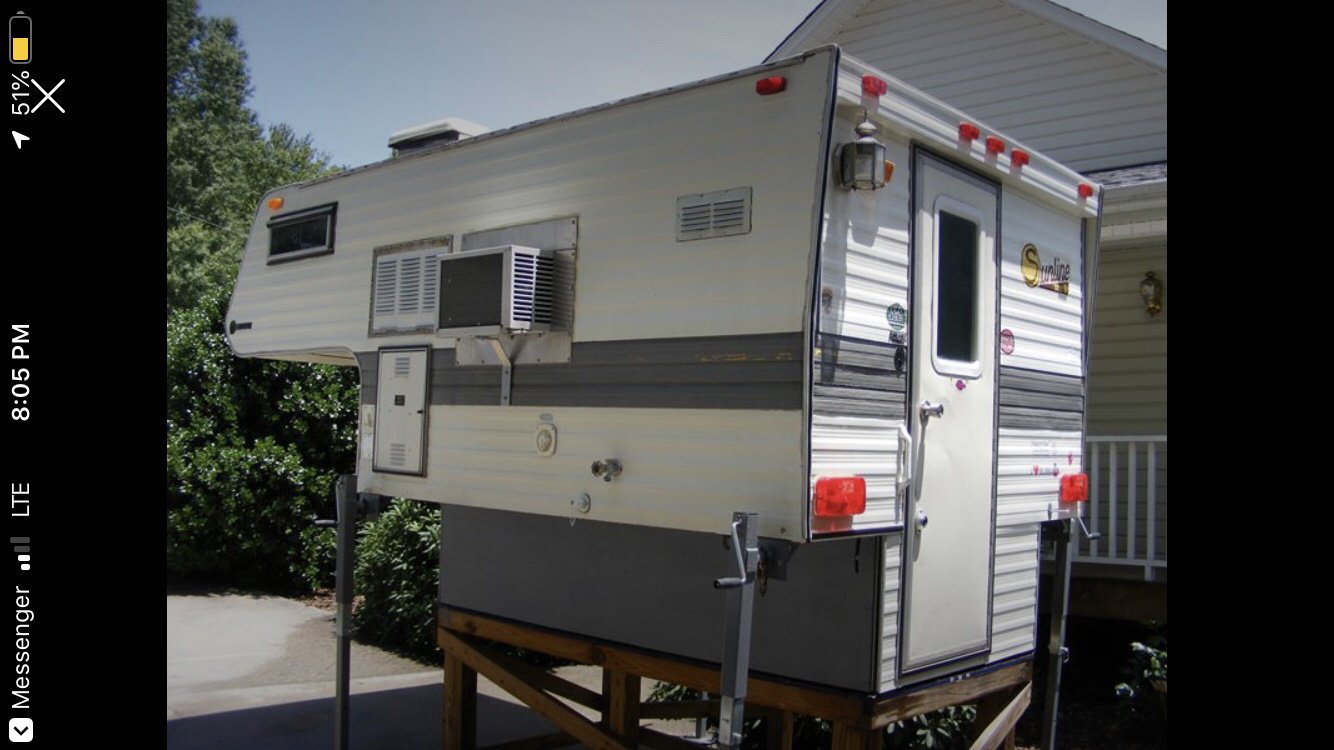

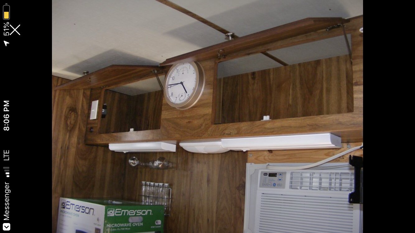

Someone is supposed to buy my camper shell today. I got a nice little upgrade this week! Wasn’t really looking but happened to come across this one at a great deal. It’s an older 8’ SunLine.
Has a window unit AC mounted in the side. It’s REALLY clean and well cared for. Truck brought it home fine and held 70ish with only a little extra effort. If time allows, I’m going to drag the Jeep down the road with it today as a test tow.
And, it even came with the wooden stand to set it on when not on the truck.

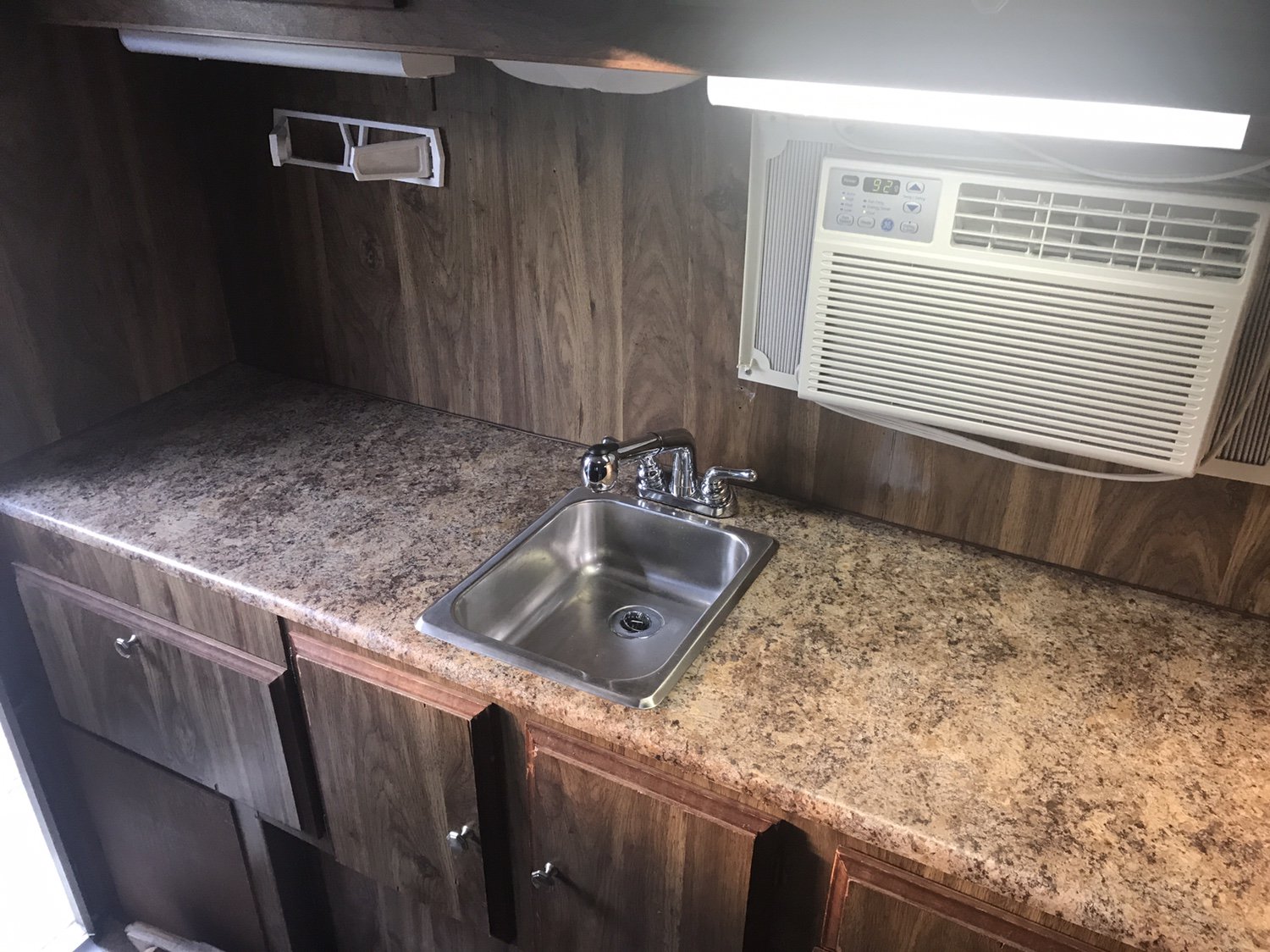

The tank has been changed out, and it has an updated 12V pump system in it. I have no idea what size tank it if but I think it’s 40gal. There is no holding tank. It only has a sink, so it’d just be gray water from washing hands or a dish or something. I’ll run a hose to a bucket and empty as needed.
It does have an outside spigot, so I can potentially use that for a quick rinse, lather, rinse type shower for me and the kids if I do it quick and efficiently.
