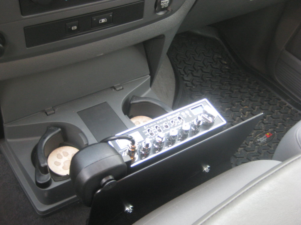

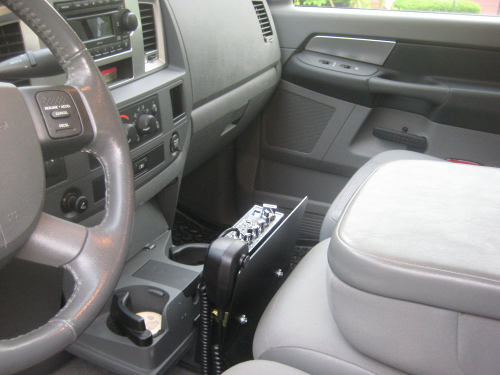

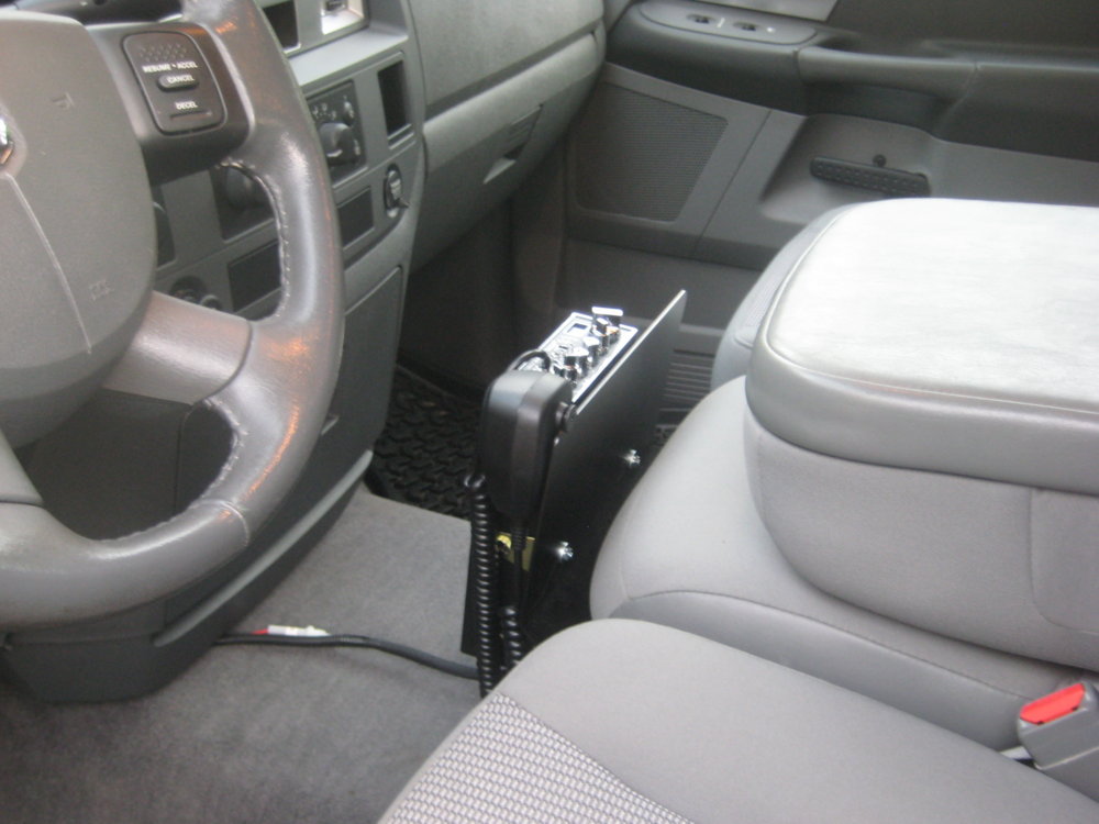

@Jason W. - sorry for the delay in getting these pictures to you, and on top of that these really aren't the best pictures but they're all I have. Like I said, I bought the bracket from genosgarage.com and it has slots for the bolts holding the center console to the floor. You loosen the bolts, slide the bracket in, and tighten the bolts. Held it nice and secure and still had access to the lower console release. Probably could fab something pretty quick & easy for your Chevy.

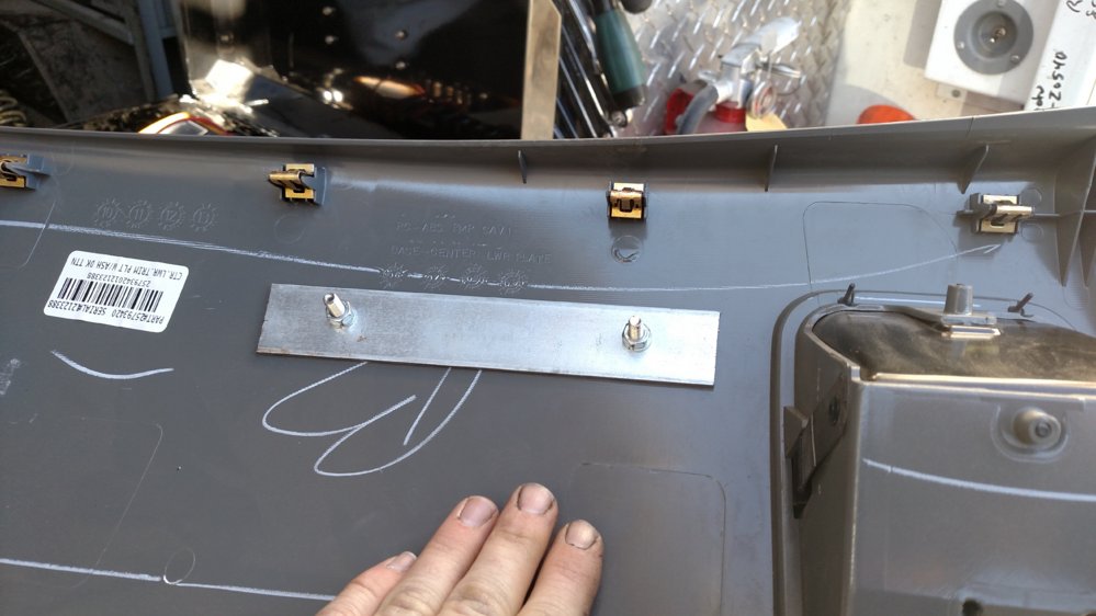

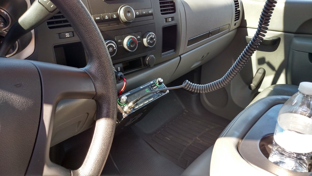

Got everything installed today and went the dash mount route, I used a piece of stainless that I had laying around as a backing plate for the cb mount. The plastic piece in the middle was really stout with 8 clips and two screws. I think it will support the radio fine.
I found a Rubber plug in the rear driver corner and ran the antenna cable through there to the magnet roof mount .
