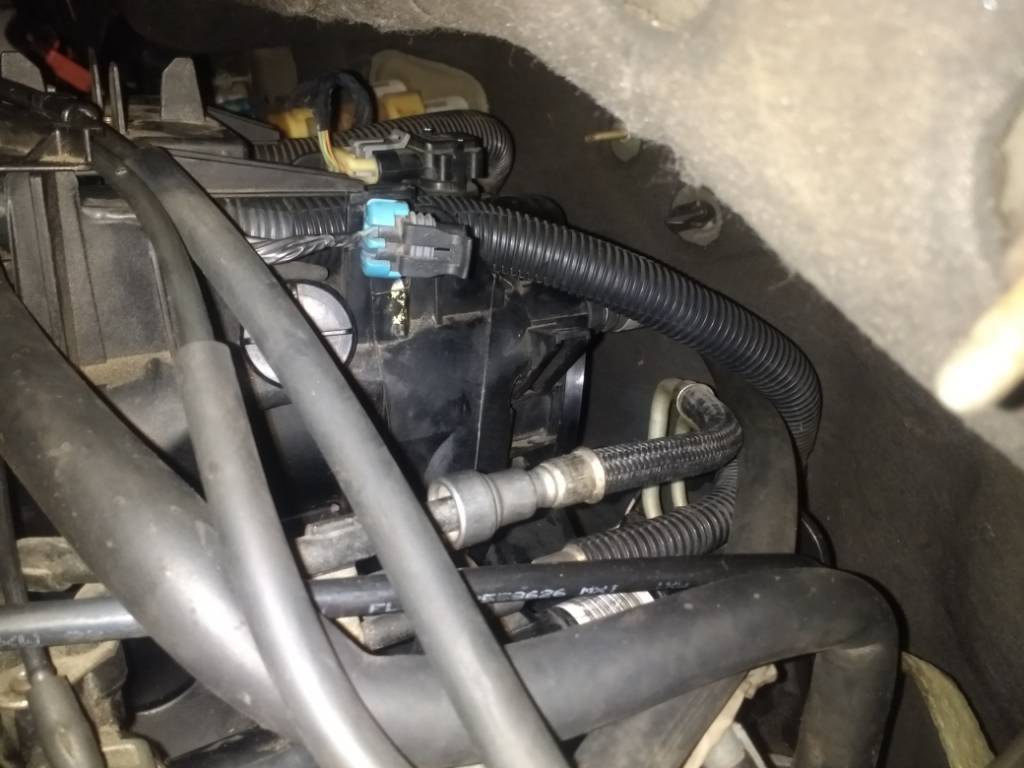

It's all back together, but I have one connector I can't figure out. It's half blue and located at the top of the intake on the driver side near the firewall. Anyone know where the other end of this connector goes?
Thanks
Sent from my Moto G (4) using Tapatalk
That's for the knock sensors. It runs up behind the intake from underneath.
Thank you very much. I found the other end.
