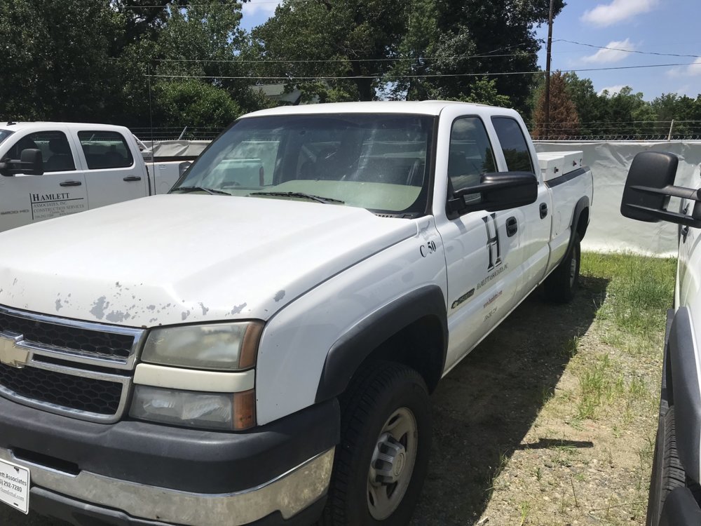

Truck in question...
300k, has the Allison, new tires, recent tune up, new AC system, serviced regularly. One of my clients has it for sale at a steal and hopefully y’all are talking Adam into scooping up this thing! It just got replaced with a newer model and rolled out of service.

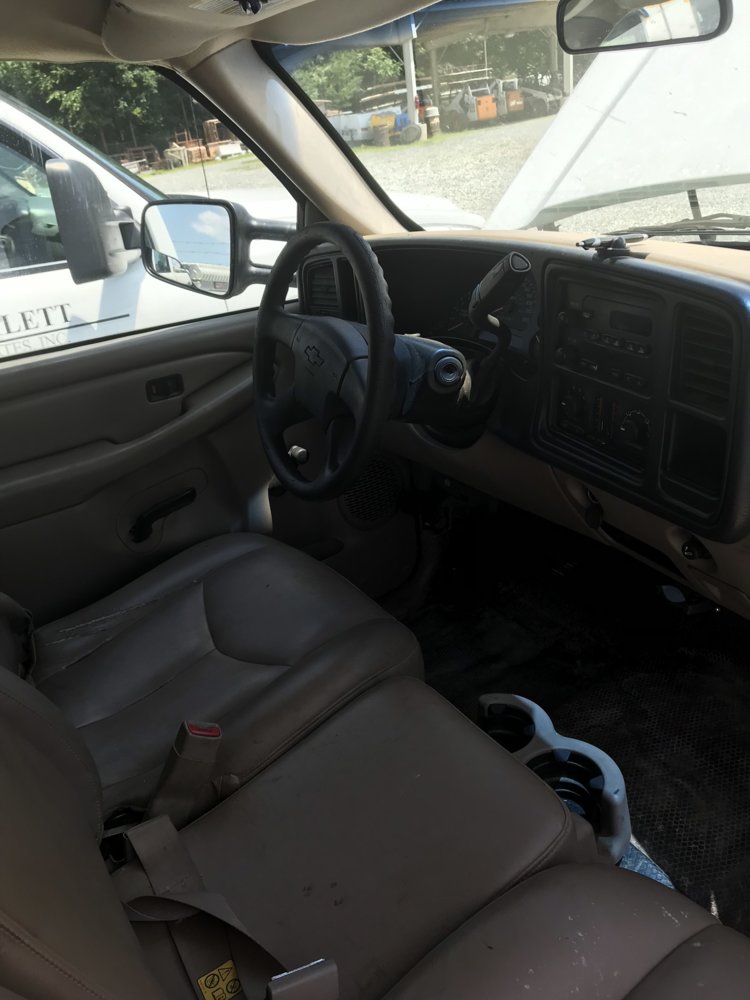

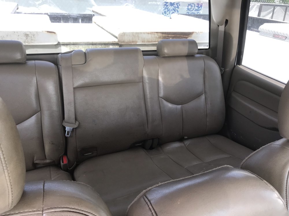

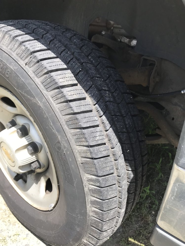

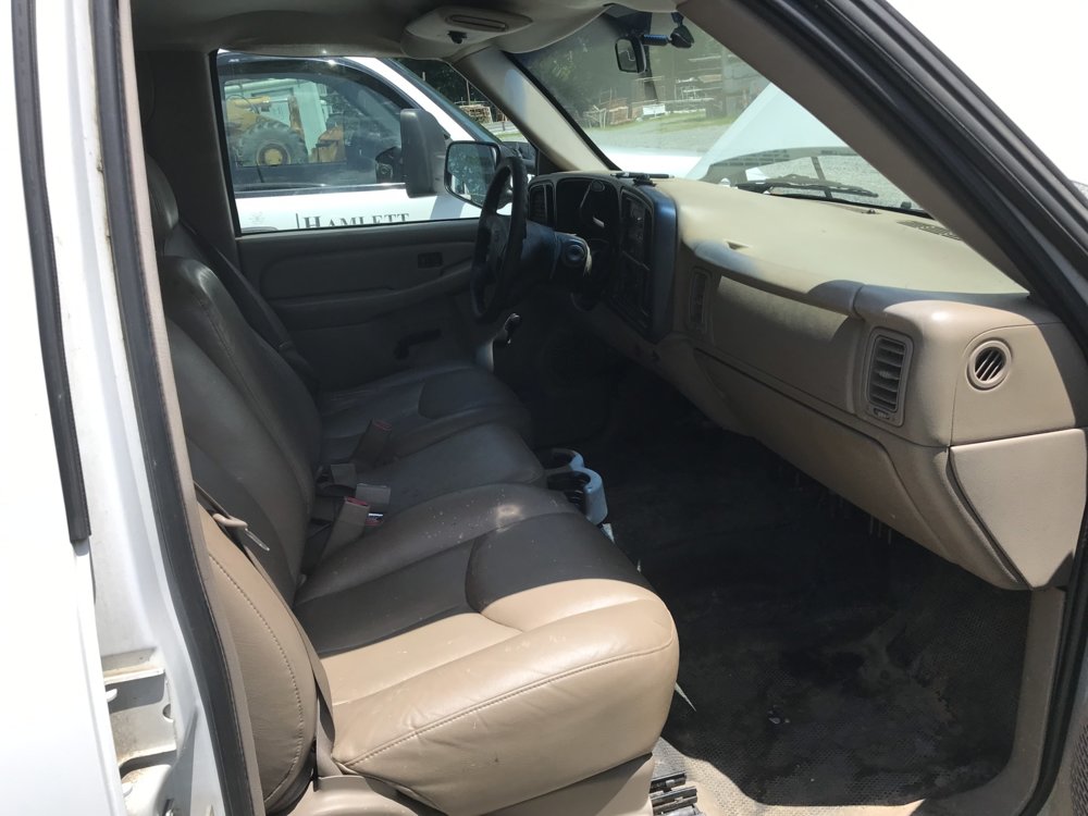

View attachment 298615 View attachment 298616 View attachment 298617 View attachment 298618 View attachment 298619 View attachment 298620

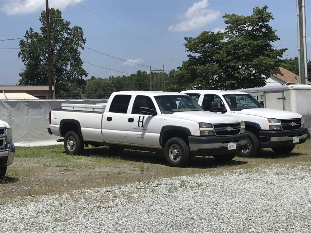

He has an 04 Ford V10 dually CCLB also. 2wd, same mileage, same condition. $3600. He has trucks like this come out of service 2, sometimes 3 times a year. I have sold 3 of them for him lol.
Next time one comes up, I’ll post it here for everyone.
