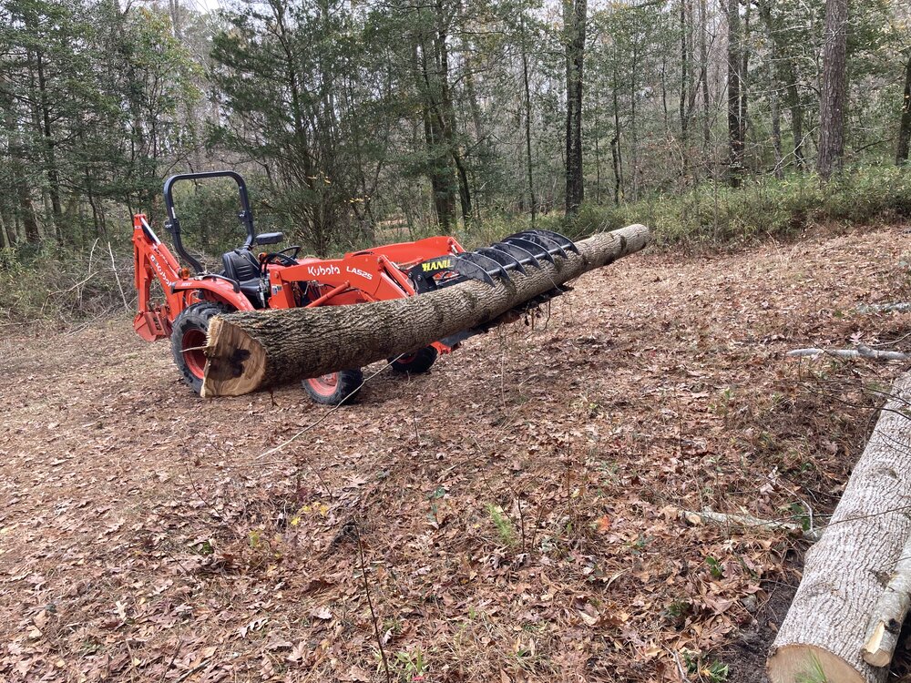

This is all I need it for at the moment. Stacking logs for the sawmill and now have to clean up all the limbs and brush. :)

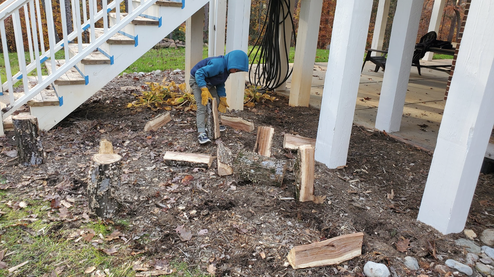

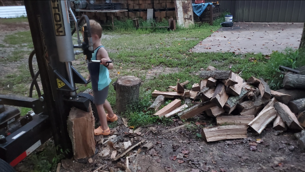

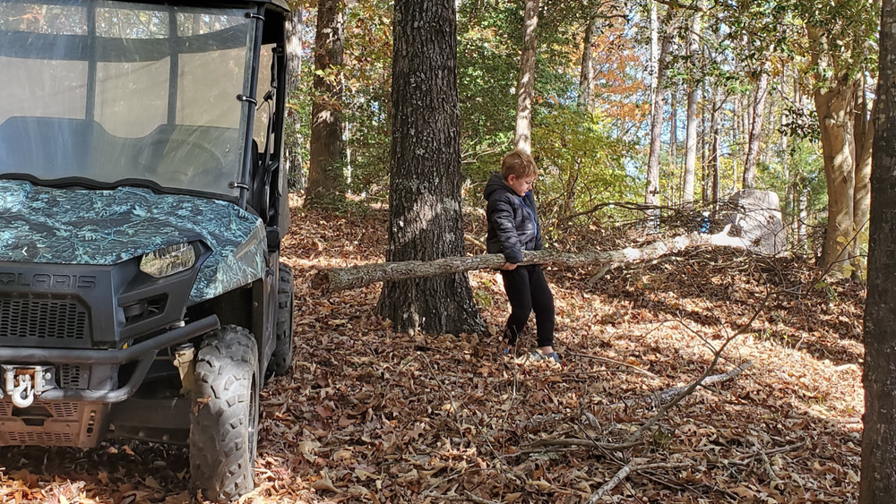

I have a wife and 2 kids that need some hard work. They can use the chipper. :D
You really shouldn't exploit child labor. There are organizations that are opposed to that.
