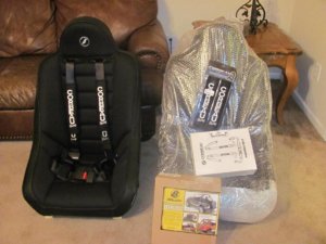

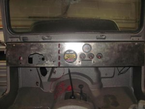

Was ready for a clean job today so we decided to finish the dash and wire a few guages and toggle switches. Got the baja ss seats and harnesses today can't wait to get something to bolt them to!

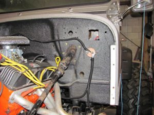

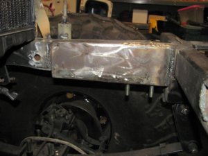

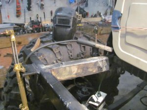

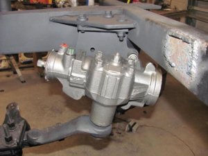

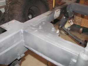

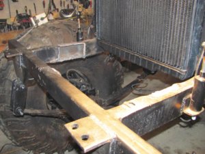

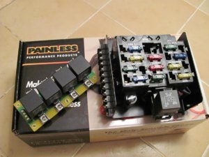

Making headway, reinforcing chassis @ strech and beefing up steering gear box chassis side waiting on heavy duty bracket,moved radiator up 1.5" to clear steering shaft, mounted steering column(waiting on lower shaft brng, got 12 circut fuse box and relays to work on in slow times.

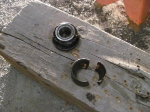

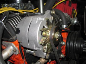

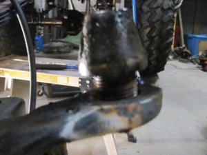

A few more.. kingpin removal(very little effort,note heat marks),busted KP bushing,105 amp powermaster,Advance Adapters D-20 tailshaft.

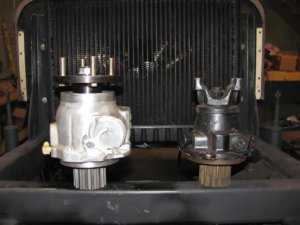

Not much for taking pictures on a daily basis while I'm working so here's some progress lumped together. Still some wiring and rollcage left to do to get it rolling. Did some test runs around the yard with the 2 quart plastic gas tank didn't get very far. Sorry, I thought the shots were going to be labeled, In order.....
1. Olivers drivehaft alot of beef compared to stock.
