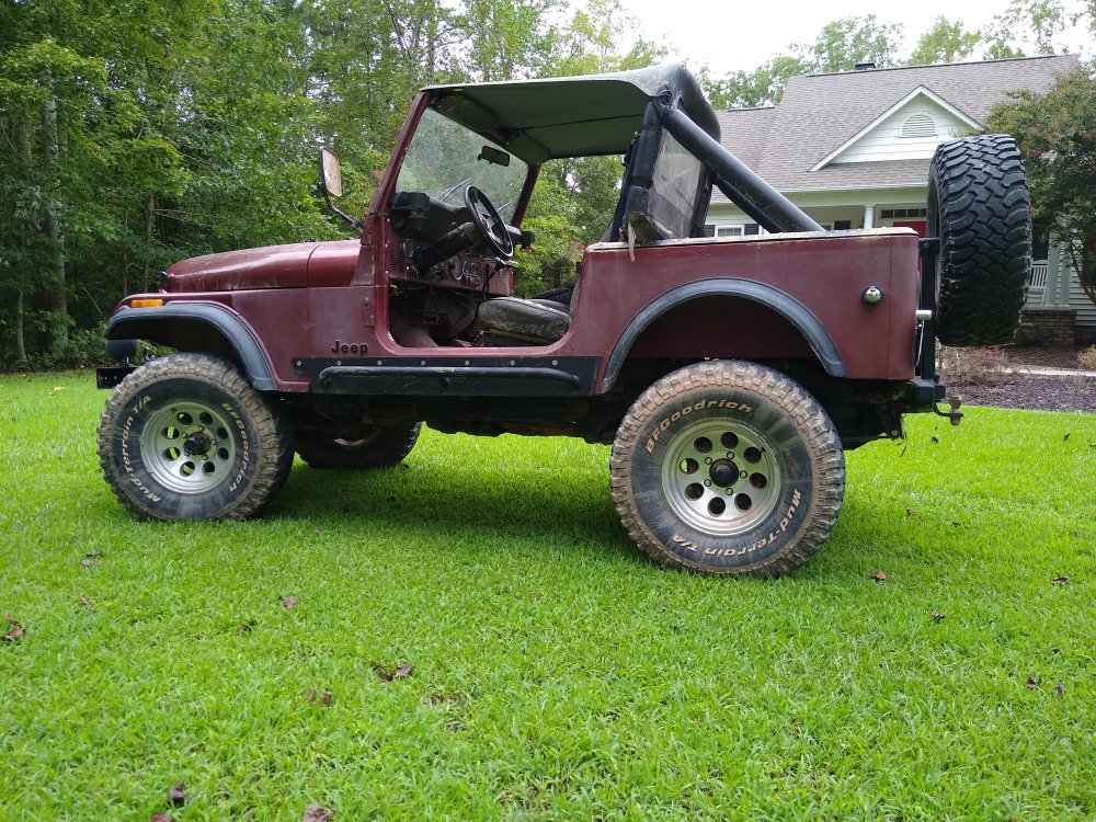

Usual back story - been wheeling full size mopars forever. Always wanted a nice cj daily and weekend warrior. Got carried away one weekend and now it's on 42's and tons. Since our hobby has long since passed this sort of basic build - below is the cliffs version mostly for entertainment value as this is very low tech.
In the beginning it was a rust free 85 from california. Has a hardtop and nice full hard doors to. Bought it with the mopar multi port efi kit installed. Dude said that was the only way he could pass smog in cali. Anyways it was otherwise stock. I did a spring over with yj springs all around and tossed on a set of dry 33 bfg I've had laying around forever. I'm in range of Watson's jeep salvage so the whole spring over parts list including the junkyard shocks was about $80. Ran it like this for a couple years. Several URE trips, Kairos, run around town etc.
I've had a set of cucv tons laying around and an older set of 42tsl's with maybe 100 miles on them. Changed jobs and have a stupid commute so the jeep pretty much just sat in the garage or got trailered to the hills. So considering I wasn't doing hardly any road miles on the old cj I couldn't think of one good reason why it shouldn't receive a few minor adjustments...

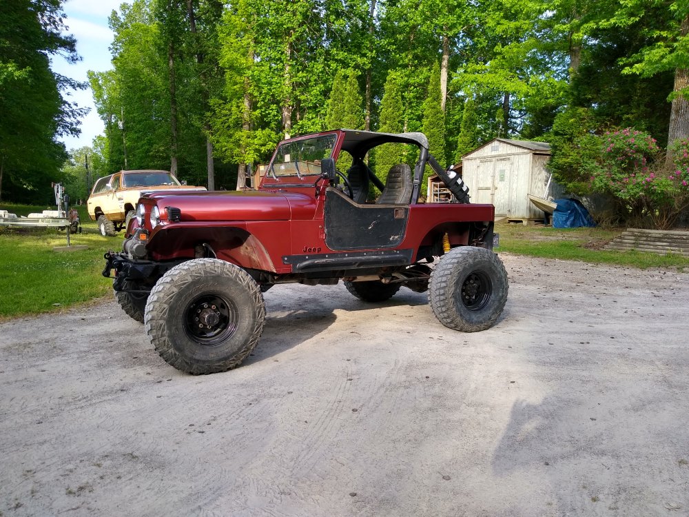

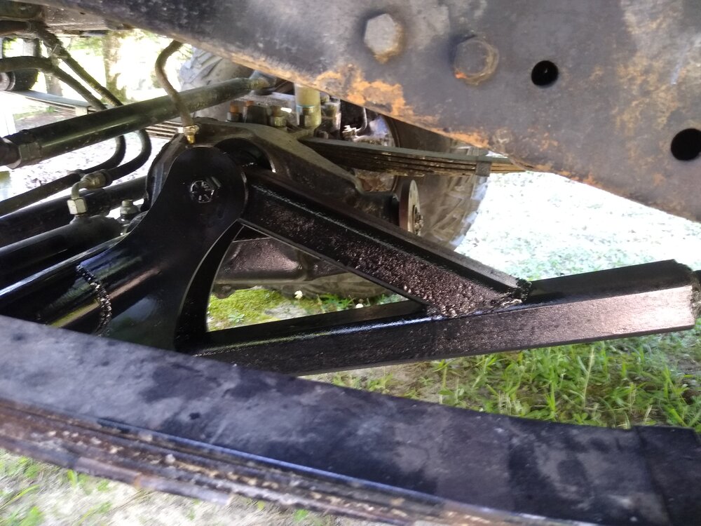

Anti wrap bar goes in and unfortunately stiffens up the squishy rear suspension (still pondering what to do here). Fender triming and redneck clearance test on the goose

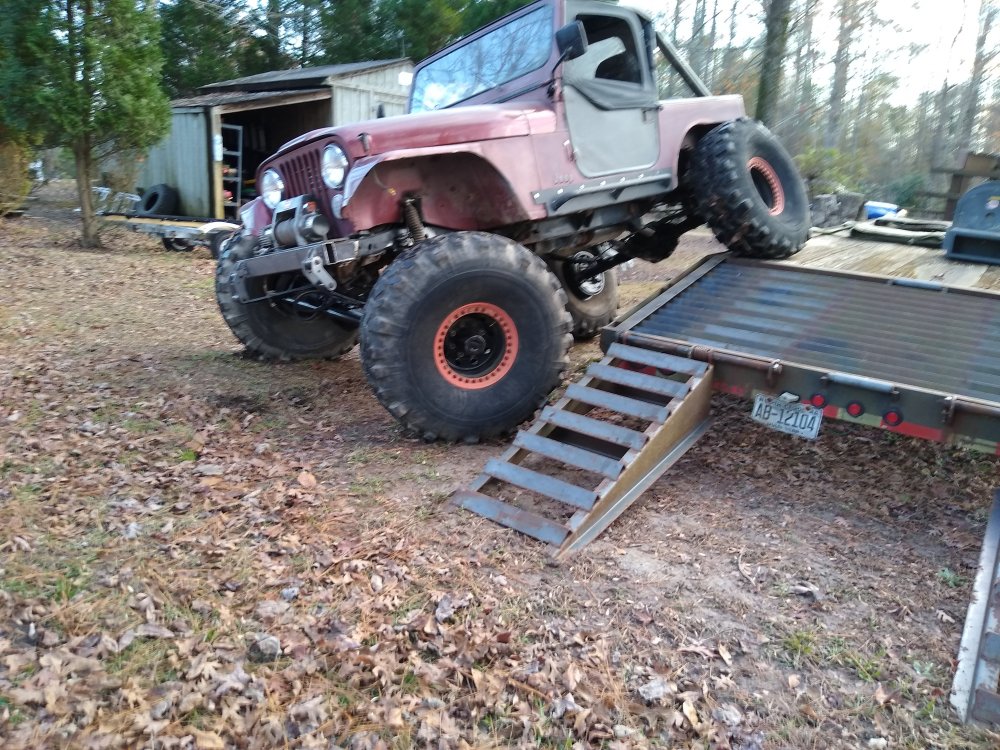

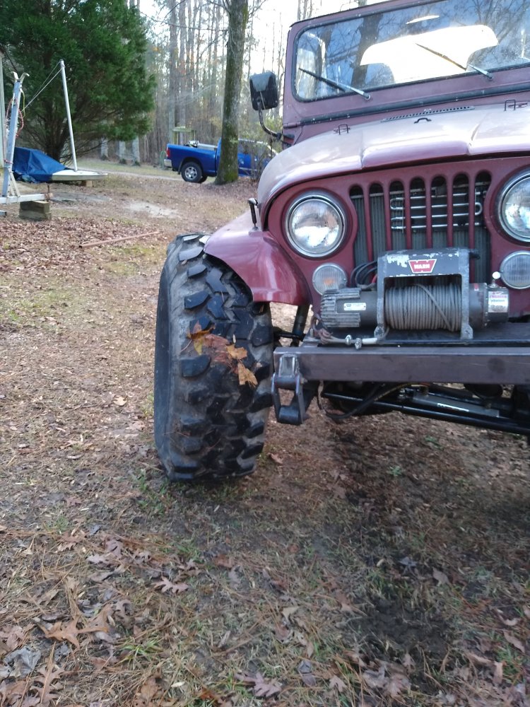

Knobs clear nicely on the bumps and lock to lock. Steering surprisingly clears too, mostly thanks to those handy offset tie rod ends.
It runs down the road straight and smooth - at least up to 50mph anyway. Stops / steers better than it ever has, but it's not finished
Still todo: clean up / properly secure the new brake lines, steering lines, axle vents, install harness seats ( also had those laying around for a few years) and add more roll over protection. Will likely come to terms that 4.56:1 and the cute little Injected 258 just isn't going to cut it. I've got this 440 mopar sitting here... And in my typical cheapo build from surplus / junkyard parts I think these barely used TSL's are 15 years old and hard as bricks so we'll see what happens there.

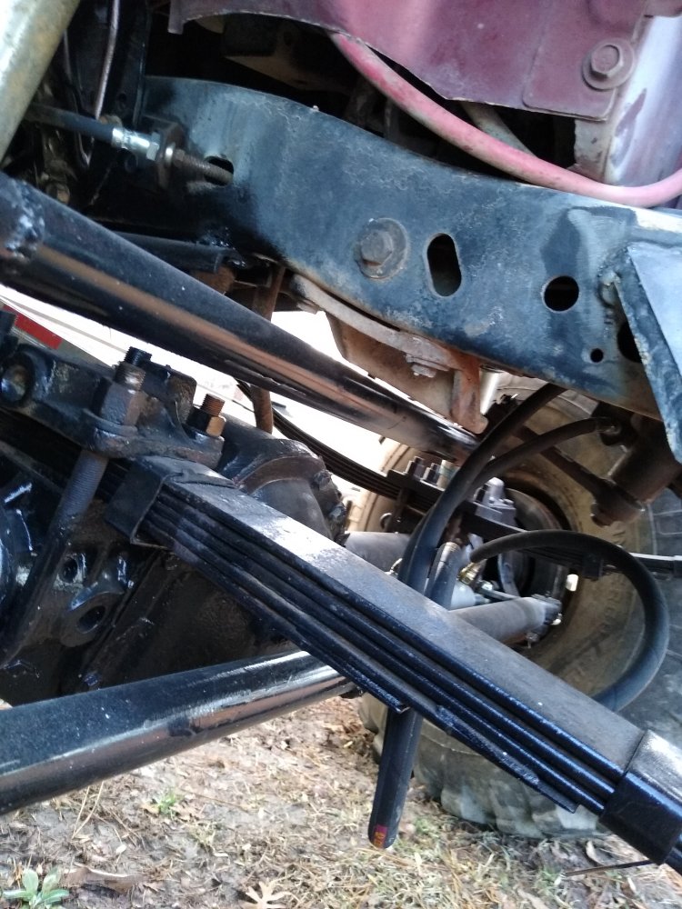

Re-did the antiwrap bar again trying for a less jarring ride. The front seems normal squish with 2 leaves removed from a waggy 7 leaf pack. The rear is sitting on stock xj springs that are FLAT. Shackle angle is near about 45 degrees and it's on stock 14 bolt perches. When I first put the thing together a few weeks ago it felt really soft, almost too soft. Then after sitting on its own weight for weeks it seemed to put itself in a bind. Springs must have settled because the antiwrap bar was binding the bolts. I took it out and drove it and it still felt rigid.
And on this test drive with no antiwrap bar the fan brushed the radiator if I gave it any throttle at all. I cut the top bar off the antiwrap and burned it back in. All 3 bolts spin easily at ride height. Drive it again and I can't get the fan in the radiator no matter how nutzo I get on the throttle. Must be some connection with pinion angle anti-squat torque moment force couple thing going on.
Height to bottom of frame is 24", wheel base is 108" and ive got the front of the antiwrap bar as low as I can without it being a rock snatcher. This thing just rode so smooth with the yj springs and a spring over, and now it rides like a jeep again. Is it just the big shift in unsprung weight or am I missing some trick with xj leaves?

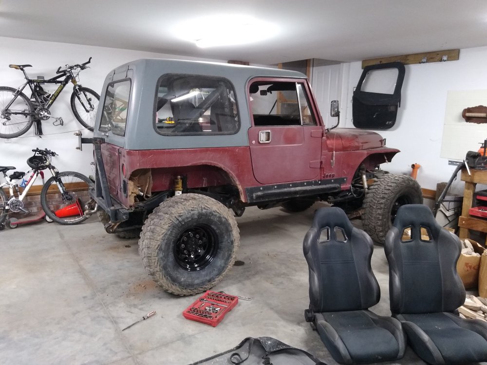

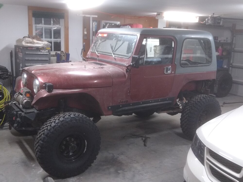

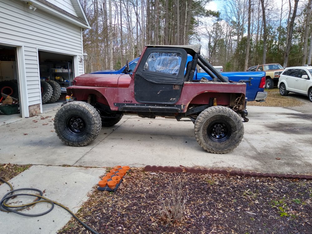

Picked up some "street tars" from @jyaks yesterday and got those mounted. Nice set of 35" mtrs did great on the rode. Speed-o-meter is a good bit off, but it's the first time I've been able to use 5th gear in awhile.
I was so pleased with it's highway abilities being all stable, steerable, and stoppable at lighting speeds (65 mph for an old cj) that I went full winter mode this afternoon with the hardtop and doors. I may even start driving it to work again on Friday's. My daily commute is right at 150 miles so we'll see how that goes...
Dealt with the rear suspension harshness a little over the winter, but taking the hardtop off really pointed out how stiff the rear is. So I started peeling leaves out of the rear xj pack. After four attempts I ended up with the main xj, the main yj (with ends cut off) and the second yj leaf. It's a decent ride but still not as smushy as the soa stock yj's. Must be sprung vs unsprung weight and all that. It'll have to do for now.
Did take it to work a while back and it did fine for the 75 mile one way commute. Wiped her down with boiled linseed oil shine juice and that's an amazing experiment if you've never tried it on old paint I highly recommend it.

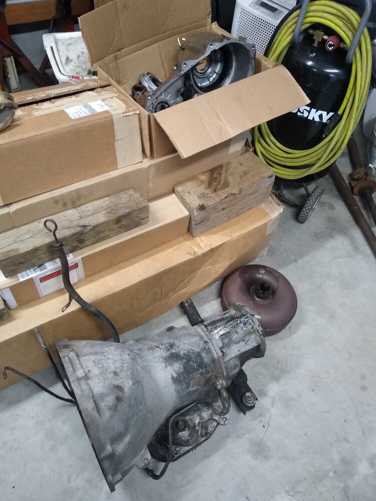

Trans had a leak so I dropped that took it all apart did a reseal, everything else looked great. Put in a new clutch cuz your supposed to if your that far anyway. Changes fluids in trans and the Dana 300 and switched out the speedo gear so it's accurate with the 35's on it. Can street this thing on the hwy at 70mph no problem, really happy with it's ability to sling the 42 swampers on the trail and then make my 150 mile round trip commute to work on the 35 MTR's. I have a lock right to put in the front 60 and three huge boxes showed up with the genright CJ cage I need to glue in. So all systems are a go just using it and building as time permits.

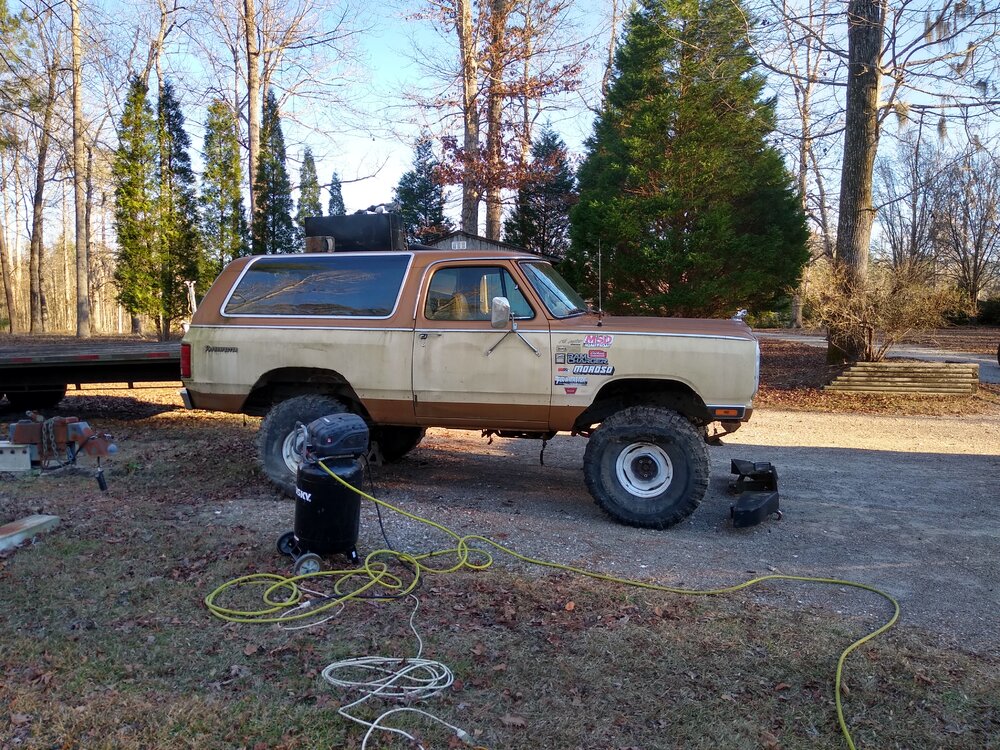

So now here's a newish problem: wife and frankly me too are sick of looking at my old Ramcharger just sitting in the yard. For different reasons of course, but I don't have the funds to make it great again and she considers it an eye sore that she's put up with for 18 years now. (She's incredibly patient like all our spouses have to be with this stupid hobby of ours). So I'm reluctantly going to let it go, but not before I get the 440 and trans out ... Here it is SAD. Keep reading for the transplant plan I need a sanity check...
"Plan" - 440 to Mopar big block 727 (already bolted together in the Ramcharger) then NWF ecobox to the 205 I've had rebuilt sitting in the shop for 15 years. I bought another 727 out of a waggy cuz those things have the shortest output shaft and t-case adapter of any 727. Bought the np231 guts I needed all from Watsons Jeep Salvage just down the road from me. So I need to sell the Ramcharger as a roller to fund the project. Once I get the power plant out I'll do some measuring and figuring to see if the nwf box and 205 will actually fit in the CJ and back up plan is to adapt the 205 straight to the 727. But with a 6" stretch on the rear my initial swag says the nwf box doubler thing a ma bob should work.
Then the 258/T5/Dana300 comes out in all it's fuel injected reliable torquey greatness (this is where I start to question my sanity, but I keep telling myself I can't think of one good reason why I don't need 440 cubic inches of Mopar mayhem in the CJ). So once the big block is in and actually does fit and function with the current Holley carb, I'll sell the injected 258 and it's drivetrain to fund a sniper kit for the 440.
Pretty sure the 440 and gear boxes will fit fine other than the steering shaft and headers. Need to keep it streetable so full hydro is out. That and the cooling opportunities are my current concerns.
Here's the stubby waggy trans and 231 parts sitting on top of the genright cage puzzle.

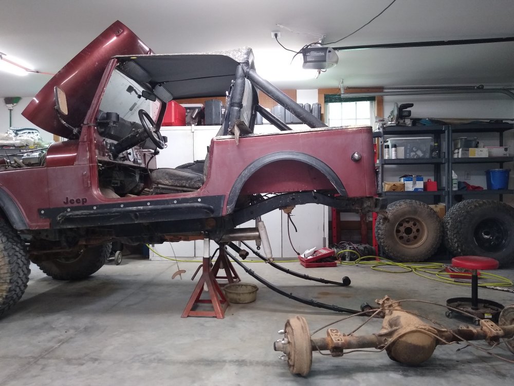

Last trip to the ranch had the front axle twisting all sorts of wrong directions. Ordered another anti wrap parts box from Barnes and put that in today. Mighty tight but got a cross member right in front of the bell housing. Should still be able to service everything, but an antiwrap up front is just going to be short. Got the wrap shackle right at the rear spring eyes - supposedly that's good enough until I get around to linking it.
Flexed it out on the gooseneck, doesn't seem to have effected any movement, and it sure stops better now that the springs aren't rolling up.

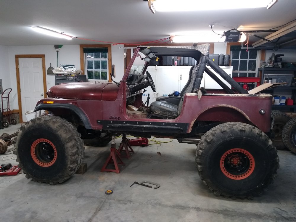

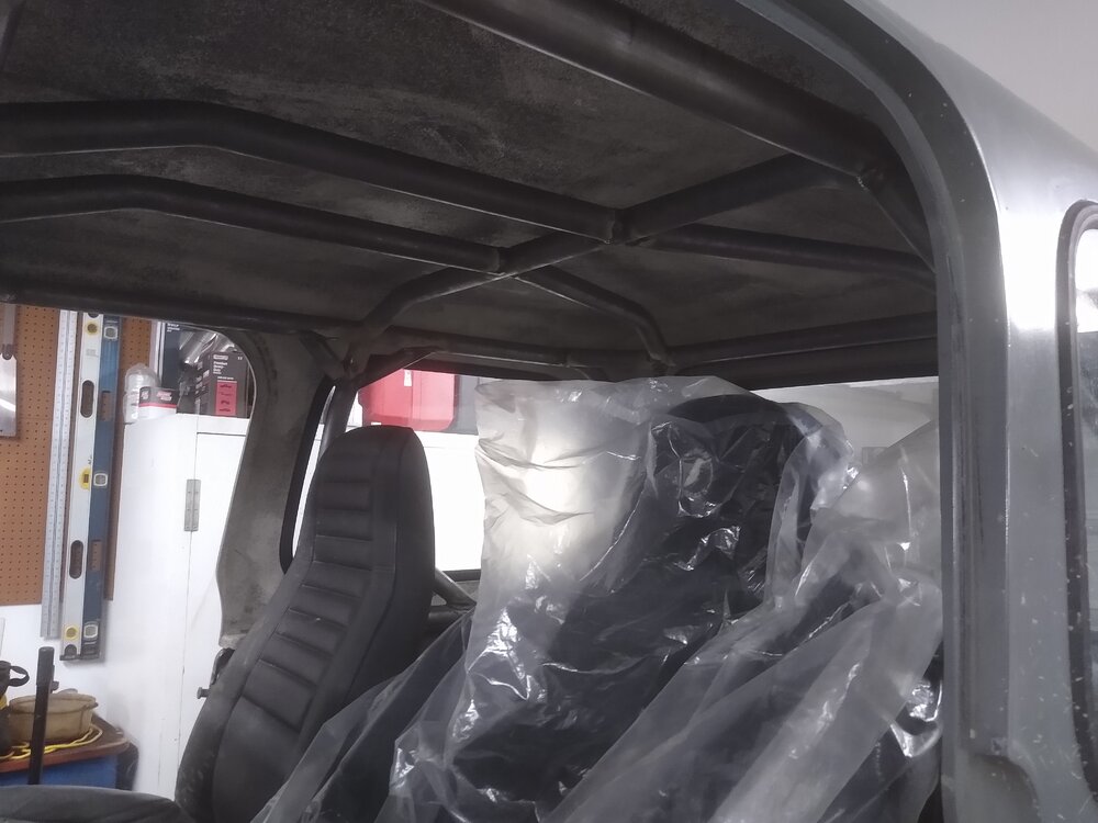

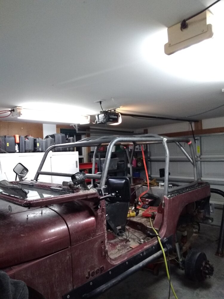

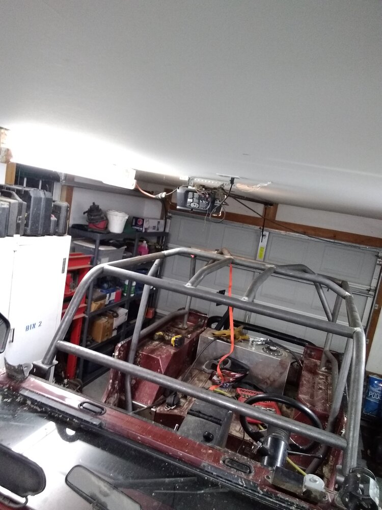

I ordered a genright full CJ cage about a year ago before metal prices went nuts. It's been sitting in boxes up to yesterday. I was dreading the prep work of pulling the dash and straightening up all the wiring. But did that last weekend. Rebuilt all the heater box stuff and installed new cable things so all that works like it should. Added a couple new switches for lights and buttoned it back up...

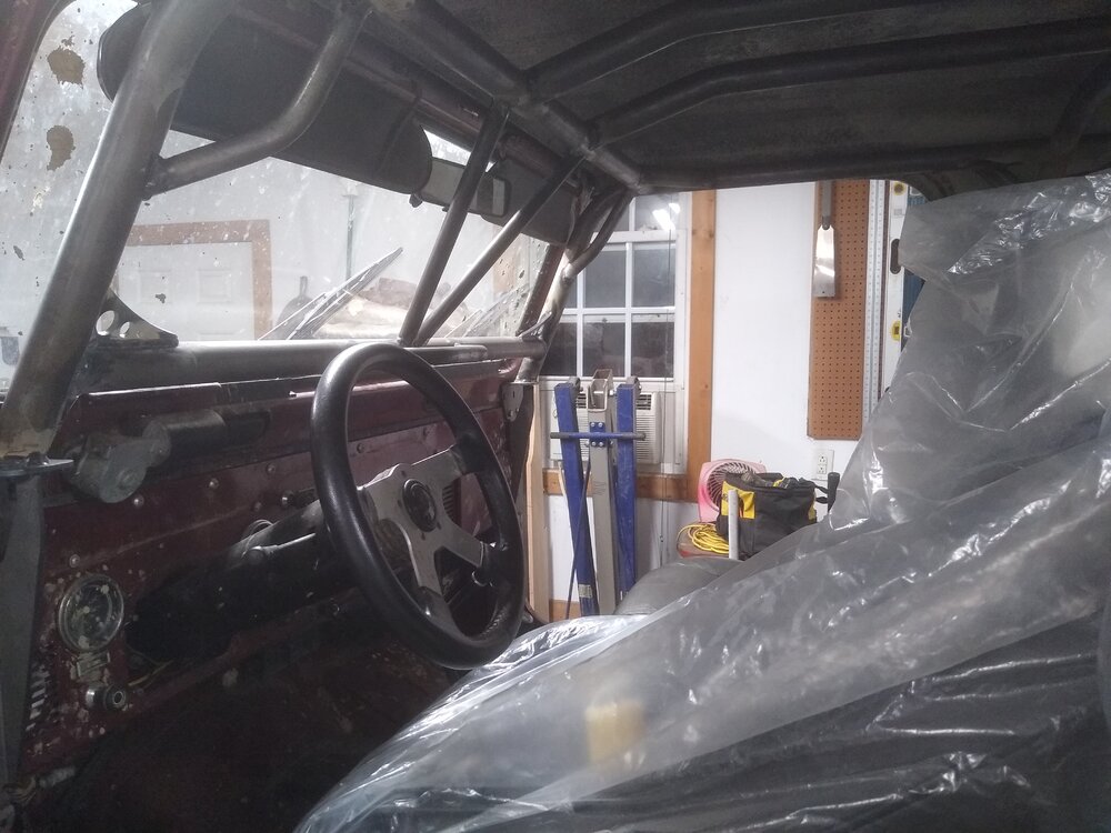

Then the cage went in last night. I will say this kit is very well done. Tacked it all in single handed in about 4 hours. No cutting or grinding required.
I'll test fit the hardtop then burn it all in, and add all the gussets. Have to pull it out for paint, reinstall and then modify the forward side of the hard doors so they close with the new a pillar support thing.
Picked up a complete AC system from Watsons last week too. That's got to be pressure tested and then installed, but it's winter so maybe later.
Cage is all welded in. Took more wire than I would have thought. But the hardtop fits.
Did some minor clearance on the a pillar plating so the hard doors fit

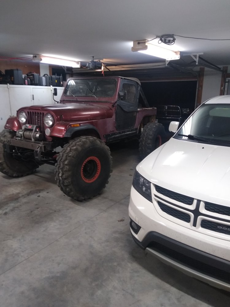

Mounted the new 35 Falken MT's for the street and light trail duty. Still running the 42's for the fun weekends
