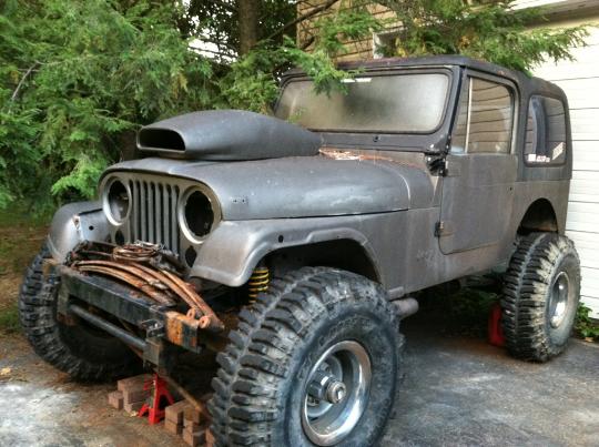

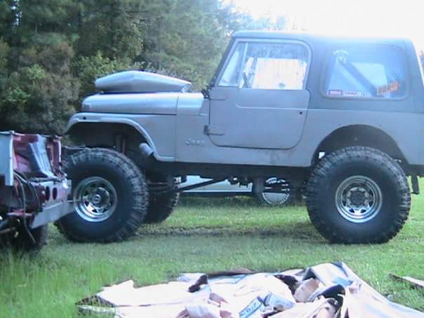

CJ7 junk yard parts bin on 42's
Not sure about with a 440, but these were with a SBC in a CJ.
Later on, he cut the collectors shorter and sorta ran them under the tub. I think you could make it work, pending finding some, and tuck the pipes near-ish to the frame. Bad angle, but you can sorta see how he did it.
I remember when those hood scoops used to mean serious business.

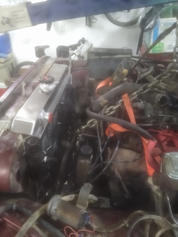

New rad actually fits perfect, I can hardly believe it
Figured out where the engine needs to go, tried some custom header mods but that didn't work. Even though there's 1,200 pounds on that jack and I used heat it wouldn't budge.
Gave up and ordered a set of shorties from summit, no idea if they'll fit but what I got isn't working. All into the steering shaft and the collectors are in the frame both sides.
Mocked it up with the tcase loose and rotated it flatish to use the the Barnes skid. Front shaft would be all into the trans pan at anything past ride height. Plus I'd have to get a longer input shaft, got plenty of spline engagement but the sealing surface wouldn't be in the seal in the tailshaft adapter. Thought about drilling the Dana 300, but then I'd have to grind the mess out of the trans and you just can't get those big block 727 housings anymore so didn't want to risk it. I'll flat belly the thing when I do the black box and 205, but for now I'm trying to hold a budget.

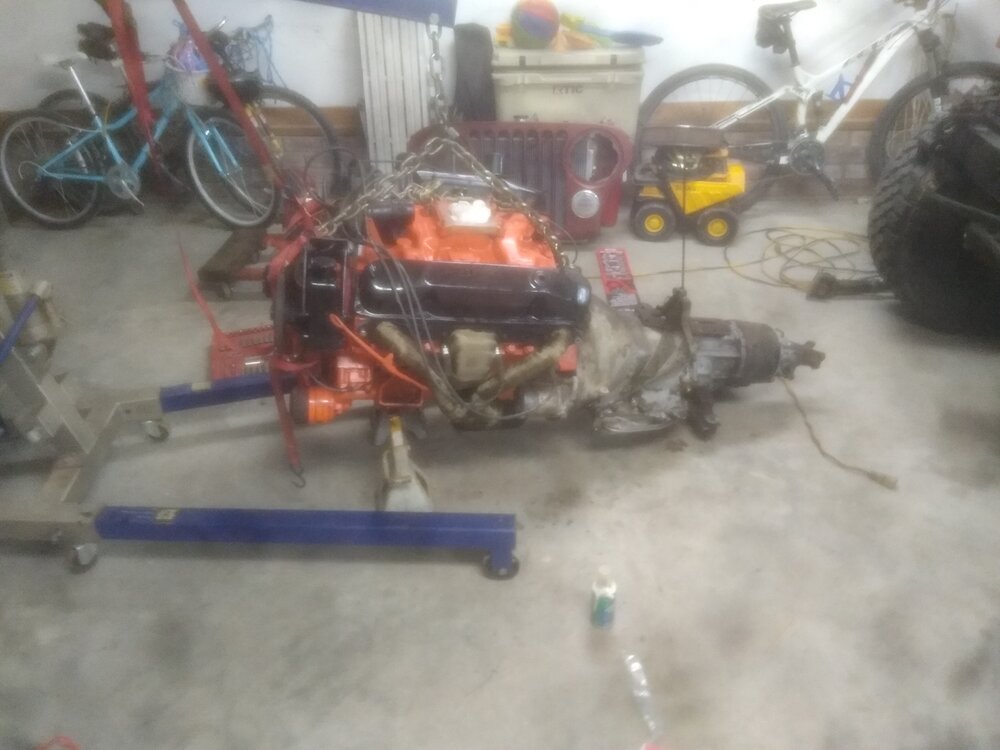

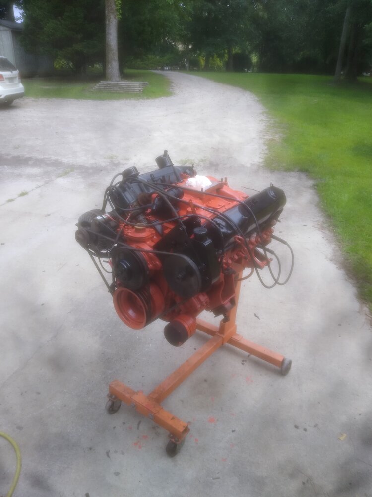

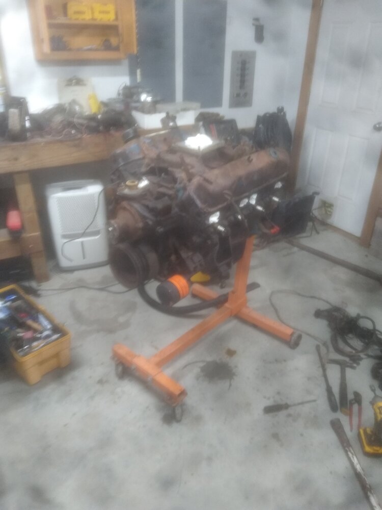

I did "rebuild on" the 440 though. Before:
And after the VGG Craigslist rebuild... she's brand new fellas in Chrysler orange:

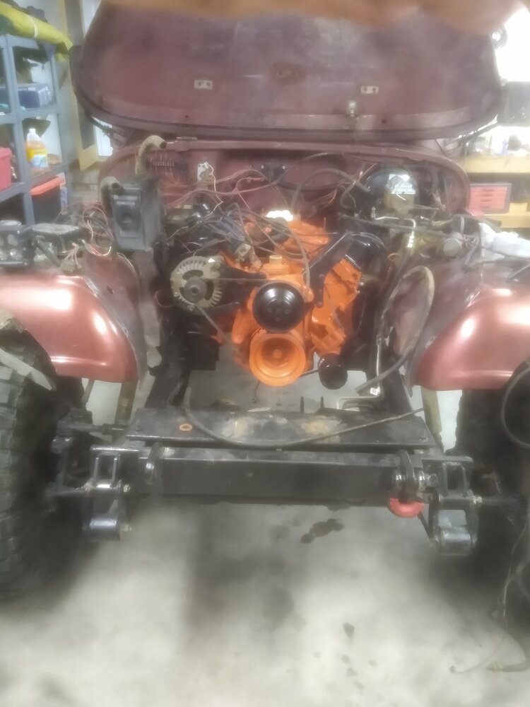

Degreased the engine bay and pulled all the old Mopar MPFI stuff out to sell and recoup some dollars hopefully.
Hopeful that this weekend I can fab up mounts and the new headers I ordered actually clear everything, and I'll be able to fire it up.

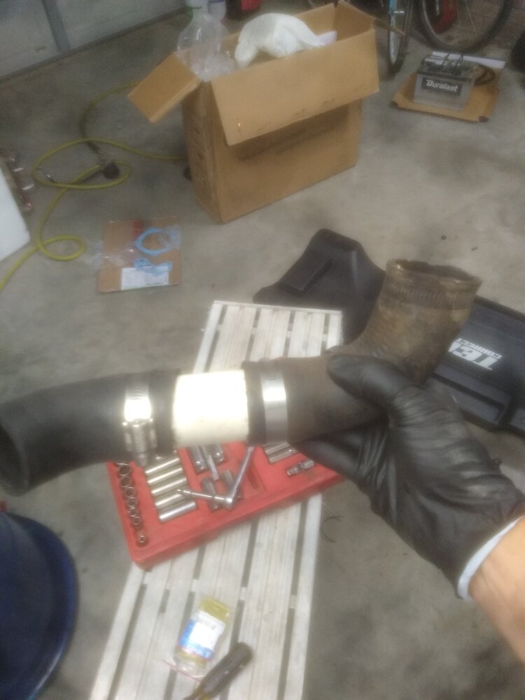

Replaced PVC lower rad hose spacer with aluminum tubing. Yes I tried multiple different flex hoses and none of those worked.

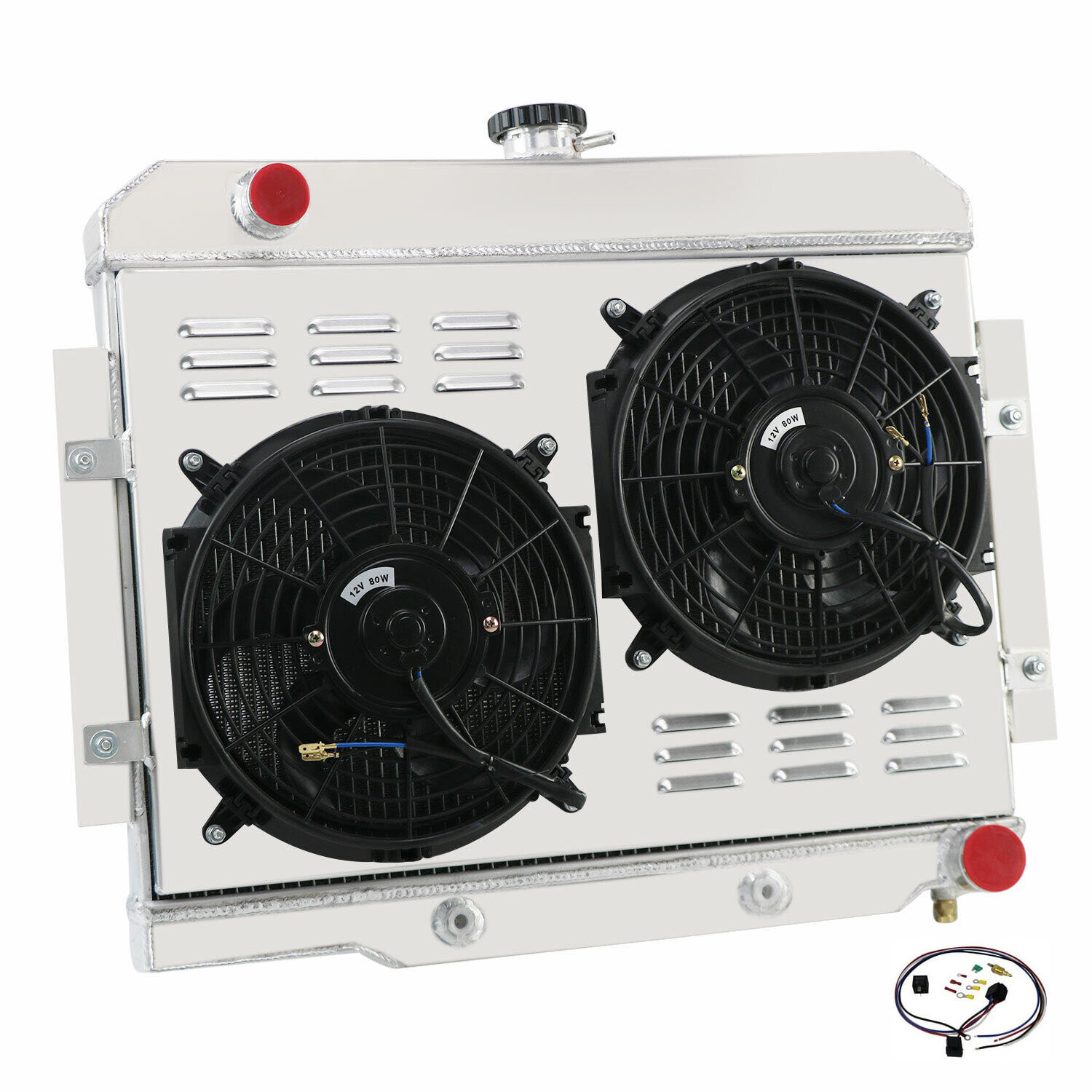

I think I have to little air flow from the two dink 10" puller fans that came with the rad. Its a 4 aluminum row and I have a trans cooler and ps cooler in front.
So what's everyone doing for cooling that has bigger power under a jeep? What fans are you running?

Overall things went well. Only real problem is its carbureted so bumps and inclines are not it's favorite, but biggest challenge is it gets hot. I would see 220 while on the trail crawling up any sort of slope and had to stop, open the hood and let it cool down. Took the hood off in the afternoon and that helped a little.

I could be wrong, but I would wonder if the fans are pulling air in through those vents in the shroud? That could be limiting the amount of air flow its pulling through the radiator.
Volvo radiator fan and it's OEM relay flat out works. I was able to cool my 11:1 306 with an OEM 3.0 V6 radiator for years and years with one. It uses the same motor as the infamous Taurus unit. But with a separate fan/motor from the shroud. Makes it easy to mount and control.
Google Volvo fan conversion and you'll see all the model info. Pretty much late 90s-mid 2000s Volvos is the application. Grab the fan, relay and wiring. You'll only need to hook up a power, ground and signal to the temp sensor/switch.
Have you tried any aftermarket/replacement volvo fans? I know the Taurus replacement fans/motors arent near the same as the factory ones.
