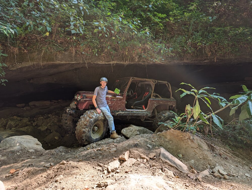

Ran more double blacks today. My son drove most of them, which might be more rewarding to watch and spot him make it happen than me driving through. Got mostly vids, but here's the honorary trail 90 shot.
He never had to pull cable, but I did on trail 94 to keep from losing the windshield.
Got to the top of one trail and reached for the shifter and it was in the passenger seat... Roached another set of engine mounts.
Heading home in the morning, great father son weekend in a rig we built in the garage over the past 6 years. He's going into his senior year in a few weeks. I'm sure there will be many more great trips just like this.
