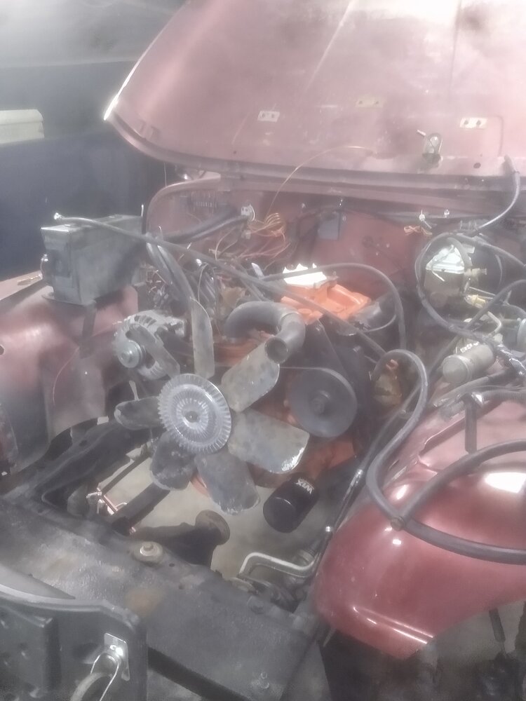

Finally had time to wrench and got the trans , t case and engine bolted back together. Little man and I got her back in last night - super tight with the exhaust in the way now. Hope to wire it back up and make all the other connections today and get it running.
Twin sticked the Dana 300 while it was out to. New gaskets and seals on everything... IMG_20231222_192845908.jpg
Got it connected enough to run. Rolled over once and then lit off just like it ran yesterday. Now for driveshafts, fluid top offs, run the light harness back through the grill etc.
Ordered a sniper 2 for it yesterday. That'll be here next week. May run the carb for a week or so and dump some B12 down it to clean all the gunk out before installing the EFI.

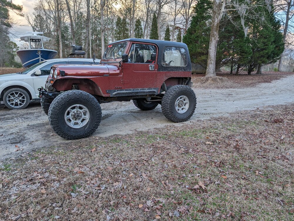

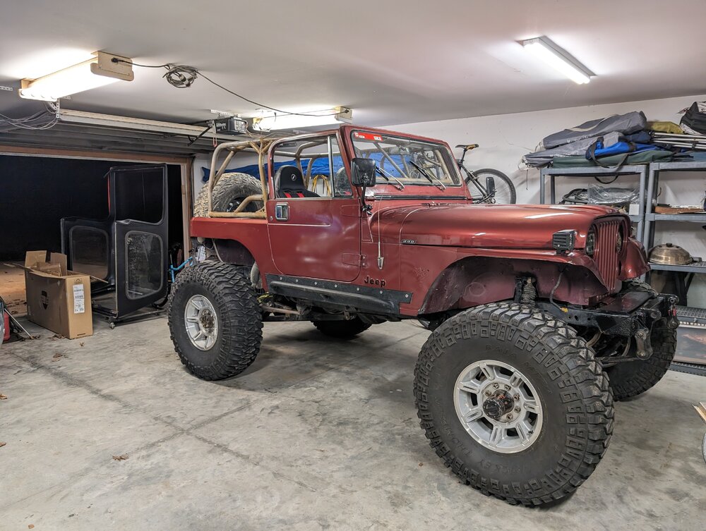

New tires and wheels in way of 40" Mickey thompson MTZ's that @Croatan_Kid found for me local, and some new H2 wheels. Plan is for this to bring the rpms down at highway speeds. Still run the 42 TSL's on beadlocks in the woods
And smeared from VGG gloss shine juice clear coat on it. This stuff is amazing, we're talking @CasterTroy tire shine level of gloss. Literally took 5 minutes, wiped it on and it laid down flat. If you have some faded out old rig that you want people to wow at this stuff if the deal. Only regret is I mixed about half the can and had twice as much as I needed. So without any prep at all I cleared the undermount boxes on the gooseneck and even those look amazing.
Drives great, went for fuel and ran 60 easily, tires are louder than the 35" falken MT's but run just as smooth.
Pic doesn't show hardtop or lights but whatever...that happened the next day. Tires fill in the fenders much better than the dink 35's and daily driving 40's is the deal.
Drove it to church today. Runs 70mph easily, straight and smooth. Not sure mpg is improved with 40's but rpm is down. Speedometer is way off. 55 on the dash = 70 on the GPS, need to get a different gear for the tail shaft. Rear main is really puking, can't ignore this one. Have to do that again next weekend... uhg.

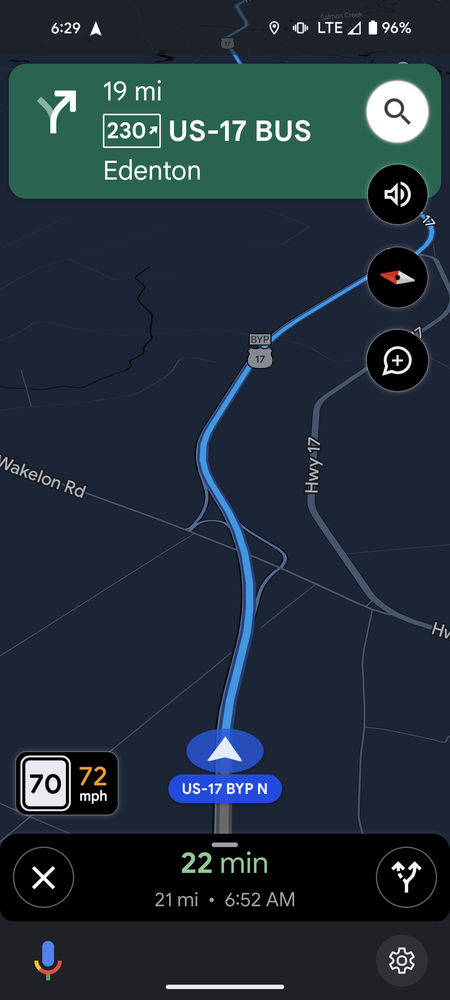

Drove it to work today since my son needed the ram for other projects. My commute is 75 miles one way. Haven't regeared the speedo for the 40's but this is at 55mph per the speedometer:
Nice and smooth at 10mpg... at around 6:30 am

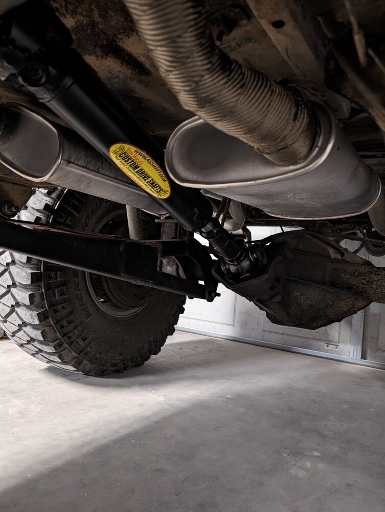

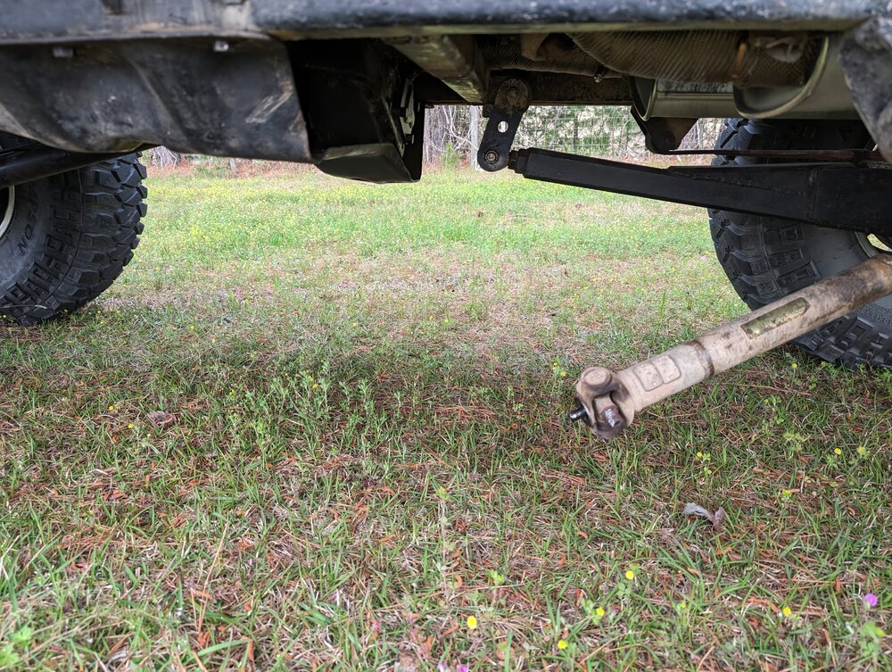

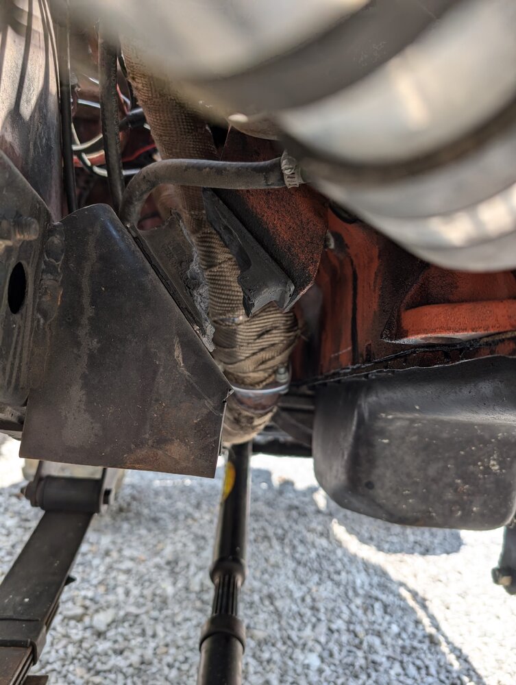

Well sort of. Had a noticable driveshaft hum at 70mph. This is the rear shaft that got pretzelled in Bear Wallow a few years ago and got cobbled back together on the side of a mountain. Ordered a new one today.
And this just happened on the way home...
Felt it start going at a light so pulled over before it did any damage. A few forward-neutral-reverse cycles and she dropped out...
New shaft runs smooth...
Changed out the speedometer gear also so that's more realistic, and put the dust cover back on the trans bellhousing now that the rear main is dry - finally.

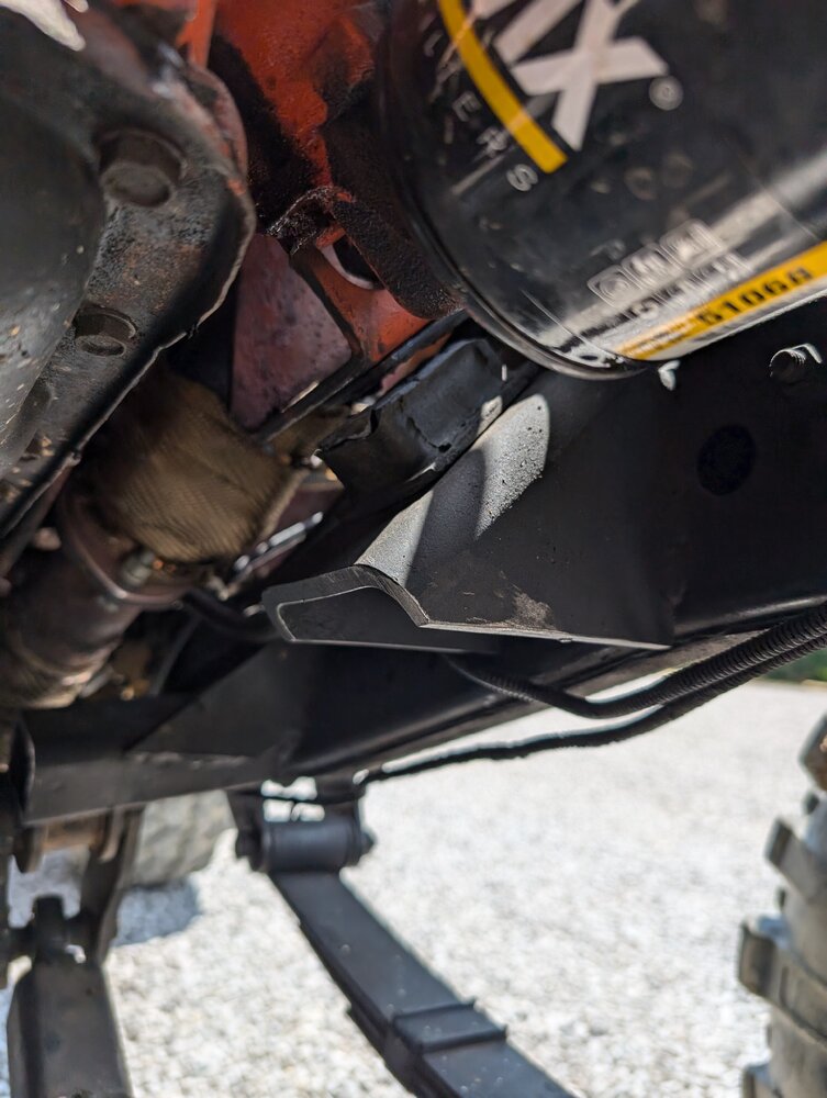

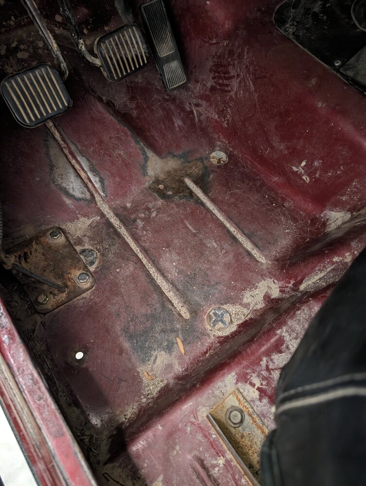

Considering putting some dynomat or similar on the bottom of the floor (frame side) to keep the heat down. I wrapped the exhaust and that helped some. The floor pans are original and I like the originality of the bare floor and don't want carpet on the inside. But don't want the stick on dyno mat trapping water / mud and rusting the tub out from the bottom side Any thoughts/ suggestions???

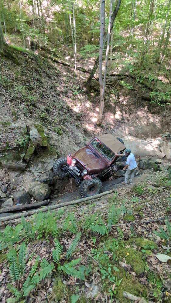

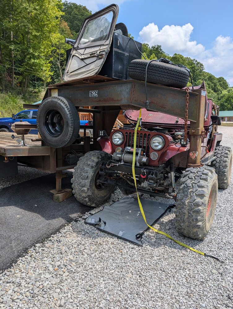

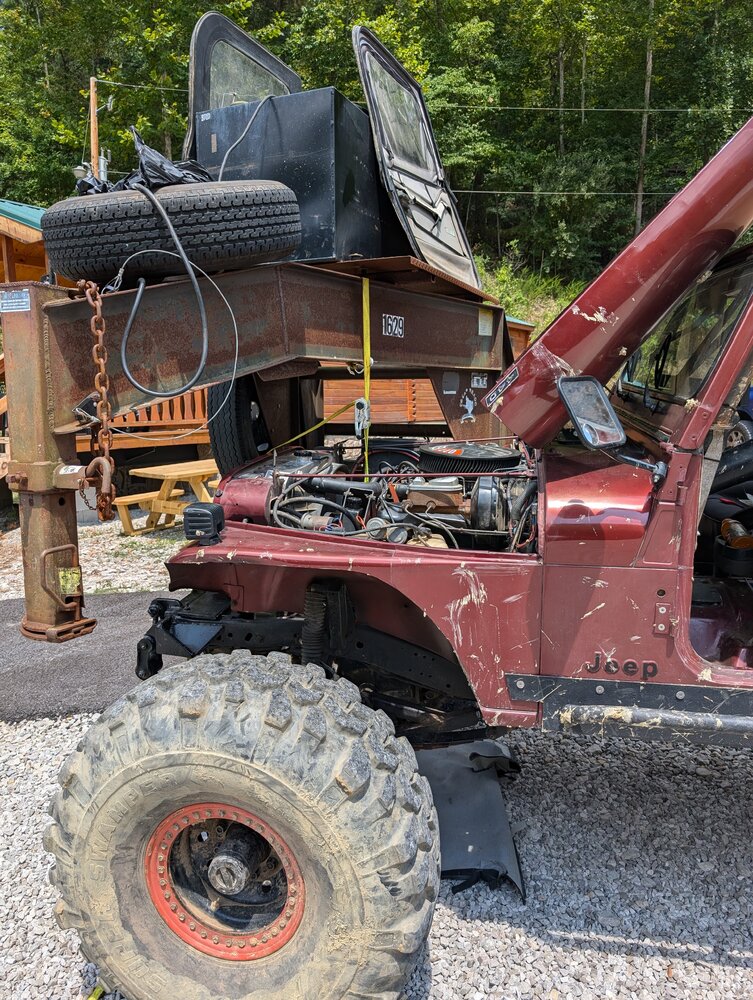

Making out way up a green a black then another black to get to the "90's double blacks". While on black trail 71, working up a very dusty incline theres a few small rock shelves spaced the same as my wheelbase. Procede to "bump it". Then more throttle ... BANG CLANG SLAP FLAP FLAP FLAP. Tore both motor mounts apart and the 440 is leaning to driver and the fan is self clearancing the shroud. (Fortunately this is the shroud out of the donor Dodge that is in about three pieces now and held together with tie wraps so it's rather "flexible" and the only other casualty was a few tie wraps). Ease it back down, take some greens back to camp while calling local parts stores. Find a pair of mounts up in Charleston so head out to pick those up and an engine lift. My son, Johny, has the genius plan to use the neck of the goose to hoist the engine so we can return the lift unused.

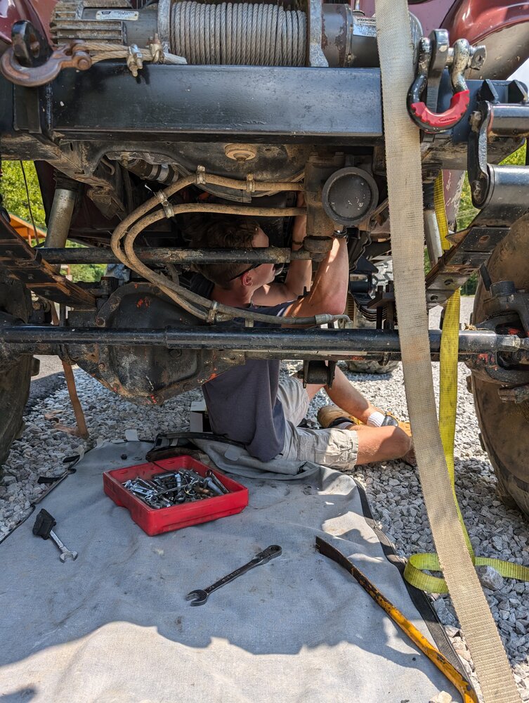

We had four or five straps at various angles and lift points and he was under it telling me which way to lift. He's always been a good wrench, but I was very impressed with his ambition and MacGuiver skills
These mounts were about a year old. Replaced them with the same stock junk and were back on the trail by 2. However the new mounts are about shot again, I really need to fab mounts that use leaf bring bushings instead of these.
