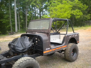

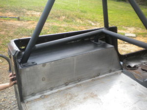

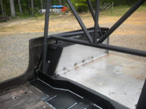

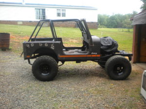

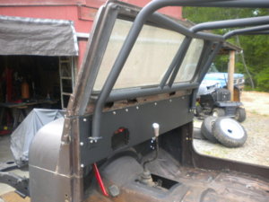

Well since PSN is down I have had some time to kill :) . I finally figured out how I was going to tie the cage to the body. I cut it down a little bit because I couldn't mount a seat to the under bars because my head would stick through the roof. I made a dash panel at work out of .100 material.
