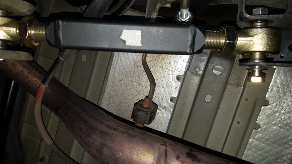

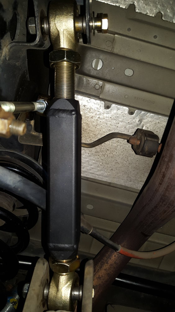

here is my issue... needing to adjust pinion angle on rear.. UCA has jj on both ends..currently they measure 13.5 from center to center.. we loosened the jam nuts, turned the UCA 6 times and it still measured 13.5....we did this in both directions.. so I adjusted the UCA all the way to the Johnny joint on axle end to see if measurements would change, nope, still measured 13.5...is something in the UCA built wrong....this us my dilemma... it's so frustrating because this is the only thing that I had left to do today to get it back on the road just needing some input and Clayton Off Road is closed today for me to call them so that's why I was asking...

Yes that is what's happening whenever one Johnny Joint goes in the other is coming out to me it sounds like I have both right hand thread Johnny joints
You can make it work if you take one end out, adjust both joints to the length you want and reinstall

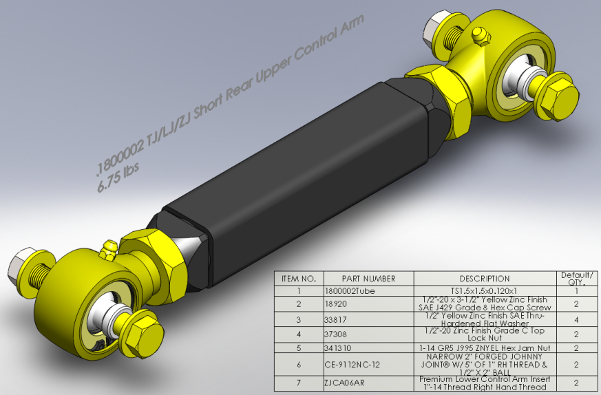

I went back and looked these arms up, they show it having two RH JJ. Guess the fuckwits don't have LH taps or something.
Clayton offroad and saves money don't belong together. Their shit is way fucking overpriced for what it is.
Those are welded bungs. You just buy the LH ones and weld them in.
