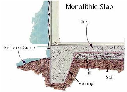

If it were me, I'd add a few bucks for a turned-down edge. You'll have less reason to worry about cracking or frost heaving or termites or anything else long-term. Spread footing and stem wall will be more expensive.
Turned down footers for a simple shop like this will be much more cost effective and easier. Throw a couple #4s in there around the perimeter and you have the foundation and floor all in one. Simple and easy.

Here's what we're talking about with the edge:
monolithic-slab-diagram-jpg.16340
Throw a couple of bars in the bottom of the footing about 2-3" up to help with any subsidence issues and make sure the subgrade is clean, well-compacted, and free of organic material.

Thanks. Would I trench all perimeter or just sides for 16' wide x 20' deep pad?
My backhoe has 24 " bucket.
Would y'all dig trench by straddling (square trench)
Or
Dig trench from inside pad area making trench beveled like pic?
Thanks
What kind of backhoe? I might have a 12" bucket that fits it. Doesn't have to be perfect for what you're doing and I definitely wouldn't dig a 24" footer.
It's a cat 416b. Thanks for the offer but I think I can make a vertical down cut and then drag back maybe a foot and bevel up and out. You know what I mean:)
Still wondering if I need to trench entire perimeter or just right and left side?
All the way around
