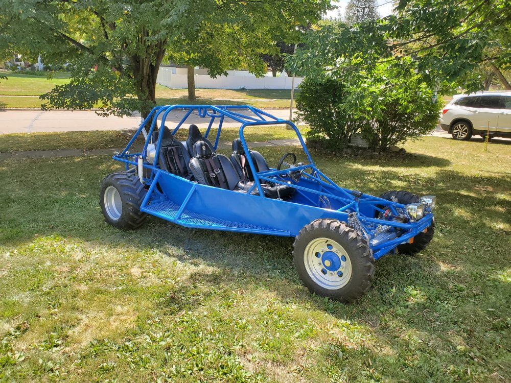

I'll apologize up front. I'm not sure if this topic has been covered already and for my lack of knowledge on the subject. I have VW, late 60s, rear engine rear wheel rail buggy. I've been looking into transaxle's and really want to make it 4 wheel drive, but I have no idea what I would need beyond the transaxle. I can't figure out what kind of axel / differential I would need to install up front, would I need a custom drive shaft to fit the buggies current layout (4 seater)? Looking for any helpful tips, advice, places to buy parts, ect.
I use it mostly for trail riding in the woods, almost all 1st gear riding, rarely 2nd gear, so top speed isn't a priority. The engine is 1776cc on a beetle car transmission.

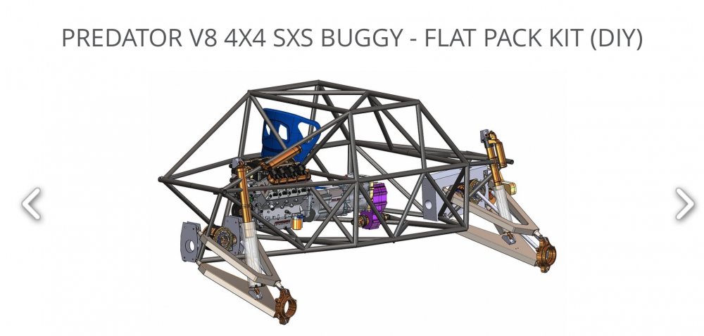

polaris RZR 1000s come with 32" tires, rear engine, 4x4. check out their drivetrain to see if you could steal any ideas... this image is from proformance.com.au
