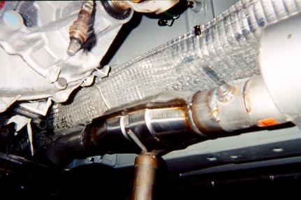

The floor of my xj gets hot as sin. I'm planning on wrapping a few sections of the exhaust but I'd also like to put some sort of insulation on my trans tunnel. Any reasonably priced suggestions? I saw a few types of sticky backed insulation (mostly sound deadening material) on amazon and ebay but the floor gets super hot...might turn that into nasty mess.
A radiant (reflective) barrier with an insulating layer is usually the ticket. There's a few on the market with aluminum faces that are formable, and a woven fiberglass insulation layer. They're made specifically for trans tunnels and things like that, with a high temp adhesive (I think like 450 or 475 degF for the DEI brand).

Not sure if you are on the cheap side but my WJ has a pretty impressive run of reflective material between the exhaust and then floor from front to back. It’s held up pretty good after 20 years. Might be worth a shot grabbing one or two at the pick n pull.
I'm running lizard skin ceramic coating. It actually works really well. My cat is right under the passenger floorboard and it only gets warm.
