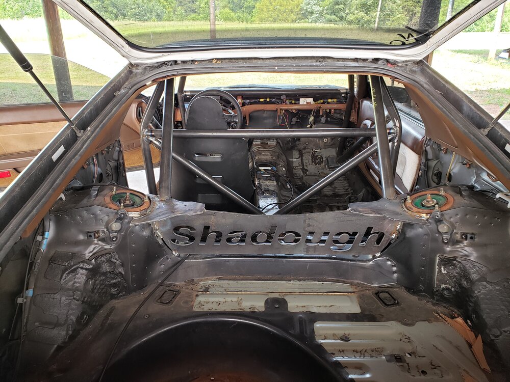

Had the pleasure of installing this cage in this boosted supra, hes pretty stoked with the name plate being the rear tie in and as strut bar!

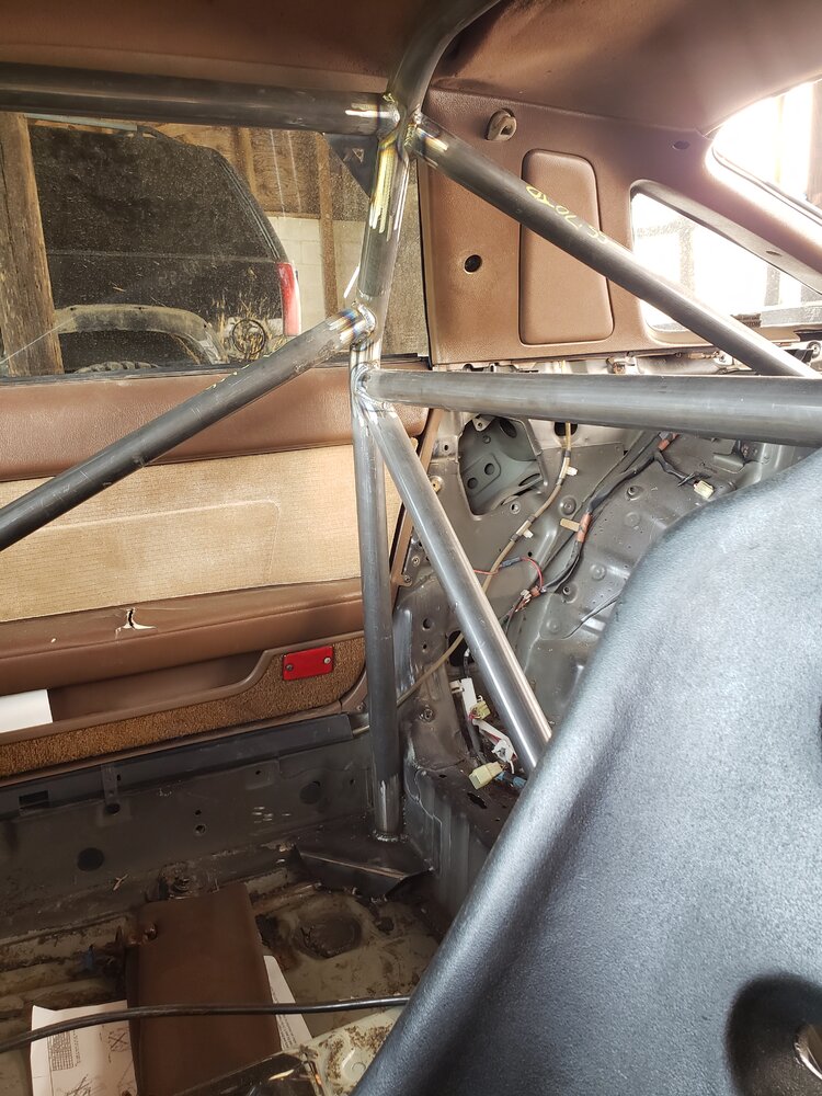

Isn’t the door bar supposed to hit at the point of the cross bar? @Jody Treadway am I remembering that wrong?
according to instructions, it's suppose to pass between shoulders and elbow at some point...that was all it gave so this is where we landed. That was all that was mentioned for proper installation per "rules"
Rules may not say it has to land there but physics, and shear forces say it would be stronger if it did. Looks almost like the B pillar should be laid back a bit to match the B pillar of the car. That would use the extra length in the door bars. But I am sure the A pillar and bars have already been cut.
Nodes, man.
that might be true and I'm sure there are "better?" ways to do it but I just followed instructions that came with it designed for this car specifically and rolled with it. Customer did his research and bought the kit for it and I didn't really have much say in the design. It was my job to cut and notch everything to fit nicely in place according to diagrams provided and burn it in carefully.
