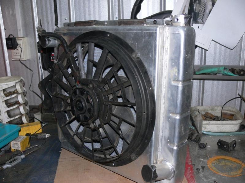

My Ranger up until this winter had the following engine and cooling mods:
400+ HP 306, 10.7:1 CR, stock type water pump, 195 t stat. Doesn't run hot even on prolonged beat downs. It may stay warm (220-225), but doesn't overheat. What magical radiator was I running? Stock 1999 3.0 V6 rad. But with a nearly fully shrouded Volvo fan and 2 speed controller. They flat out work and are easy to package.

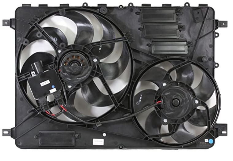

Dual Radiator and Condenser Fan Assembly - Cooling Direct Fit/For 306686296 07-15 Volvo S80 3.0/3.2/4.4L, 15-16 V60 3.0L, 08-10 V70, 10-15 XC60 3.0/3.2L, 08-16 XC70 3.2L​
[Amazon product ASIN B07FNW6T88]
1) Dimension of it?
1)How thick is it at widest point ?

You need a used OEM fan, the replacements from china are junk.

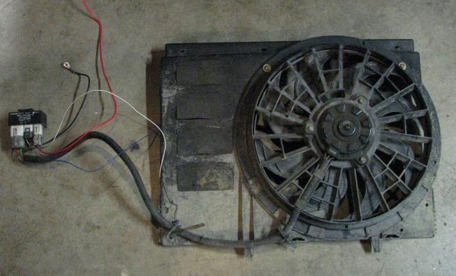

Volvo 740/940/S70.
Make sure to grab the relay that comes with it.
It's about 17" in diameter.
Looks like this (with the relay you want to keep).
You can unbolt it from its shroud and bolt it to any flat shroud of your choosing.

The taurus fan and the volvo fan are the same thing. But the volvo one has a detachable motor fixture which makes it more desirable and easier to fasten to a fabricated shroud like I showed up there.

It is not. Double wound motor which enables the 2 speeds.
If you want to go with a brushless option, there is plenty more tech to add, but I figure we'd keep it simple for this CJ.

I will reiterate that your shroud system is less than ideal. 3/8 gap is a massve air gap. You should have 0.00" gap. See pics or properly constructed shroud I posted earlier in thread.
I cant say definitively (no one can with info provided) that it is your only problem, or that eliminating it will solve your problem.
But think of this in terms of water flow vs airflow...and air will go through smaller cracks than water. If you are sized "marginally" and you need every last drop of air to cool...and you have a 3/8" gap, just imagine home much air efficiency is being lost.
Its like pouring water through a perforated pipe into a bucket.
