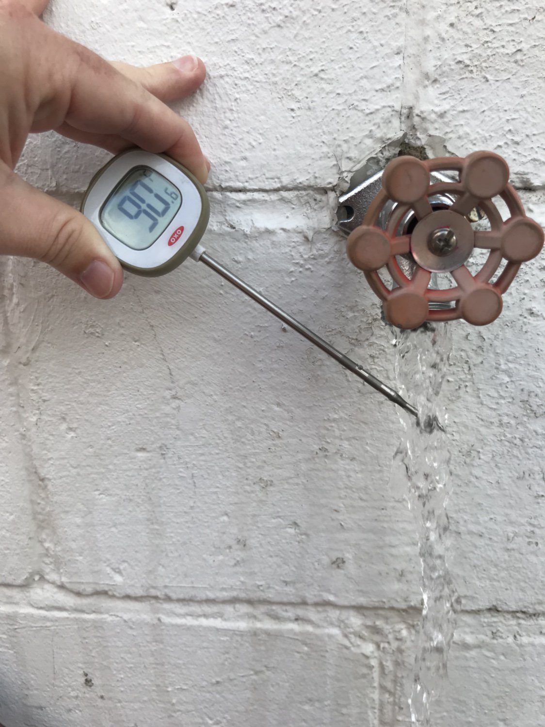

Water line is underground from meter till building. Comes into building into conditioned space, about 4’ into building is where we get these temps. Not just my building but next door building also. The town has told us the mains on our side of town are not deep enough and the tower being so close doesn’t help. We have verified water temp with 10 different thermometers also. It is noticeably hotter than my house with well. Definitely not pulling off water heater, the shop is all exposed plumbing so easy to tell it’s not coming from WH.
Elkay says the 32gph chiller should have no problems getting the water down to 72* from 90*. Even flowing straight through. Especially if it is installed in conditioned space.
