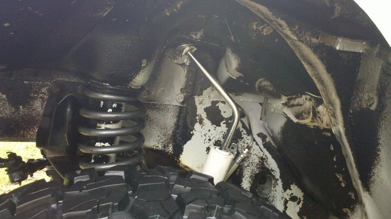

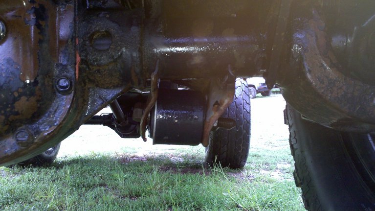

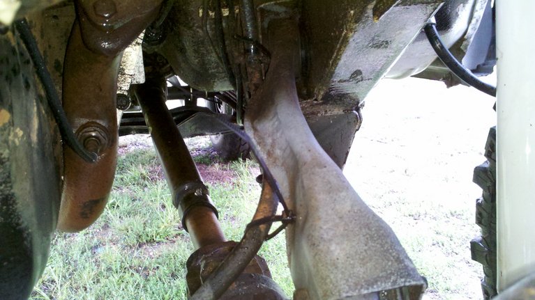

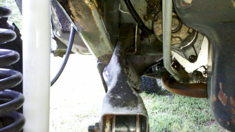

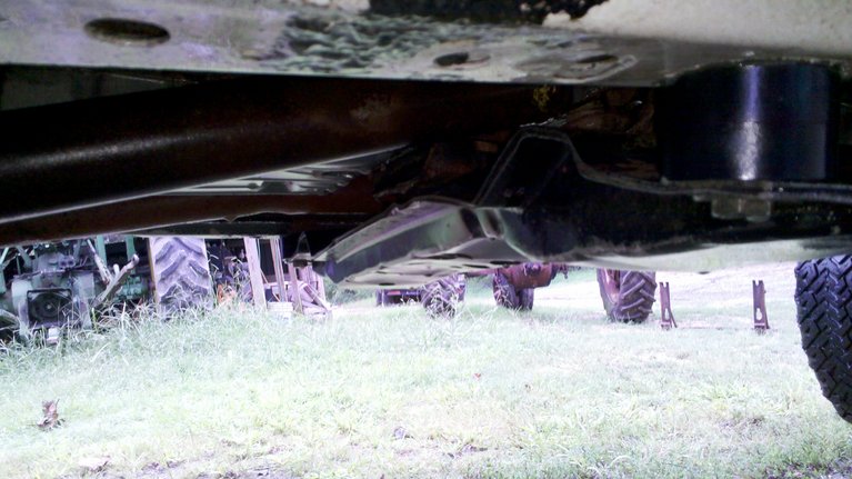

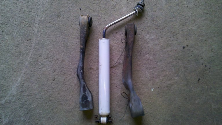

Bent both of the UCA's a LCA axle bracket and the drivers shock.
Bent my trans xmember up about and inch which cancels out my inch tcase drop I have on there now.
I'm going to make some upper links with DOM and heims and replace the LCA brackets with some thicker stuff. Then I need a sye and build a stronge xmember.
