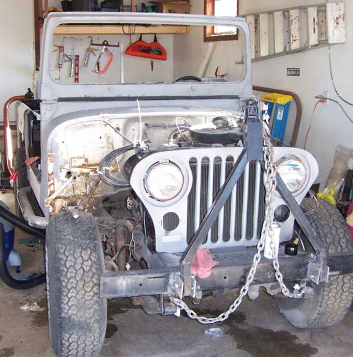

The last one I had done was a rolling chassis 76 CJ back in 2005.
I had Robbins Sandblasting on 109 here in Winston-Salem do it for me. He used sand (not media) and their facility is outdoors in the back of a junk yard. So NOT a world class finishes expectation.
It cost me $200 and took them about 3 days to get to it. I took them the stripped JEEP less glass, lights, etc. They did the body inside, out, and under.
This was the second vehicle I had taken to them to do.
No complaints. They would have primed it after blasting if I'd wanted.
Advice: Whatever you take, strip all the way down. I.E. If it's a whole vehicle remove the motor/trans, axles, glass, everything that's NOT the metal or you can expect damage, and or infiltration of sand in every single area. If you take a rolling chassis, expect sand in the differentials, axles, and the bearings to be shot. On the trip home, be sure to hit a road with a great deal of potholes and or washboard surface to shake all the sand out of the areas. When I took my 62 chevy stepside I was still getting sand dropping out months after I brought it home every single time I'd close the doors.
If you're taking parts, disassemble completely.
Sand from Sandblasting anything is like giving a 5 yr old a 10 pound bag of glitter and a red bull. It's gonna be everywhere
