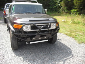

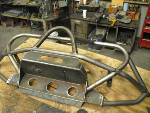

Fj Cruiser front winch bumper
little project we were working on this week. Should have powder coat and be back on by the weekend.
hey PJ what kinda of footage would it take to do a basic exo on a toyota im just trying to get a feel on how many sticks i might be short thanks!! great work!!
slick work (as always) PJ.
Are there any tabs or nuts built in for adding lights later?

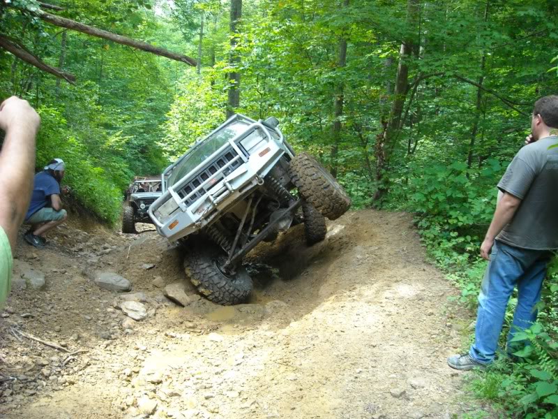

I have seen clay's ZJ cage. nice job guys....It really held up last weekend at harlan and protected the body like he wanted it to!
Yep, the cage paid for itself this weekend. :D In the picture you can't really tell but the entire rig is supported by the cage that is leaning on a rock. Cage barely had a scratch on it, and nothing a rattle can won't fix. This rock would have ripped the doors so bad that both passenger side doors would have been smashed and ripped open, probably smashing all the glass as well.
finished bumper pics
Light tabs are hidden but they will hang down in the void on the lower part of the bumper filling in the open space. Thanks man for the good word. BIL is going to have a nice ride when he is done.

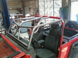

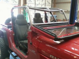

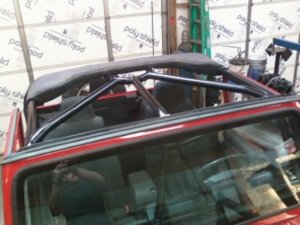

Jeep Lj Sport cage
This is for a fellow board member. Nice simple LJ cage made for a halftop conversion. .188 wall sliders and the rest is .120 wall DOM.
Man, this is only 3000% more bad ass than I had imagined.:bounce2: Can't wait to see the finished product with the soundbar modded.

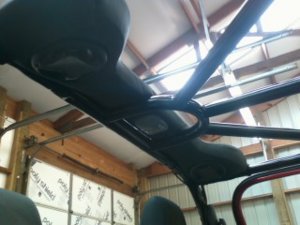

more lj

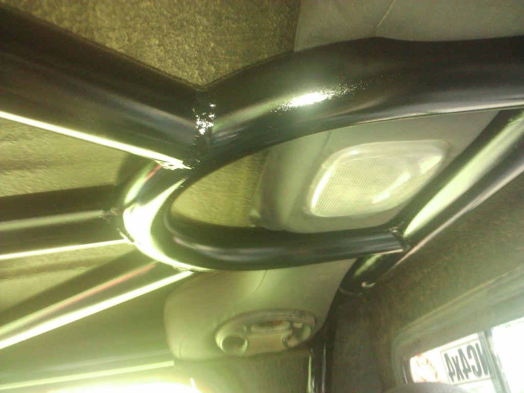

Modified soundbar to fit cage.
Front view
Slider. Rocker area will be covered by black diamond plate.
Entry. Through dash. Through Floor.
Drivers-ish view.

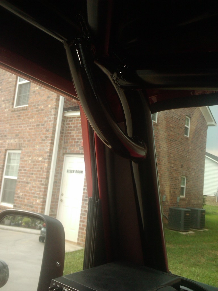

Closer view of sound bar modded to fit cage.

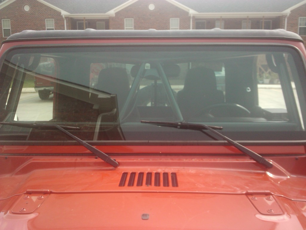

Super clean, super awesome job. I'll post some pics when I get the top off and windshield down, but looks like weather and timing is against me this weekend. PJ went beyond what I wanted. We met and talked about a few things, I dropped off my jeep and picked it up and was blown away by the install.
Next up is a swing down tire carrier, and new control arm mounts/skids. I am beyond happy with how this turned out!:bounce2:

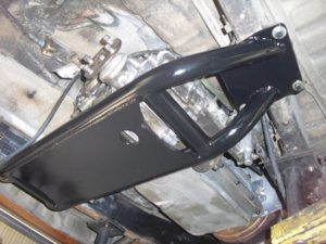

Fj62 fabrication
Here is a skidplate and tranny mount we built along with a modified shifter for the 6.0 swap the customer did. This truck will see mostly towing trips and some moderate offroading. The sides are cut out for mud removal.
The pics look great PJ I can't wait to get this thing on the road. Thanks for the update.

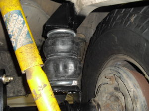

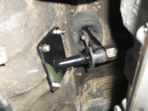

traction bar,custom air bag mounts

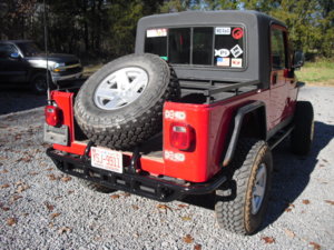

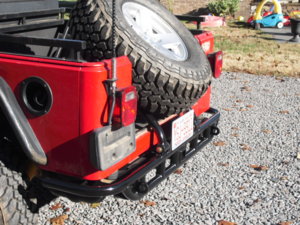

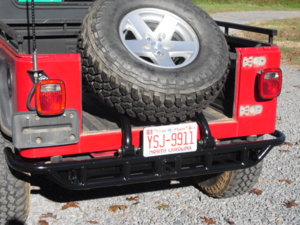

LJ bumper and tire carrier
beginning of the bumper setup...
Painted and installed
