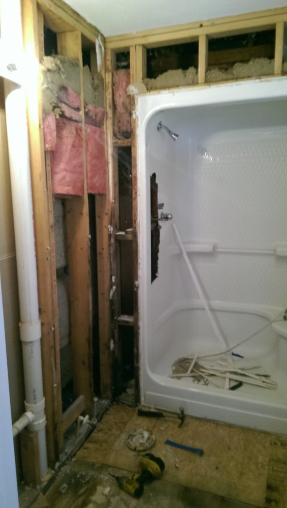

After the inspection was done the only thing noted in the report was that the toilet ring had apparently leaked and damaged the floor around the toilet. NO MOLD, NO ROT, just damaged subfloor. So we negotiated with the seller to fix the floor.... and they..... well their "handyman" tried... Well after we moved in and were settling down for our first night in the house, I heard what sounded like someone pouring a cup of water in the wall behind our master shower..... a big cup of water..... There was no way to get behind it except to bust the shower. I understand they cant see through walls but how he missed the rotted floor joist, subfloor, and mold and mildew is beyond me. This much damage doesn't happen in one week from the time of inspection to the time of closing........

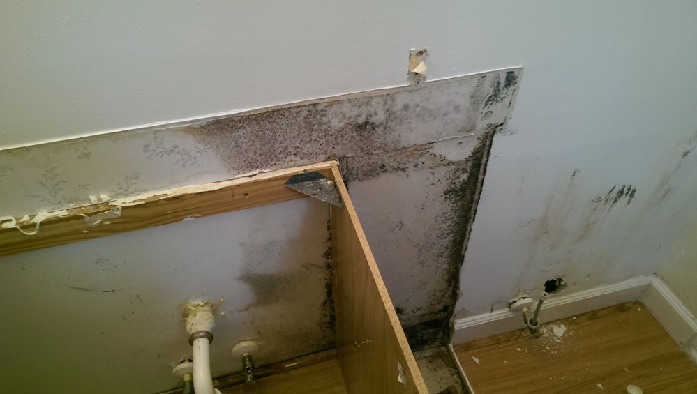

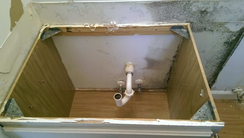

You can clearly see mold on the inside of the cabinet, the rest was covered by another cabinet and the counter....

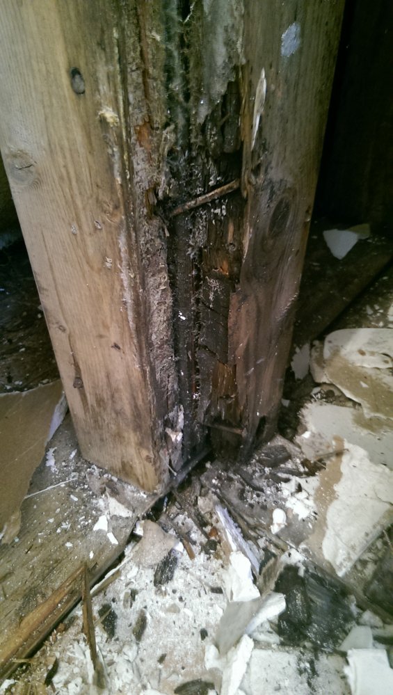

this used to be a 2x6...

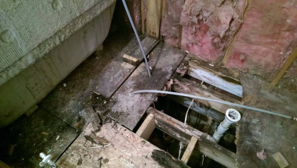

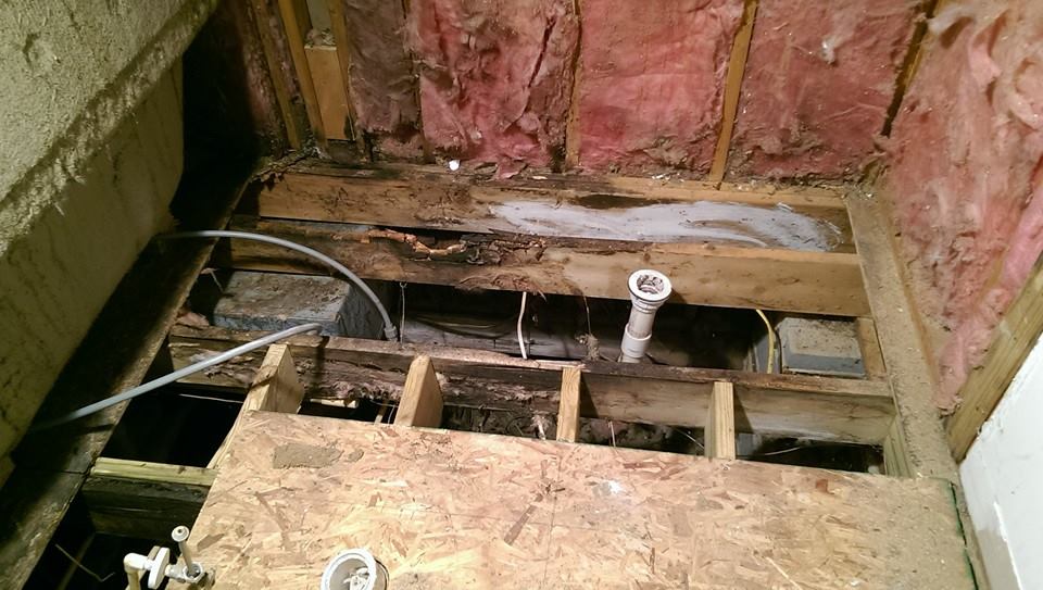

↓↓↓ in this pic you can see where they repaired the "toilet flange leak" (new OSB)
I pulled up most of this subfloor by hand....

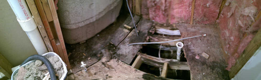

and heres where all that water came from ....

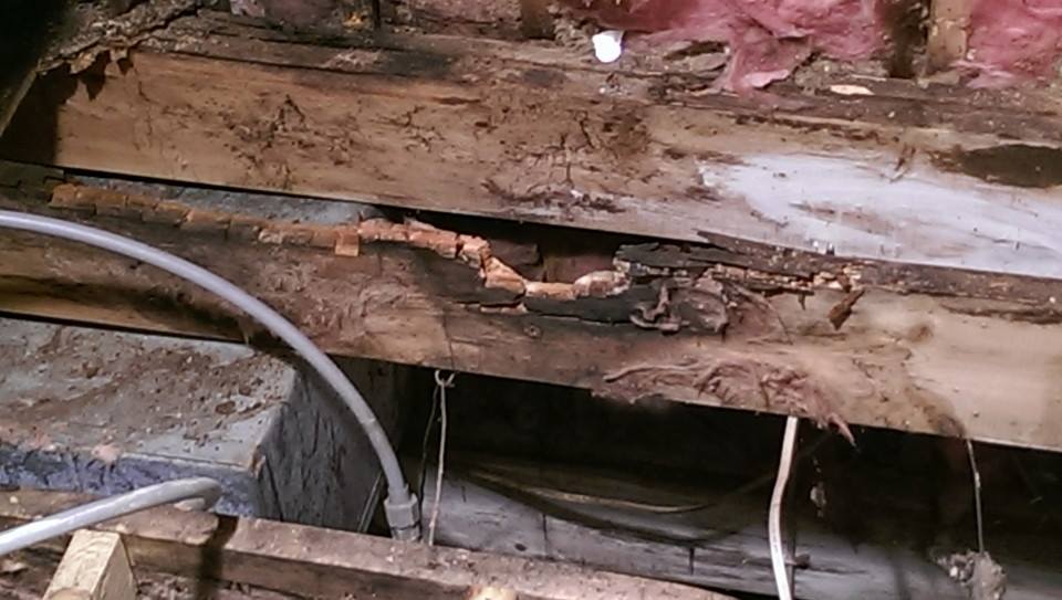

you cant tell me he couldn't see the rotten floor joist from the crawl space.... they literally crumbled in my hands.... but this rabbit hole just keeps getting deeper.

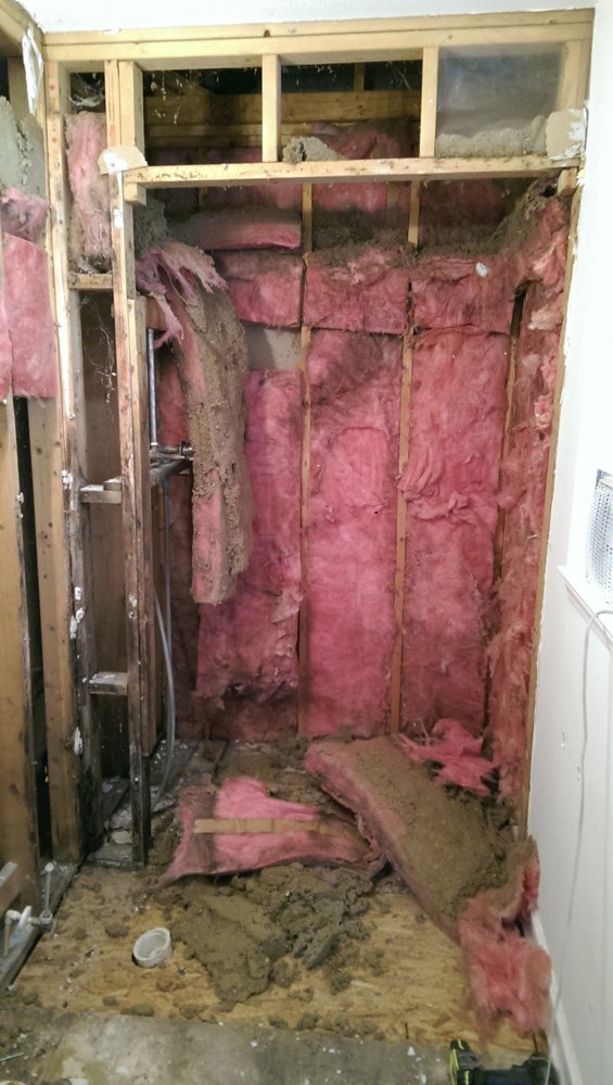

Im in the process of tearing out everything that's black or rotten. Sad part is it looks as if the water had run between the two layers of subfloor and into our bedroom. Again, this had been leaking like this for awhile. The house is a foreclosure but according to public record only 6mos between their eviction and our purchase.

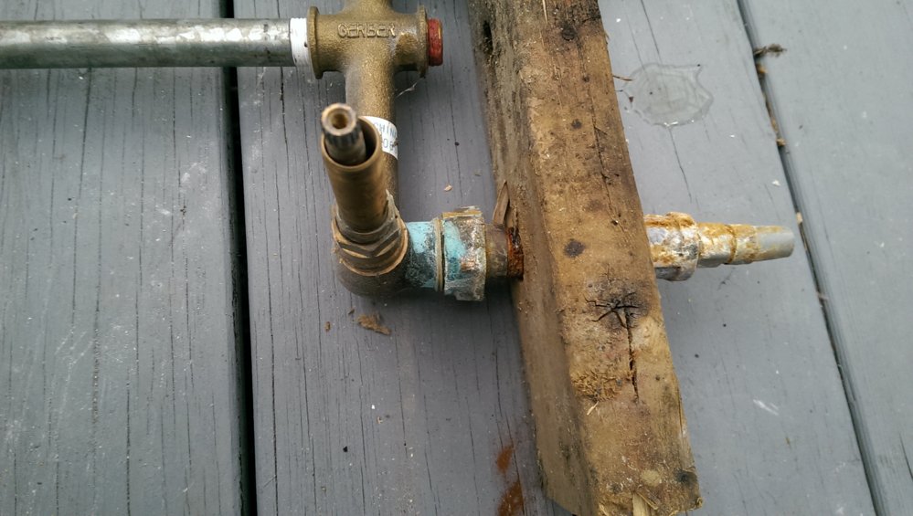

the poly only goes down to the floor joist where it connects w/ cpvc.... the plumbing is a nightmare. Im going to re plumb everything with pex and eventually re-do the whole house w pex. I already knew about the cpvc and had planned on replacing it anyway

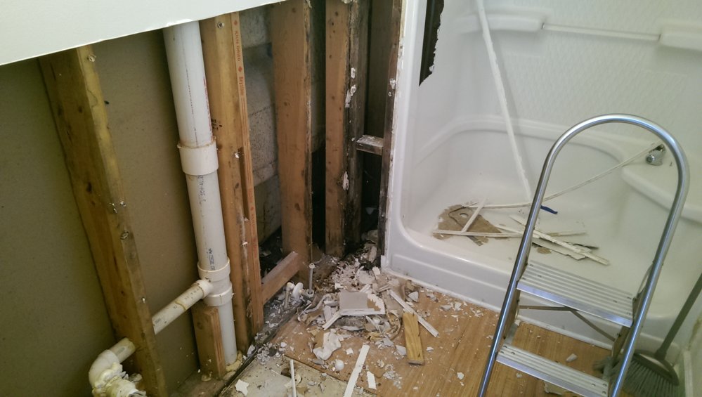

well heres an update.... I've fixed and replaced all the structure damage and have the bathroom closed back up. Now having a mold remediation company come in and clean. They are pulling all the insulation spraying mold killer and wiping the beams and all. Then we are having the crawlspace fully encapsulated and dehumidified. Its costing an ass load of money, but I think my 2 year old son is worth it. That and if we ever resale its adding alot of value to our house.
Keep us updated on how the remediation goes. The company I work for does remediation and I've put my years in to it. There's a proper way to do everything.
Excellent decision on having the crawlspace encapsulated and dehu in place. Keep the ground moisture out and humidity below 55% and you won't have to worry about mold and pest problem will decrease by a lot (believe it or not). Pics of encapsulation please. I helped pioneer full encapsulation techniques in the southeast.
