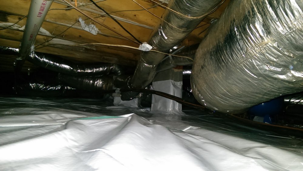

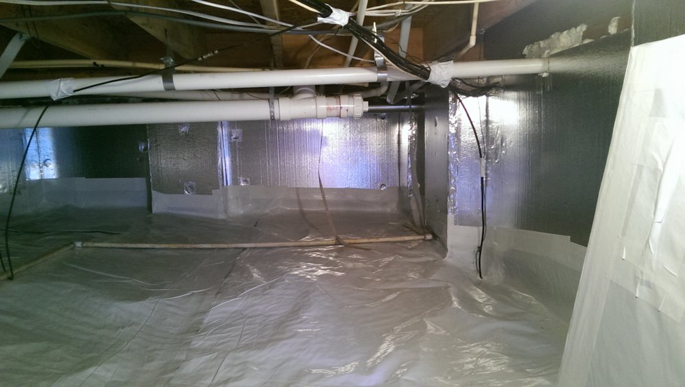

It's all being done by Dry-Pro / Advanta Clean here in Charlotte. They gave me the best price for what i wanted and came highly recommended. I had several companies come in and give me quotes that ranged from 4k to well over 10k. I didnt go the cheapest but I didnt go 10k either. I'll get some pics as they progress over the next few days. While we dont have alot of pest, we have a TON of these....

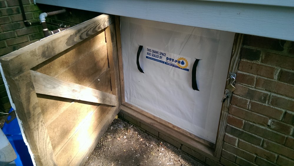

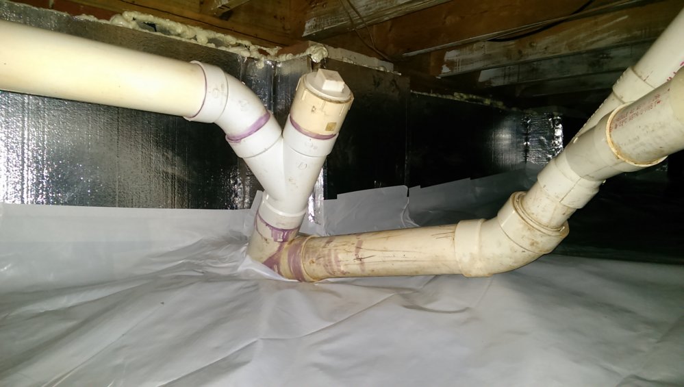

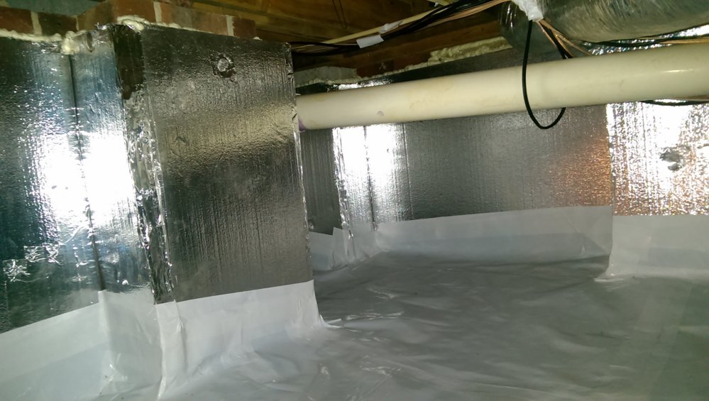

They started this morning.....

Smell moldy?
The smell is normal. If it gets to bad, ask them to set negative air. They'll use a large Axial air mover set up outside pulling air through the floors and out the crawlspace. We have also used HEPA filtered air scrubbers inside before. Your health is top priority so by all means request what you feel is necessary. There's no equipment shortage, believe me.
it was mostly gone this morning, we left the windows open last night and had fans blowing into the house. It was a damp stale smell. I guess you could say moldy but not your usual moldy smell.
Disturbance of the crawlspace ecosystem. Decayed plant and animal life.
yeah they warned me there might be some smells and I expected some but damn LOL its fading. No where near as bad as it was last night
Encapsulation is the only way to go.
It really is. So many years of installing it and several follow up trips to old jobs I've seen the long lasting benefits. Energy savings of 10-30% annually, fewer pest problems, no more cold floors, less duct sweating, not to mention the mold reduction.
yeah I always said if I had a crawlspace house that Id have the crawlspace encapsulated.... but again its something that came a lil quicker than expected.

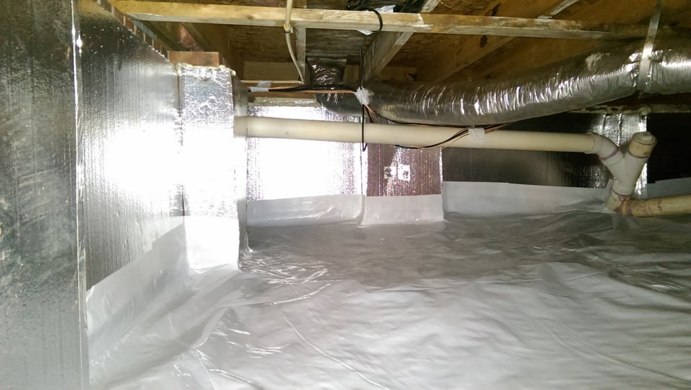

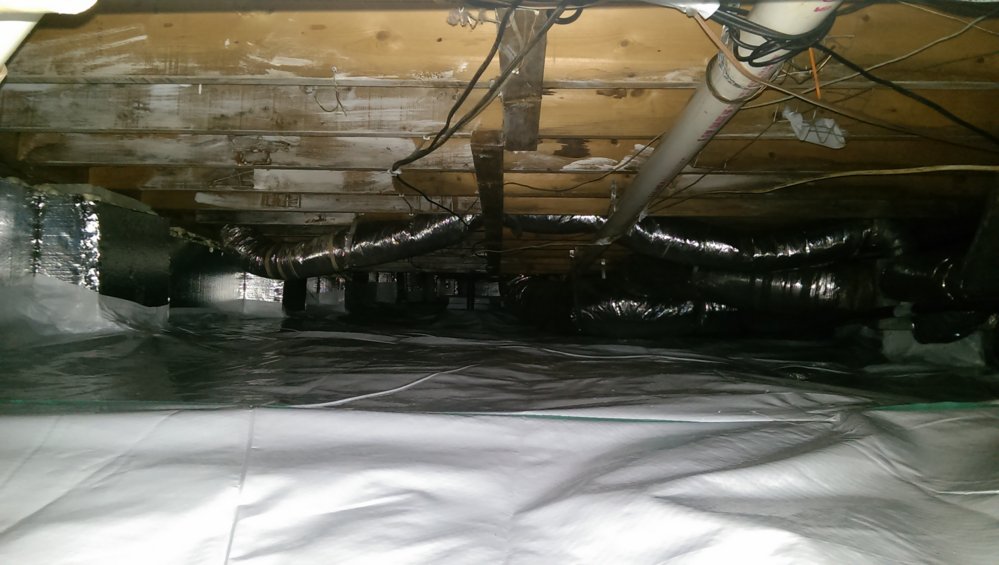

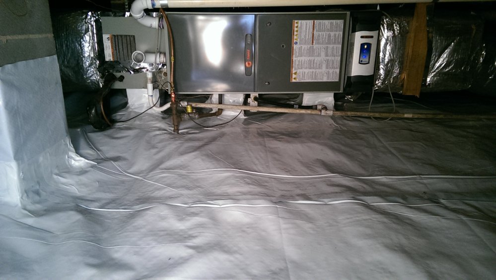

Well they finished today, and man I couldn't be happier. The smell has pretty much disappeared, and my humidistat already shows about a 7% drop in the house. I crawled under the house to check things out and was able to do so in shorts and bare feet. Shoulda took my camera and grabbed some pics but didnt think about it till I was to far under. I'll grab some next time I'm under there..... If any body is thinking about having this done.... DO IT!
