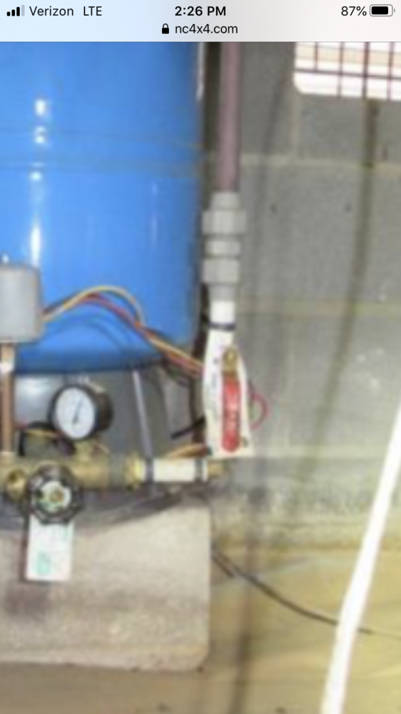

the tank under the house is reasonably new and could be because the last one ruptured and flooded the crawl space, thus causing the water lines you are seeing. I’d be willing to bet the water lines from what looks like flooding and the effolorescense on the CMU are unrelated.
I am no expert and haven’t seen it in person, but by the pics, that would be my guess.
Is this piping system change from brass to pex to whatever the valve material is, to galvanized, and then to copper? Is there a dielectric Union there? Can’t tell from the pic and the piping looks reasonably new. If there isn’t one, it won’t be long before the crawl space floods again.

@rockcity can you elaborate on what would burst or leak? I'm not familiar with building code or plumbing .
The galvanized union does not appear to be dielectric. Which means it is not protected from galvanic corrosion when it is connected to the copper pipe. Most dielectric galvanized unions have copper on one side and steel on the other with an insulating material between them. The one I pictured does not appear to be this type. It may be fine, but maybe not.
galvanic corrosion, in this case, happens when two dissimilar metals (copper and steel) are piped together without the proper insulation between them. Galvanic corrosion then occurs, thus shortening the lifespan of the fittings, sometimes drastically depending on conditions and circumstances.
most AHJs require some type of protection against this (dielectric unions, brass nipple, jumpers, etc)
this tank replacement was likely performed without a permit, so there was no inspector to inspect.
The piping may be ok. It’s hard to tell. It just looks very suspect. I’d ask the home inspector about it, he should be able to pick up on things like this.
I’m hoping that’s a grey plastic union to join copper to Pex
