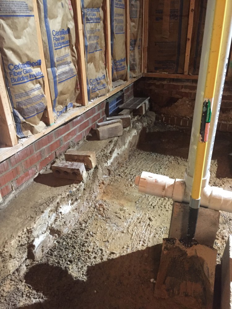

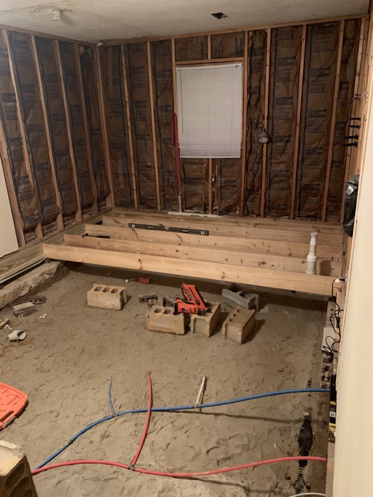

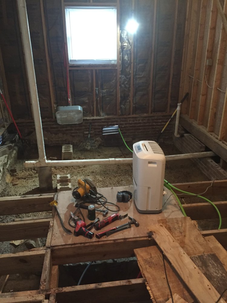

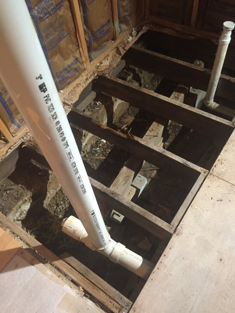

working thru my own issues now too. Pics are not in order, but you can see start to current.
