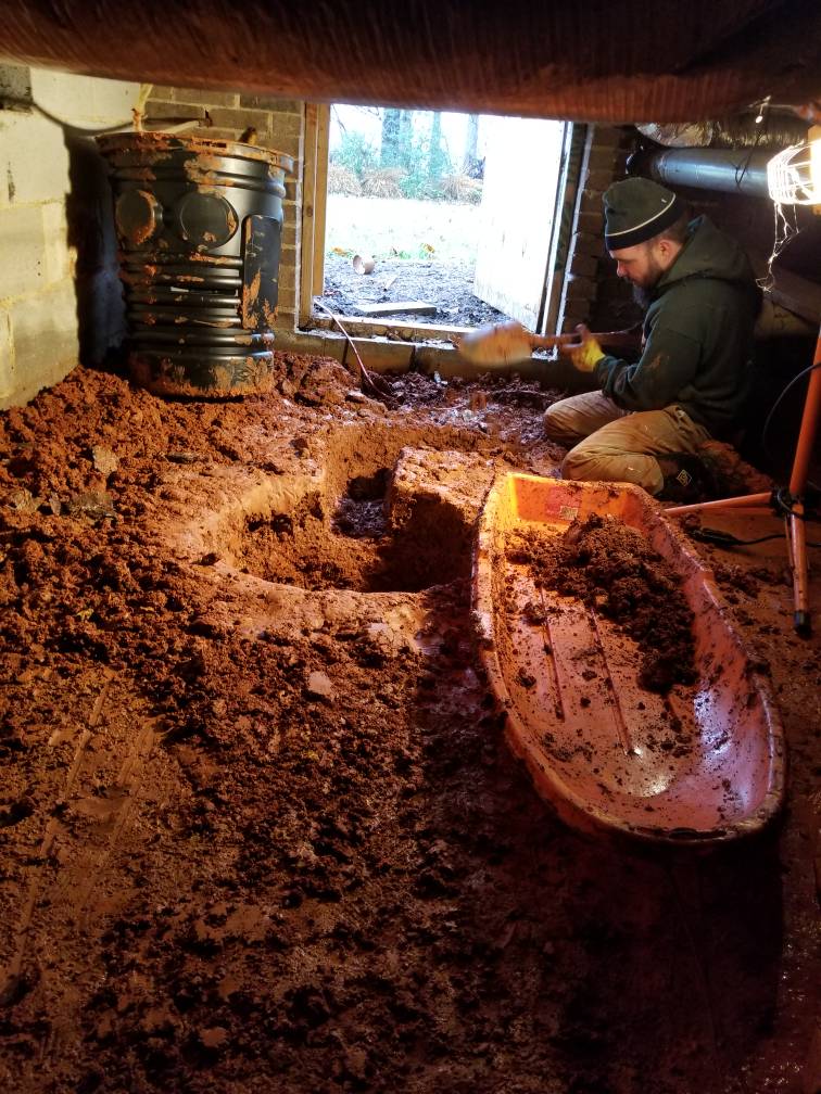

Had to dig the hole and drain in my dad's crawl Monday. I'm glad I don't do that for a living... I'm still sore.
Luckily I have a short friend who used to do this stuff before becoming a preacher man.
It's just too wet.
It's just too wet.
It's just too wet.

We have that same sled. It's a good one.
