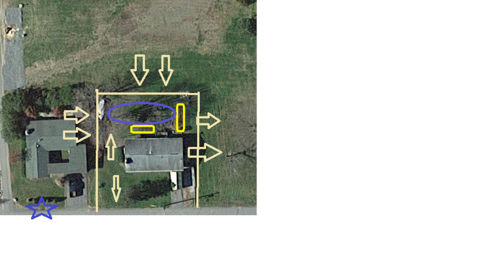

i tried to make a picture showing roughly what is going on. the yellow/green outlined areas are berms.
the star is were the storm drain is.
arrows show water flow direction.
solid line is property lines.
the big blue/purple circle is where the water stands the most and deepest, although i do have some standing on the left side of the house as well.
if the colors are wrong :flipoff2: im color blind
I say do the sump thing that Scott posted, and either discharge it to the east or to the south (street), depending on which side has the most positive slope away from the house. Might could even run that discharge line most of the way out to the curb.
If there are gutters on the house, put extensions on the downspouts to get them 5-6ft min away from the house.
The garage is on slab but I was planning on taking it out the east side since that looks to be the lowest space in crawl space naturally.
Downspouts are ran about 10’ from house now.
It’s a shit lot, but fixable I just don’t want to do it yet
And if you build up the lot and slope away from the house, the crawlspace will still be a bowl of a low spot in the center.
Looking at the front of the house from the street,
If the left side is the lowest elevation in crawlspace, put sump pump there,
Then pump it to the street.
Put your pipe at the foundation at the height of your desired final grade and slope to street. I’d come thru the foundation wall as high as possible, while still having slope, then elbow down to your desired height. So anyone looking for that pipe will see where it exits.
This way when you add dirt to fix the lot, the pipe is buried and you create a berm/swell on that side from corner of house to street.
