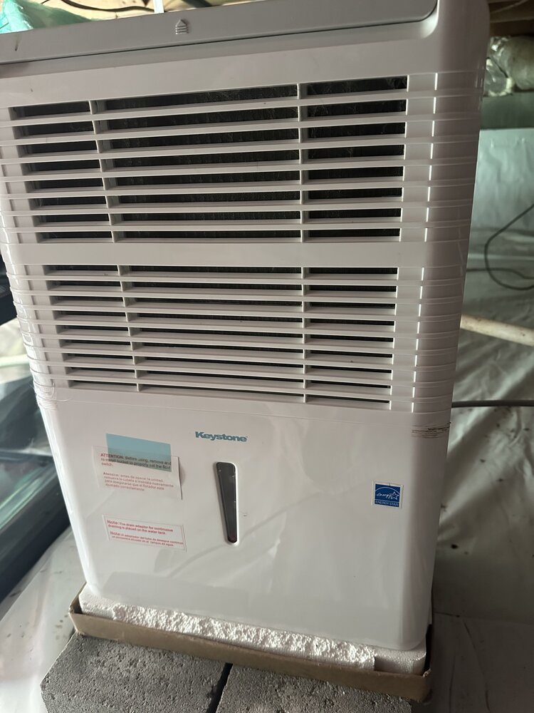

I'll look in the crawl space tomorrow for the brand he put in mine. It's going on 3+ years with no issues.
@Mac5005 advised me to put a keystone when I redid moms a few years ago,
Went and checked. Keystone on mine as well

Keystone for works well for cheap model but currently recommending aprilaire with WiFi for being able to troubleshoot remotely, and keeping an eye on compressor run time and humidity levels from anywhere.
