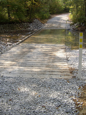

- Grade the bank away on each side and build a heavy gravel road that crosses through the creek bottom. Could even do something like this:
This is the least likely, but cheapest option so far. Concern about large storms coming out of the creek since the channel walls would have an exit in them.

Bridge would be the best long term, but the cost will be way higher. I have a similar creek. A ford is neat, but I imagine would be a lot of maintenance, as crap would build up constantly, and much moreso after every rain. The 6ft pipes would occasionally clog, but I'd likely go that route. During a major flood, there is a chance they could get washed out, but probably wouldn't move, just the dirt would depart around them.

I have thought about the ford, but using larger blocks like these. It would get you up out of the water/silt, but i suspect the small gaps between the blocks would get filled with silt and create a dam after a while.

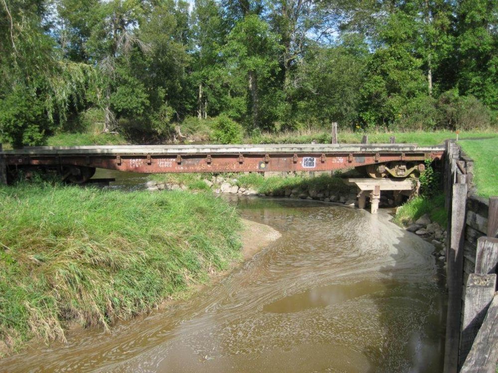

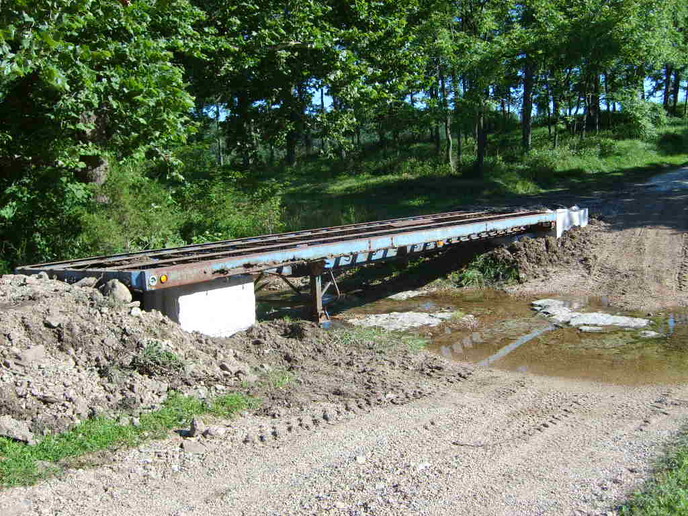

Might be redneck but if aesthetics aren't of concern I'd buy two flatbed trailers, pull the axles off, and sit them side by side. Instant 16ft wide 48ft long bridge for 5k or less. Google image appears to be a train car but same concept.
I know a guy who builds bridges on his property out of old mobile home frames. Sets them side by side and attaches them to each other. Decks them with 4x6 PT boards.
Would be a pretty cheap possible solution.

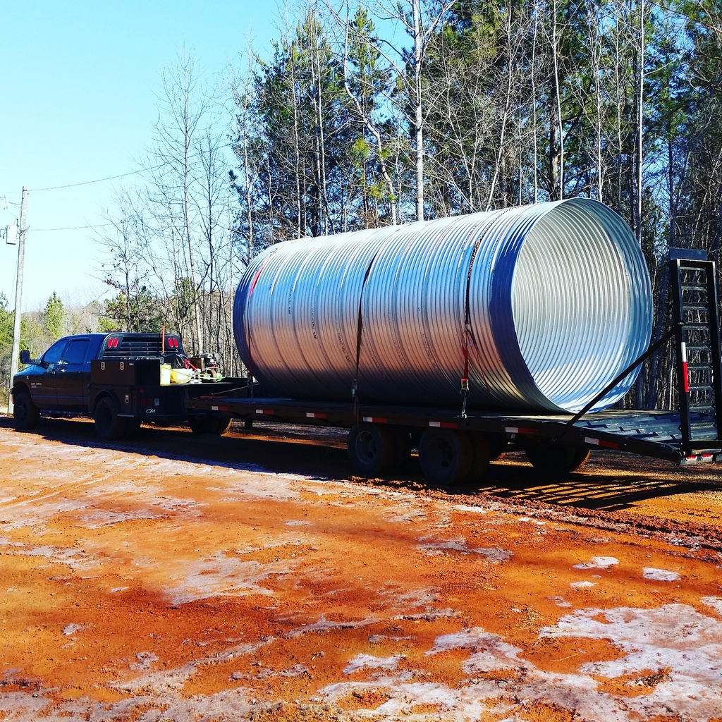

Just build up the land where you want to cross past any flooding area. Kind of like building a pond dam but just stick a big metal pipe in it like I'm doing. Cheaper than any other option, less maintenance than flood water washing your rock away constantly and easy and quick to do.
Good idea for normal stuff, but
they are going to be building a house, so any conrete or delivery trucks will need to cross this too.
I dunno about driving a concrete truck across it...
He could cut the bank out on both sides and make a temporary construction crossing. If you look to the right of the "bridge" in the second pic it appears they did the same thing.
Needs to be permanent and capable of getting a loaded fire truck to the house.....or....just have REALLY good insurance

Put one in at the farm, much smaller creek, used 80' of 30" plastic pipe and about 5000 yards of dirt! It made it very easy to maintain, and don't have any problem with dump trucks, the excavator (49k lbs), or the bulldozer.

I'd think two pipes with a little space between them would work real well. 40' should be plenty of width.
