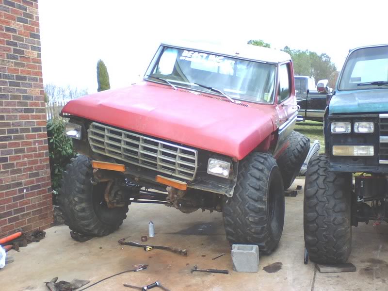

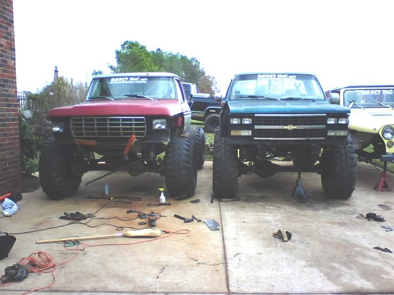

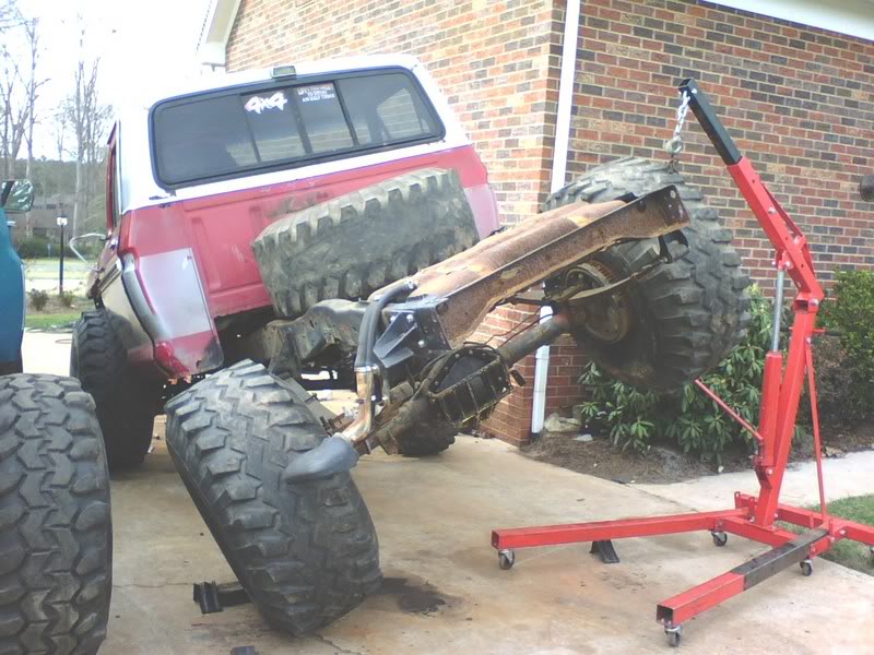

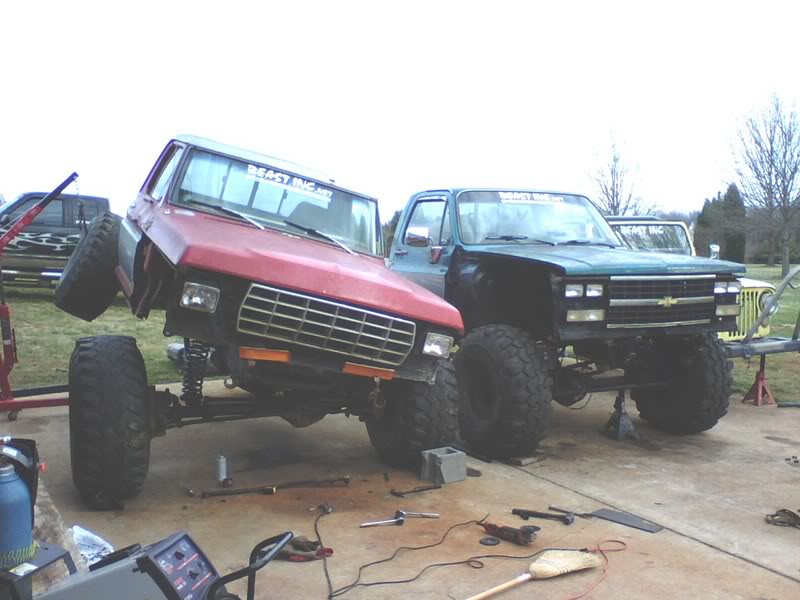

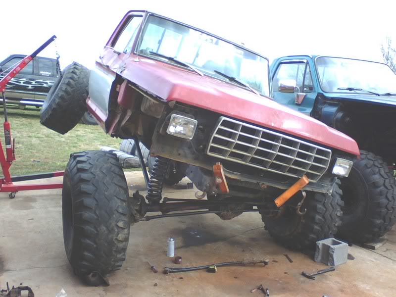

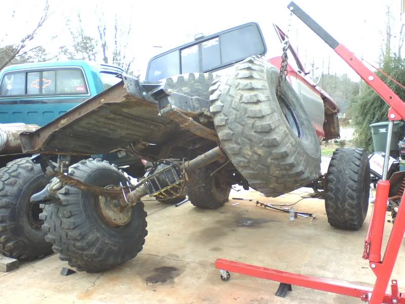

Well, got the suspension on the front of the ford done for the most part, the new 4" superflex deaver coils in, got the tracbar mounted, steering hooked up, then decided to flex her . . .
*Saftey warning to fellow nc4x4'ers: when flexing your rig make sure the body is actually bolted to the frame
The ford and Chevy almost got alot closer than they would have liked . . .
You'll also find out that old ford trucks get at least half of their flex from their frame. Expect to lose some when/if you add a cage.:flipoff2:

Ricky you are right dude, that thing flex's great....waiting on my dad to call me back about the eldorado pan...i was at wake tech today and saw another back Z that had Beast inc. i think on the windshield or back window....crazy....so i went and check out beastinc.net and George, they guy with the red cherokee, that got honorable mention in yall competition, bought his roof rack and rock rails from my best friend....crazy...
