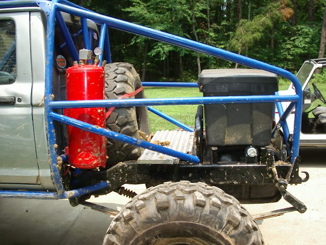

OK, how about cutting the floor out behind the rear seat, and turning the tire sideways so that it sticks down between the frame rails. That should lower it enough that it won't block your view much more than the back seat.
This is how I have mine on my new cab truck. The weight is down reasonably low, centered, and the tire does not block my vision at all. That is a 40" swamper for reference.

Yeah I like the whole idea of the spare tire mounted that way, but I have no way of doing that (yet-- still doing some measuring cuz I do like it that way) I would have to change some things because that configuration leaves no room for the back seat, pane tanks (standing, lying down or underneath --and still being able to access them easily) , the cooler, and the toolboxes. We bought some hinges yesterday and my thought now is that we are going to try to cut into the back part that is left and make a hinge system and the tanks will basically sit on the frame rails. We are trying to see if that will work. That way I will still have some room for everything else, I will not be able to place anything over the hinged area so I will still be able to change the tanks without moving everything off my truck everytime, but thanks for the ideas -- that is what makes this whole process easier because I can see things from different perspectives and then try them and use what works. Thanks

Hinges? With a pneumatic cylinder you can put what you want on top and still be able to get to them.:huggy:
Sam you are correct, they are side to side on a forklift. But the forklift doesn't run trails. If you will also notice that on a forklift there is a pin or a dowel that you fit the top of the tank on when replacing a tank. This gives it proper position. Optimal position would be with the pin side forward and tilted at about a 45 degree angle forward. I had mine positioned side to side first go around and would run out when there was still juice left in a tank. Now, pretty empty before they sputter.
Doesn't Rich have a hinged piece of Diamond Plate above his, with lifters, so he can load stuff above the tanks on his self-propelled flag? Maybe Crystal could go that route too?
yes he does. I took his idea,......kinda. If you look at my pictures section of my rig you see my tanks, they are on a hinged rack with a simple air cylinder that lifts the tanks to access a tool box underneath. Either way, you get to utilize more area.
