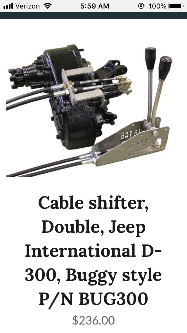

JB customs set up below. I got their billet style shifters and the quality is top notch. In case you say f it and just throw down some cash.
