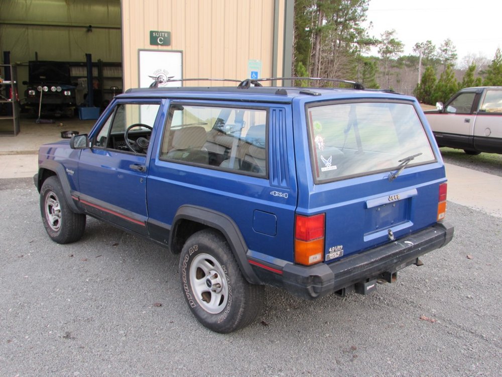

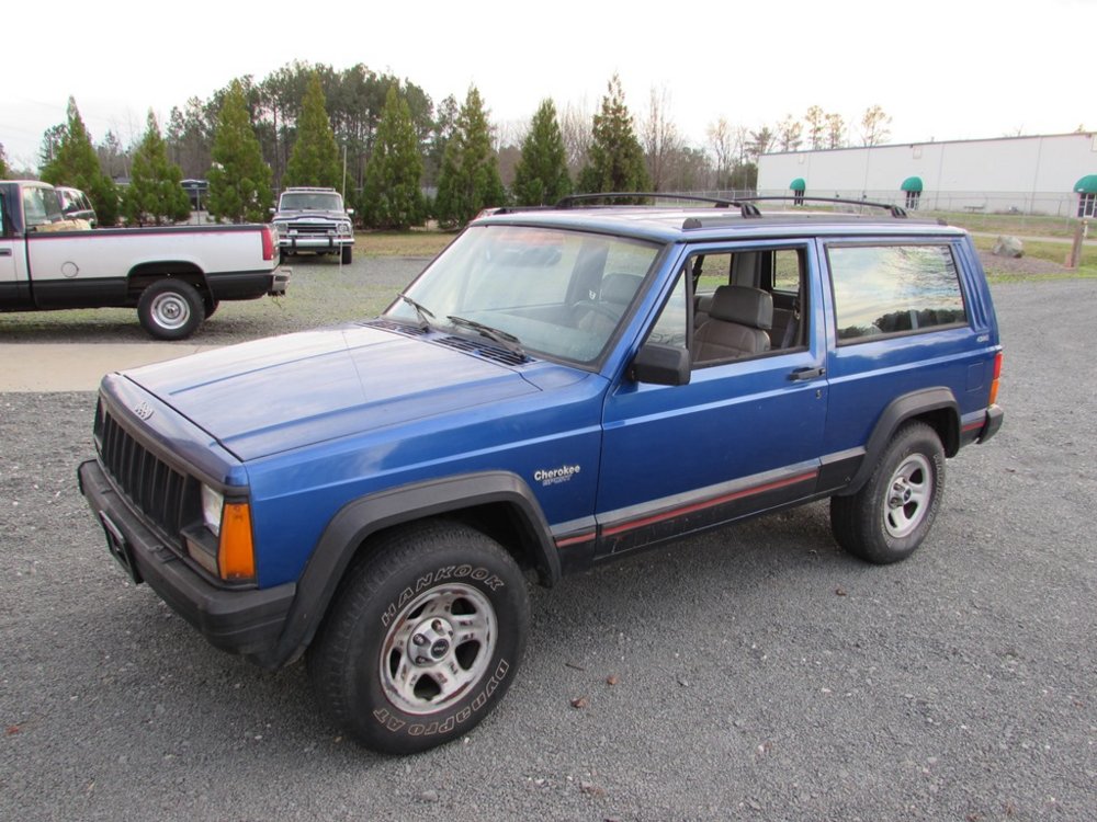

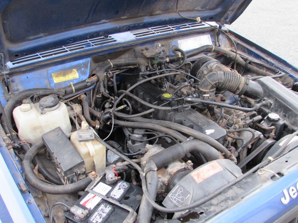

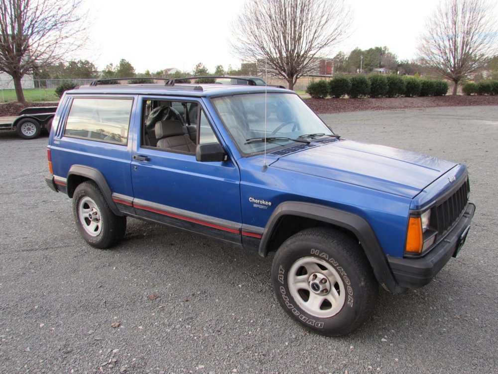

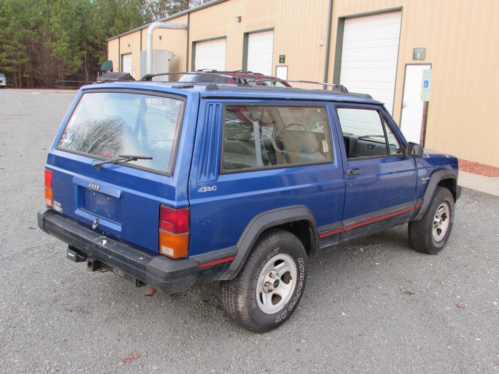

Bought this thing a year ago with a blown motor. Like BLOWN motor, windowed the block and all. Still ran and drove though! I had another wrecked XJ here with a motor that had 40k miles on a rebuild, so pulled that motor and stuck it in this Jeep. Did some other cleanup work and took it for a test drive and the rearend is whining like crazy. I parked it and put it up for sale as-is. No one bought it, so I'm going to pull it back in here and get to working on it. Overall it is a really solid Jeep. Has a little rust in the passenger side rear floor pan and some other bumps and bruises, but is a very solid and good running 2-door. Pretty uncommon color too.

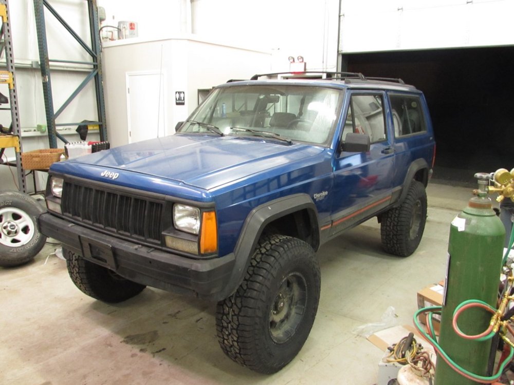

Pics as it sits now.

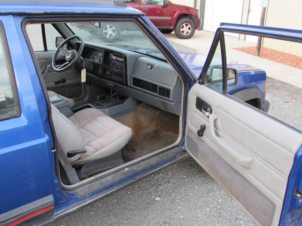

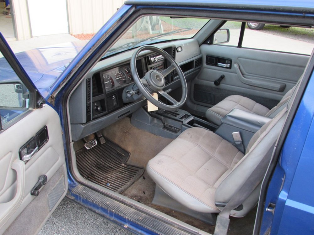

So this Jeep had no headliner when I got it, it is like a tin can inside. I am not sure if this will work, but I'm pretty sure I can make it happen. I pulled the headliner, soundbar, and dome lights out of a wrecked 00 XJ in the shop last night. I am going to pull the material, put some gray bedliner on it, and mount the soundbar and dome/map lights off of the newer model into this Jeep. Should be pretty cool looking. I thought about redoing it with the cloth material, but I have two sons and they will get the headliners dirty in no time with cloth, so bedliner it is!

Got a little backed up in the shop tonight with customers coming over and trying to finish scrapping another XJ. I got one side of the lift done, gotta finish off the other side of the front and mount the new axle and rear lift tomorrow night.
I also hadn't started the thing in like a month, but it fired right up first shot. Runs great too.
Got the front lift done other than installing the new extended brake lines and the track bar and snugging everything down. I also need to install new shocks all around, something with a little more travel and that aren't dead. Going to order some today.
Also got the rear spring packs built and installed, the upper shackle bolt is stuck in there really good, so soaking it in PB Blaster and tonight we'll heat it with the torch and hope for the best. Hopefully tonight we'll be able to get the new shackles and axles installed and start snugging everything up.

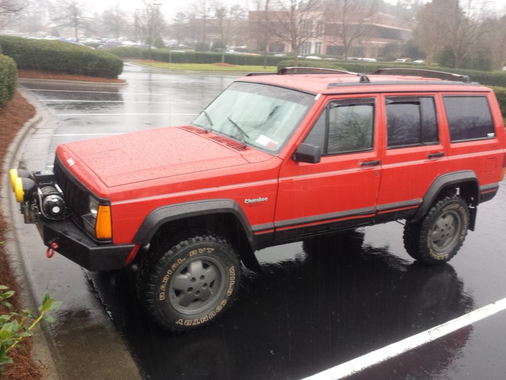

I also picked this guy up yesterday. It is really nice but rusted to shit. It was a western NY truck and shows it. Probably weighs a few hundred pounds less because so much metal is rusted away. :lol: It has a ton of new and good parts on it though, including an almost new winch and front bumper. Not sure how I feel about the front bumper yet, but I'll think about it. This Jeep has pretty much every part I need that is bad on mine.

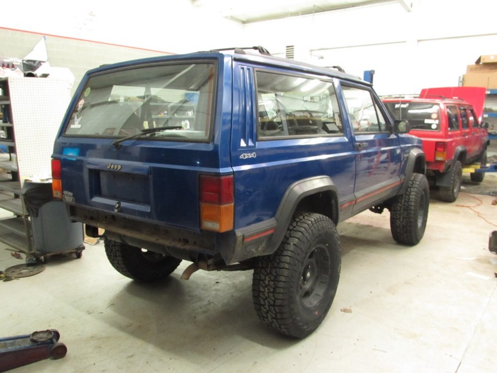

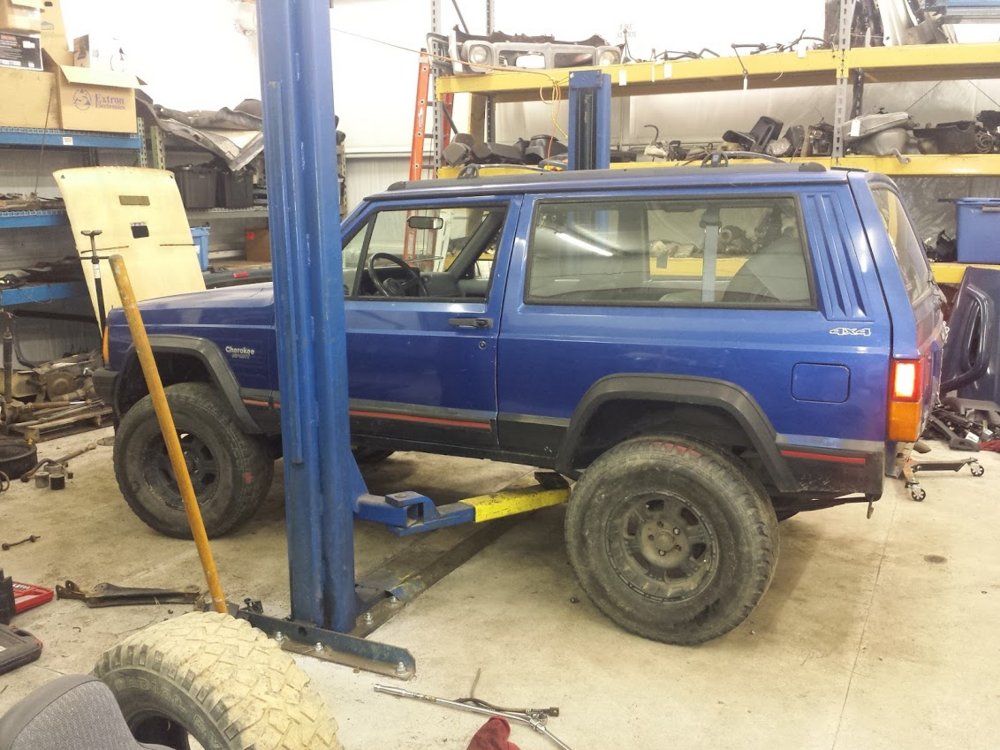

Got the suspension almost done. Most of the stuff is bolted up, just need to install the new shocks, longer brake lines, and a new track bar in the front. Then tighten it all up and it'll be ready for some new tires.

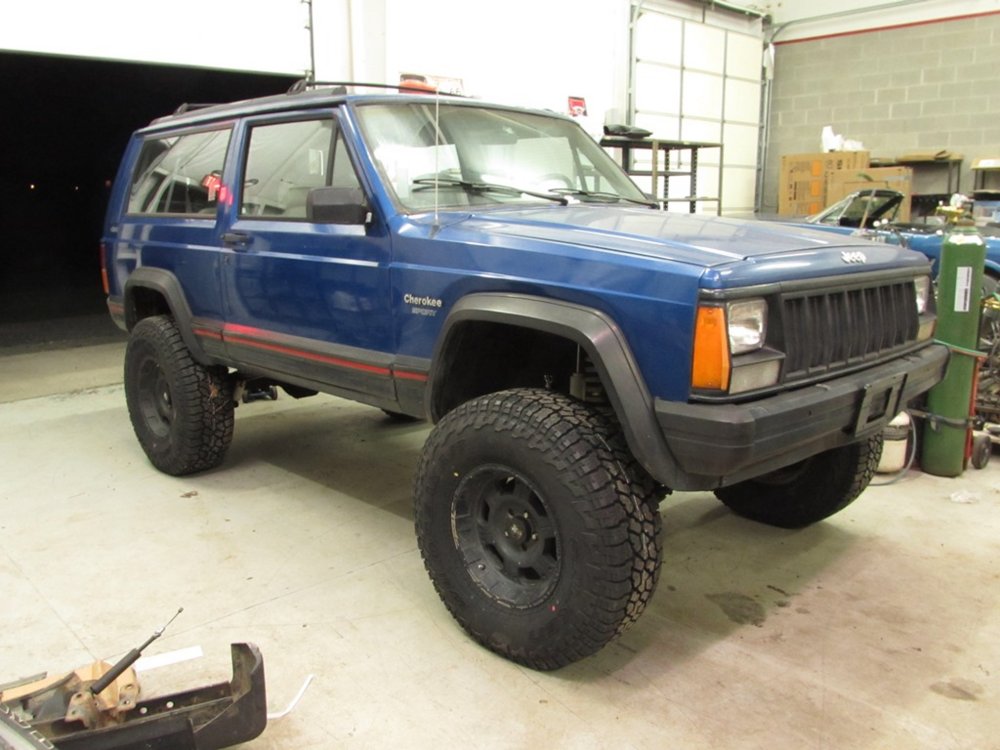

I stuck the wheels on it with a set of bald 33s and I love the look. I know 33s and 3.55 is not an ideal combo, but 4.56 are in the not so distant future.

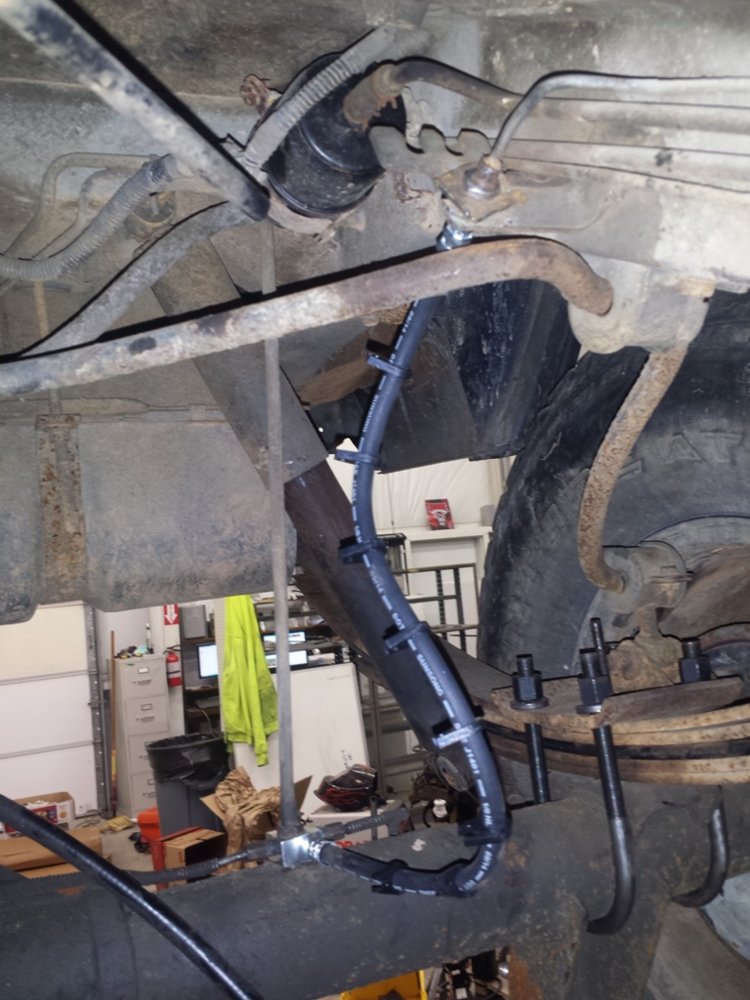

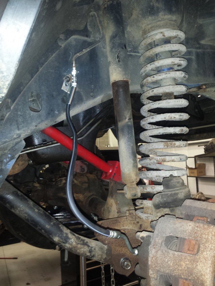

Almost done with it, shocks and track bar should be here Tuesday. I just need to find some decent 285/75/16 tires for the thing. I installed new brake lines tonight. I used 94 C1500 fronts and a 95 Dakatoa 4x4 rear.

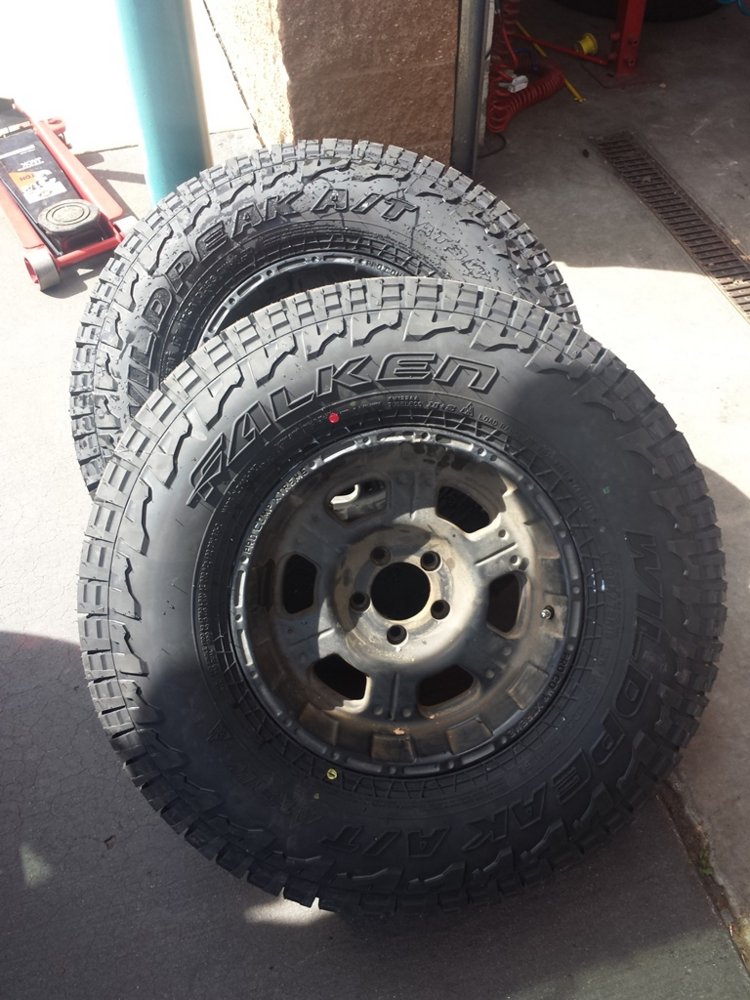

Got the wheels and tires on the Jeep. Going to have to do some hackage and am going to install some degree shims on the rear axle to correct the pinion angle and maybe bump the rear ride height just a smidge. I am also going to try and mount the front bumper this weekend.
A few reasons, I read good reviews on these tires, they look good, and they were several hundred dollars cheaper. I think they'll give me a good combo of good traction offroad, good on road manners (this is going to be my DD), and affordable.

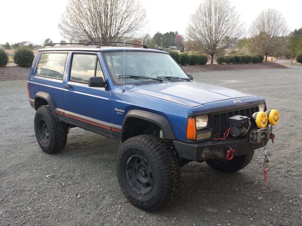

Trimmed the front fenders and mounted the front bumper and winch. I still need to do some aligning of the bumper and add a couple bolts that were missing, but that part is done. All I need to do is align the front axle, adjust the steering wheel, align it and it is ready for the road!
