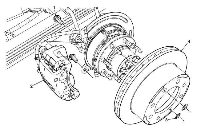

This was what I was talking about. It's basically a factory 14 bolt that Dodge and GM used. Factory rear discs and internal parking brake. It more than likely has a tone ring inside it for your speed sensor too.

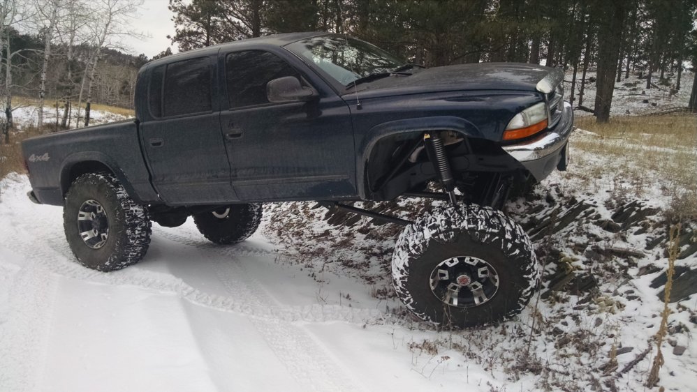

  1. Sqrl$$, did you upgrade your brake master cylinder, what year/model did you use it you did. I got my truck on the road but the brake pedal is soft. I'm running 60/10.25 With gm rear discs.
No I used the factory Dakota master cylinder. I had gym single piston disc brakes on the rear
