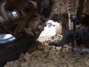

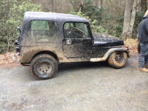

A stock Dana 30 will withstand anything

^Yeah I've seen plenty of balljoints fail on pavement from poor maintenance
That aint the housing, that is a busted stock shaft, bent ear on shaft pushed ball joints apart.
Yup. I'd bet dollars to donuts it was a cheap, parts-house u-joint that did it. Shitty u-joint breaks, binds up the axle ears, and pulls the ball joints out of the bores. I've seen it a dozen times.
I saw that happen at the bottom of Guard rail on a YJ years ago. That was a bitch to get out. I'm keeping my 30 unless I upgrade to tons. I usually take care of my stuff and have wheeled a ton with one.
