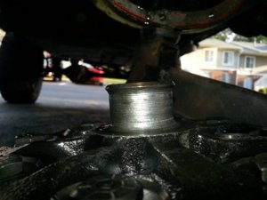

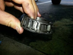

Got it pulled today. ... the carrier is trash.....

Mic it and you can probably get the right size bearing ID with the same OD from a good bearing house!
Or just make a 2 piece shim to adapt from that "machined in place" diameter to the proper diameter of the bearing!
Or throw it away because its a D35 carrier!
(I'd do the last one)
[quote="jeepinmatt, post:
[/quote]
This....d35 parts are usually dirt cheap if not free. Find a carrier and swap the ring gear over. Get a set of bearings and shims. Putting a carrier in and setting backlash is fairly easy
Sent from my SPH-D710 using Tapatalk 2
its a street jeep? put bearings in it and run it. 75/140 oil. will be fine.
D35 spun the bearing too, seem its pretty common
