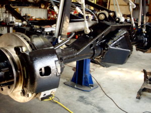

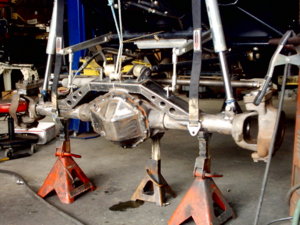

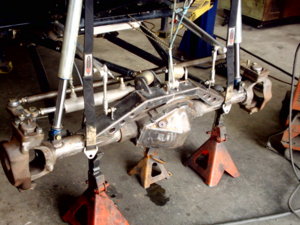

I actually have a fish plate on the front side of the truss to the chunk.. I hope that the rear weld actually won't have a huge load on it.. it it tucked up to the lip of the chunk and with the fish plate on the front i hope it is pinched in there...

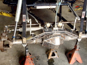

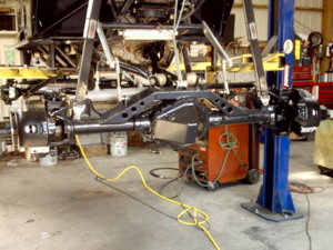

rear axle mock up
That rear truss is totally pimp looking. It makes the typical BTF 1/2" thick bent flat bar truss look like back yard bent up garbage.
Got a question though. The rear ram is attached to the steering arm about half way between the tie rod and kingpin. It won't have as much force to turn the tires with such a short effective lever arm, but should be quicker steering. Just curious what your thoughts were behind attaching it like that.
Im sure you already figured this out but how is the ram gonna work mounted more inboard. I assume that it takes less stroke to get the same amount of turn due to the distance from the axle centerline. Bad ass build by the way.
damnit beat me to it
Ok.. just so happens thier is no where else that the ram can be mounted to make it work.. yes i am losing a little bit of maximum leverage. but if you think about that, the ram would have been mounted on the inside of the tie rod anyway.. it is not that much off from original mount.. As a matter of fact i am using much longer arms than about any standard set of hydro arms out there.. The mounting hole for the ram is about where tie rod is on normal hydro arms..... I would have loved to mount it to tie rod.. but when you have 50lbs of Sh@# in a 5 lb bag and only alittle real steel to mount to.... that is what you have to do, improvise and make it work.. thanks PJ

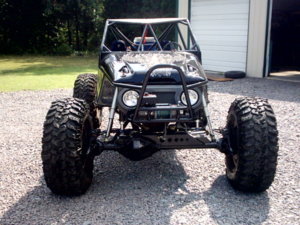

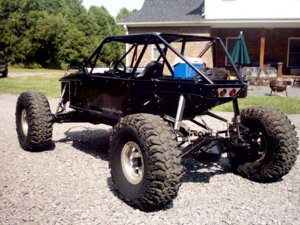

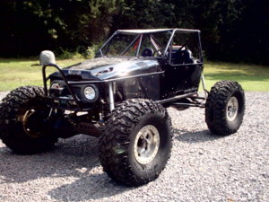

finished pics
ballin
New stance
