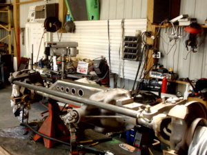

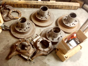

Ok, so i was going to wait until i had more machine work done but.... it is a little slow.. so Here is a couple of teaser pics... 456 cucv axles ... chevy style setup on the rear outers.. Reinforced outer knuckles.. custom steering... more to come... Trusses for sale check vendor section...
more

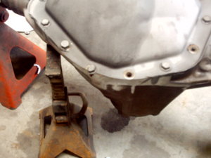

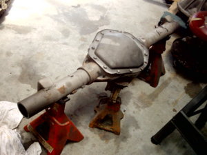

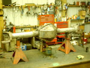

slightly shaved 14 bolt...
Yes, 6 on 5.5 .. did not want to deal with wheel changing that would result in time and money loss.. Worked out pretty well.. We broke a couple boring tools trying to bore out the knuckles so hopefully we can get it done soon..

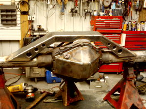

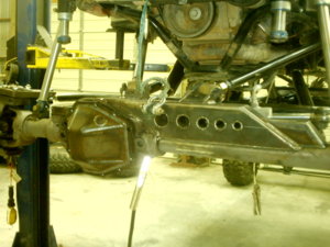

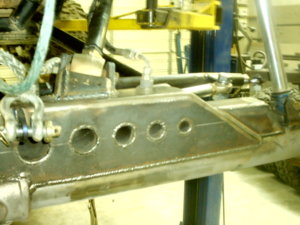

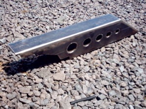

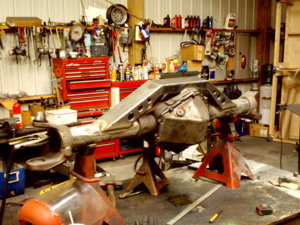

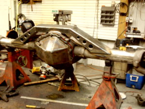

rear axle truss
Plan on the weld from the truss to the 14bolt to get a crack in it. I could not keep mine from cracking on that lip everytime i welded my truss to it. Even after pre-heating. Next time its getting nickle rod.
Looks awesome PJ! Glad to see you coming to the dark side.
have you plug welded the tubes or ran a bead around where the tubes go into the center section? they could be twisting/flexing slightly causing weld to crack
