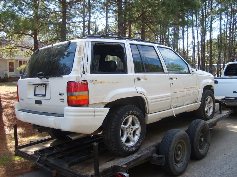

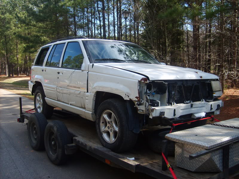

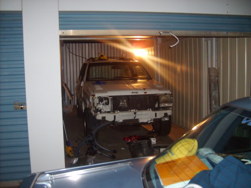

So I was perusing craigslist a couple weeks ago and found a 1998 Grand Cherokee 5.9L with 120K miles on it for dirt cheap. Upon further investigation, I learned it had been wrecked and had done damage to the front bumper, fender, pass side doors, and rear glass. I was going to get it, fix it, and turn it into a daily driver but now have made different plans for it.
I picked it up this weekend with the help of a buddys truck and CYJKrawlers trailer (thanks John!). Here are pics of it when I picked it up.

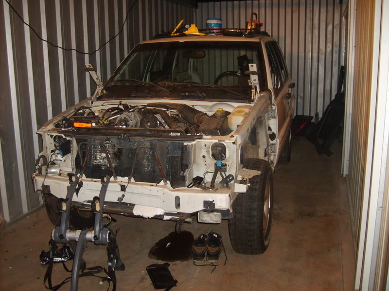

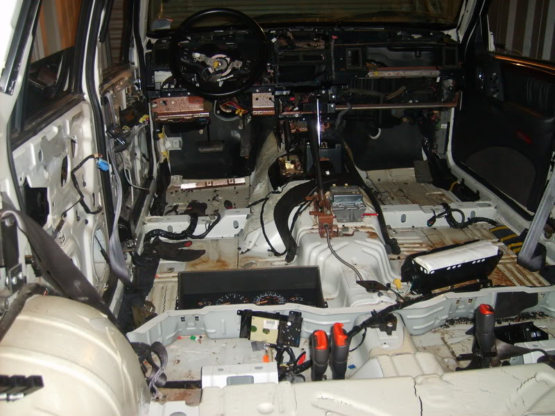

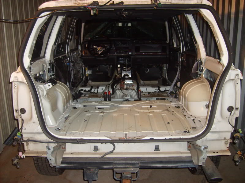

I am stripping it COMPLETELY of every part on it and swapping the 5.9L 360 c.i. motor and 46RH tranny into my rig which currently has a gutless 4.0 and 42RE. Any parts you may want from it, check the for sale forum.

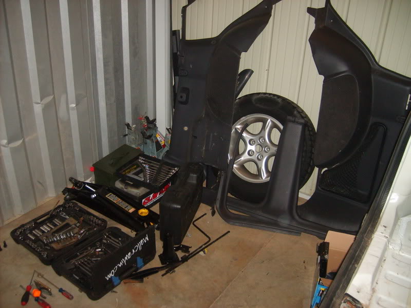

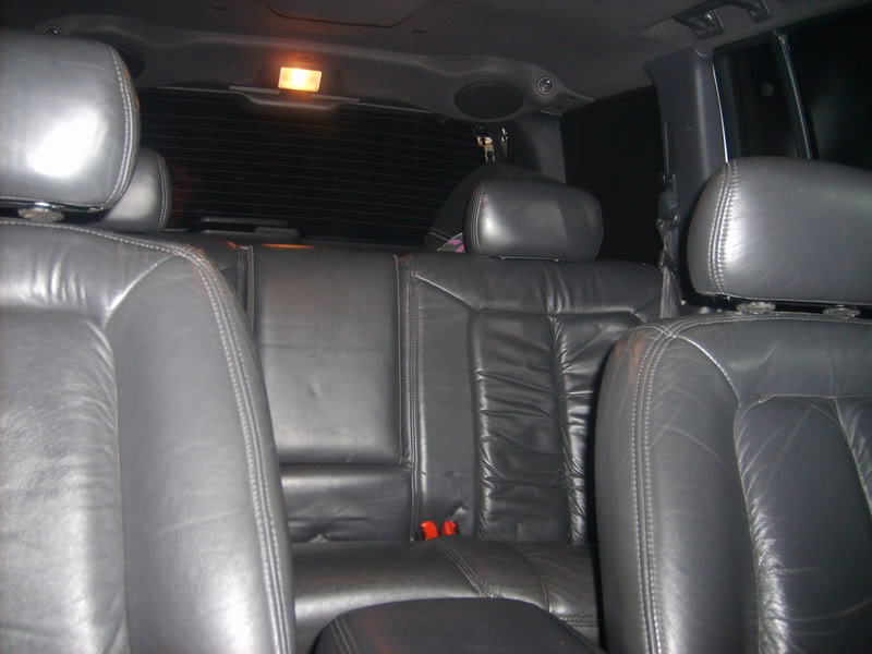

I got started on the interior tonight. I am not doing this at my house because my parents weren't thrilled about a jeep carcus sitting in the driveway for a month. I have a nice little 10x25 building setup with a couple work lamps and a space heater. Alot better than a cold driveway! Here are some pics of what got done tonight.
