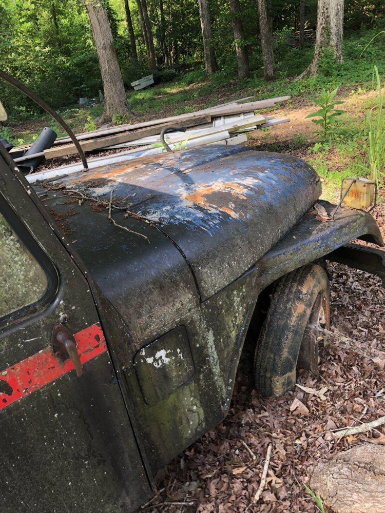

My uncle is a mailman. My grandfather was a mailman for years and retired from it. The Jeep in this project was gifted to my wife by a mailman. There have been DJ’s sitting around my matriarchal “home” for years and I always thought it would be cool (like many others) to have one.

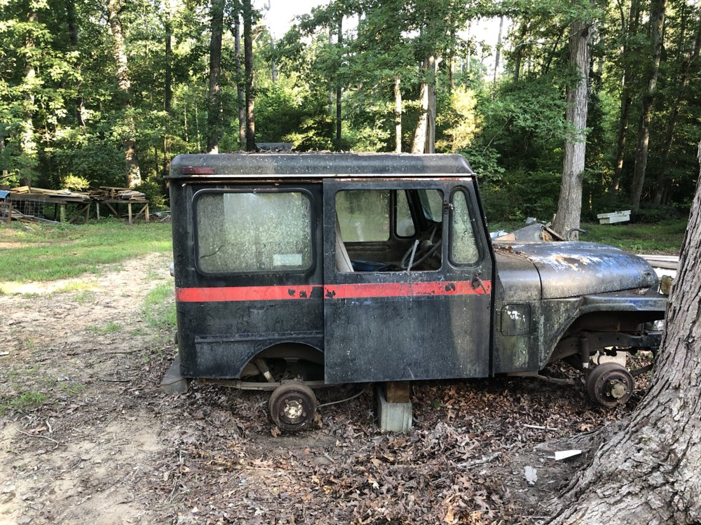

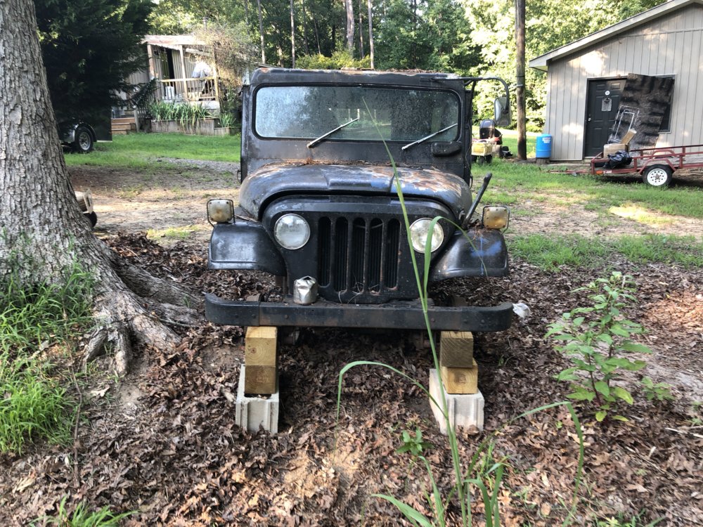

A friend, I’ll call him Kenny for now, gave the DJ to my wife. She loves jeeps (as do I) and, as a result of a PCS move to Korea (I’m active duty army) we didn’t have one. Kenny wanted the DJ out of his yard. It had been sitting for years after the brakes locked up. I went over for an initial assesment and decided we’d go for it. I knew this would be an adventure, I did not realize the wife would be so excited about it. I put the Jeep up on blocks and pulled the wheels. Within a couple of days I’d found a free used set of tires for it and, after one shop failed to mount them after having them overnight, I found someone to do it the morning we picked up the jeep.

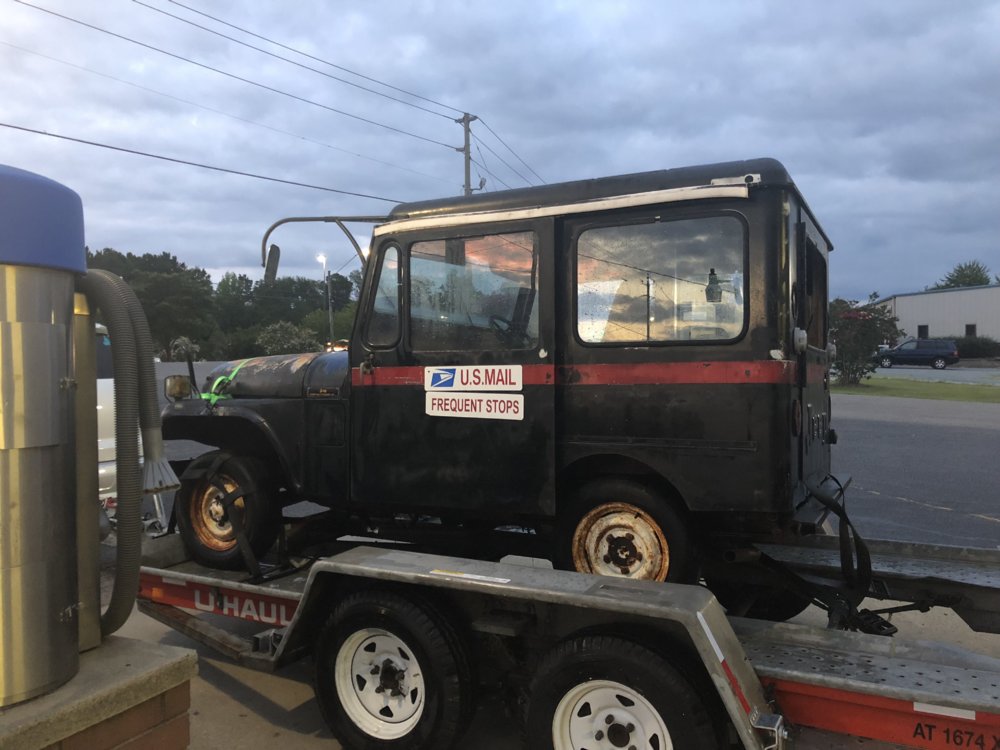

We initially believed the DJ to be a 78 model, which would have been much better with a large bellhousing and torqueflyte transmission but, for the price of “get it out of my yard,” a 1971 DJ-5B was dragged onto a uhaul trailer and brought home.

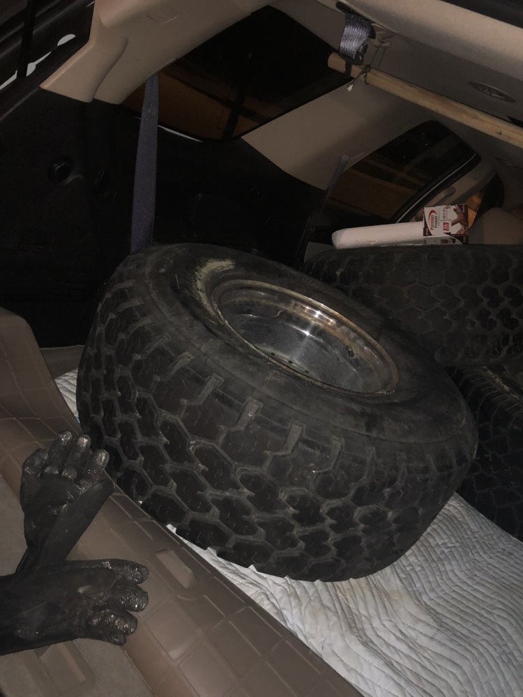

Once we got the brakes off, we put on the garbage free tires I acquired and eventually loaded the DJ up. It didn’t go smoothly, mostly because one of my free tires wouldn’t hold air for shit and rolled off the bead. I gave up on the damn thing and we eventually got it onto the trailer.

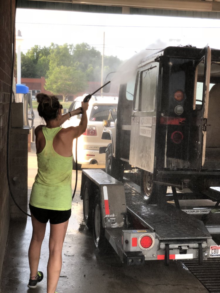

Straight to the car wash. We stripped out the cardboard roof liner and washed away as much of the mold, rat shit, and other gunk we possibly could.
This thing was pretty nasty. Thats what happens when they sit for 12 years!

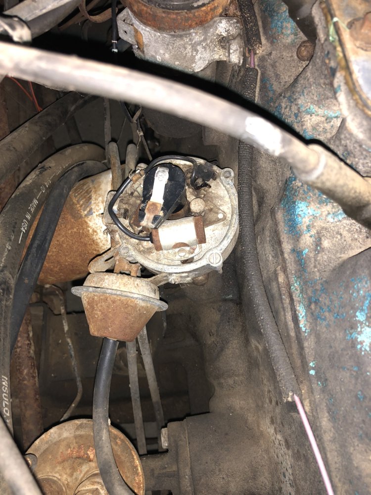

The engine turns, the rotor button spins with it, and the transmission will turn the engine over!
I’ve struggled with learning about this engine and transmission setup. Unfortunately, the ‘71 model 232 has a small bellhousing bolt pattern. The M43 transmission pattern is incompatible with almost everything I’ve found thus far. In 1972, the bolt pattern changed to accommodate the same bellhousing used on all following inline 6’s. I had hoped to keep the engine permanently and just swap out the transmission that had a compatible transfer case... this doesn’t need to be an extreme build. My boss (wife) wants to be able to drive on the beach, drive the gentle trails at the farm, and putter around town in it. At this point I’m thinking I need to rebuild the brakes and keep the axles I have now until the winter and then try swapping in an engine, transmission and transfer case from a CJ/YJ/XJ setup. I’m hoping to find decent ford axles for it.

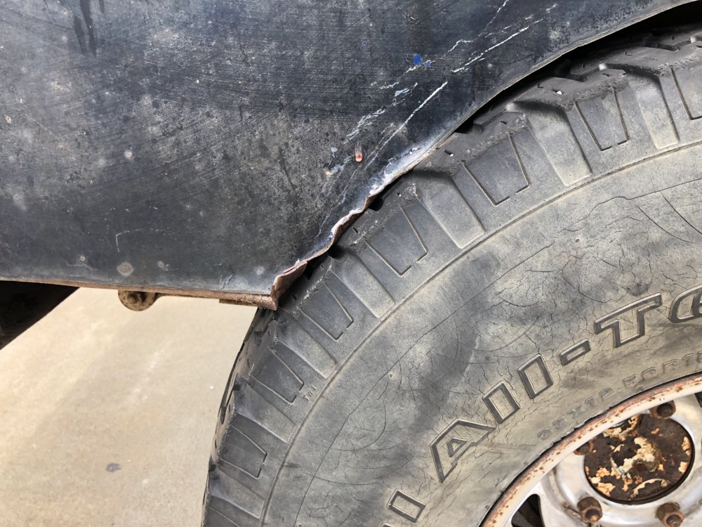

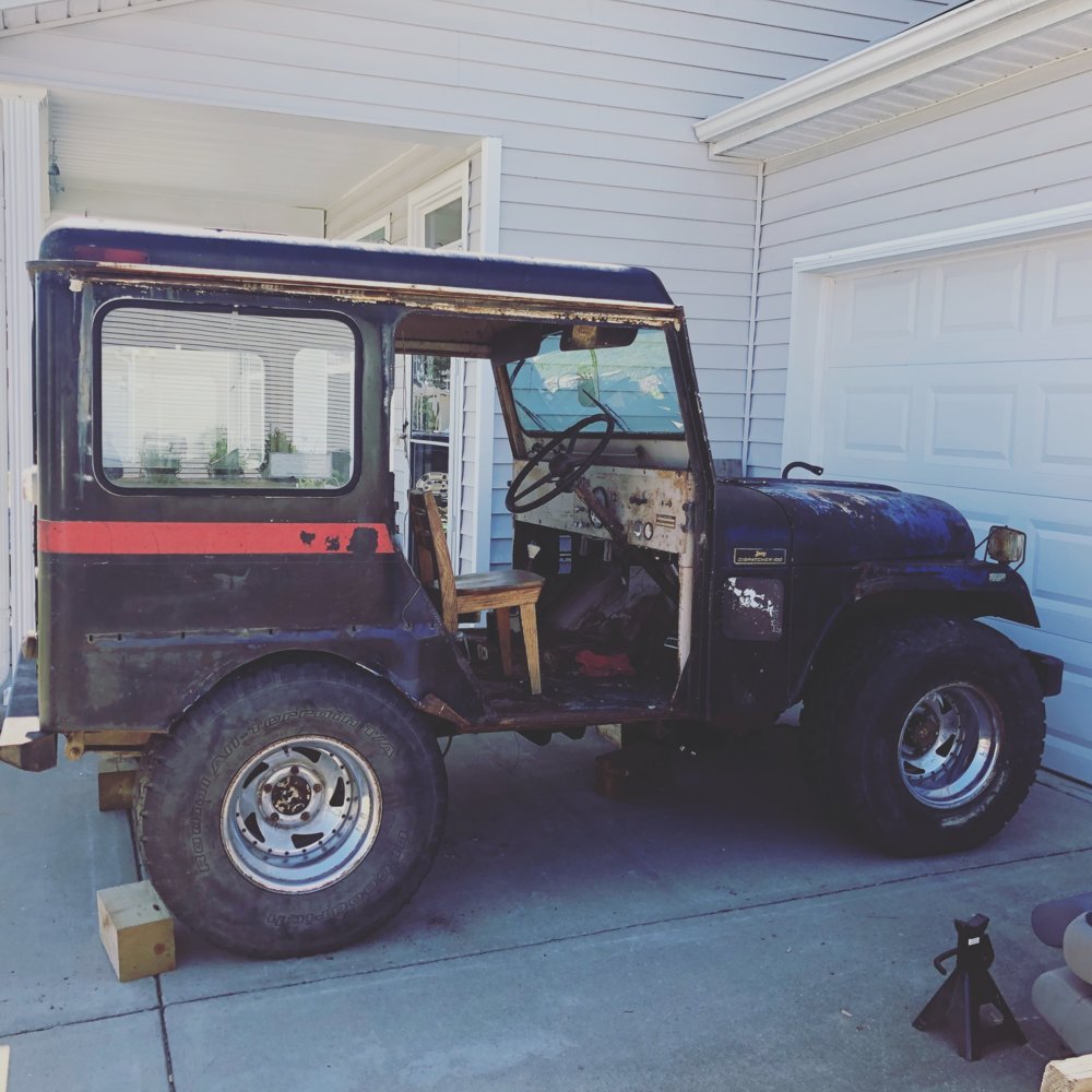

Oh... I got pissed off at the constantly deflating tires. I pretty quickly found a great deal on a set of 33x12.50r15’s. No, they didn’t fit. So, I rednecked them in until I cut the body clear this weekend. It did have the unintended effect of getting the wife (and my neighbors) to believe this could actually come out pretty cool.

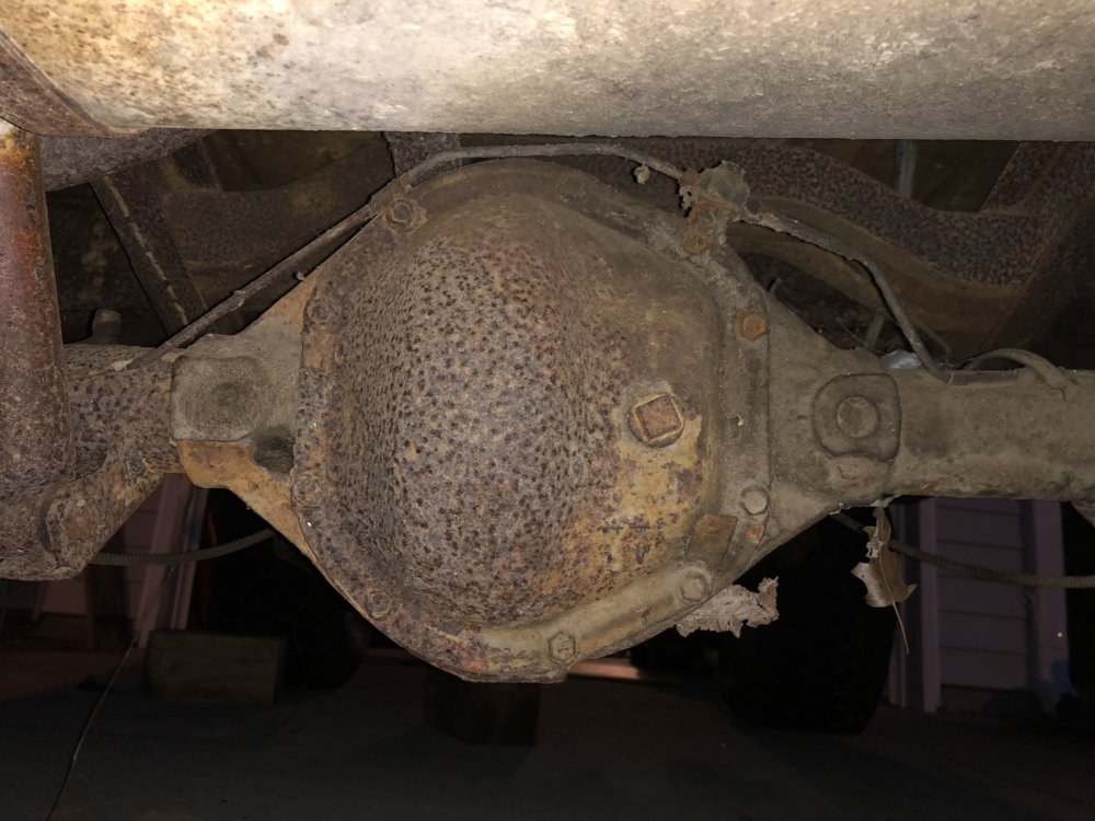

If someone has guidance for a front axle (yeah, I just asked that) I should put up front, I would appreciate the help. The rear is a D44 and (without actually measuring) 50" wheel mounting surface to wms. Hold on, I'm gonna hit a tangent real quick...

Pre-'86 Toyota minitruck and 4runner axles would be pretty narrow - around 55" front and rear. Early CJ stuff would be narrow as well. Mid 90's Isuzu Rodeos have a 6 on 5.5 rear dana 44 about 58" wide with discs. Matches up well with a waggy front 44.
If you want to swap axles (particularly the front), I would measure the front spring spacing. Then you can search the internet to see if CJ/Waggy axles or whatever are similar and will bolt in. If no popular swap axles have the same spring spacing, then the options are open because you are going to have to do a bunch of work to make one fit.

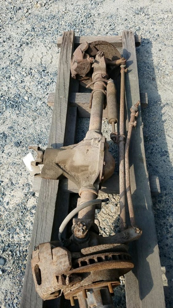

You are correct and, I agree with your assessment. Unfortunately, this is a budget build. What is fortunate is... I have found an axle!
I found a 78 CJ front axle! I have to pick it up this weekend. It's rusty as hell but, the folks who are selling it to me were kind enough to confirm everything moves freely and it is complete. It sounds like it may bolt up after its rebuilt as the spring perches are the same width. I'm hoping I can simply reverse the steering linkage setup, or the existing linkage will move to this axle... maybe that's crazy, I don't know! If it does work out the way I'm hoping, perhaps I'll have a cool axle to build a small trailer for it!

Looking at the pictures, you might look at going to a 4" spring, unless you are planning SOA. The new springs will net you a little lift over the old ones, but I think the 33s will still be fairly tight fit. Also, I believe you will be limited to the narrow axles, if you are hoping to put the doors back on and have them slide open.
